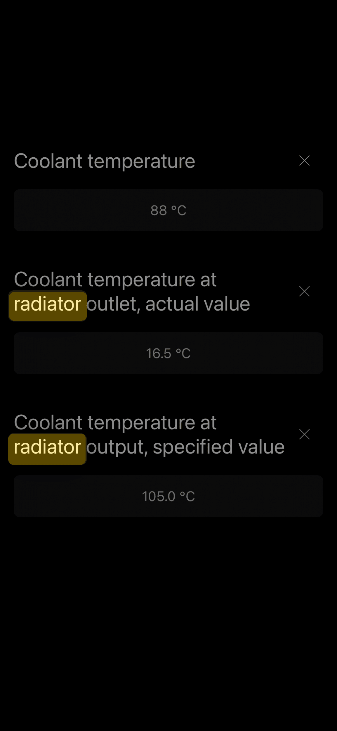

On another note
I’m now suspecting I may have a coolant flow issue, that’s been going on for a while.
That I forgot about and recently picked back up tracking.
no fault codes but noticed coolant temperature at radiator outlet never reaches anywhere near the specified value or other colant sensor temps
Reactions: Mr Pig

On another note
I track my mpg religiously, actually working it out for each tank, and my normal is about 46. I've got over 50 a few times and only three or four dropped below 40 to high 30s. You can't trust the car, you need to work it out. Fill the tank, reset the trip and when you come to fill the next time use the miles and liters you put in to work out the exact mpg you got out of that tank. It's very easy.
I don't know if a coolant would cause poor mpg but I imagine it could cause all sorts of issues. Have you checked your silicone bag? I removed them from our cars. I think the 1.5 is probably just as good as the 1.4 but it's being hobbled by the way it's being managed. Mechanically, it's probably just as good an engine. My daughter has one in an Ateca with an auto gearbox and it's fine.

On another note
This seems weird/wrong.
Coolant/temp issue could absolutely cause crap MPG.
I would check your temp sensors/wiring and check your thermostat.
Can you log your engine temp over a drive?
Reactions: Mr Pig
Will track it later today.
When you say engine temp do you mean coolant temperatures or another sensor readings should be looking at
From memory when driving when I’ve last looked at coolant temps using obd I’ve seen it in the 90s go up to 110.
Just the radiator outlet temp always looks way out of wack in comparison and maybe why I’ve not heard the fans in a long time.

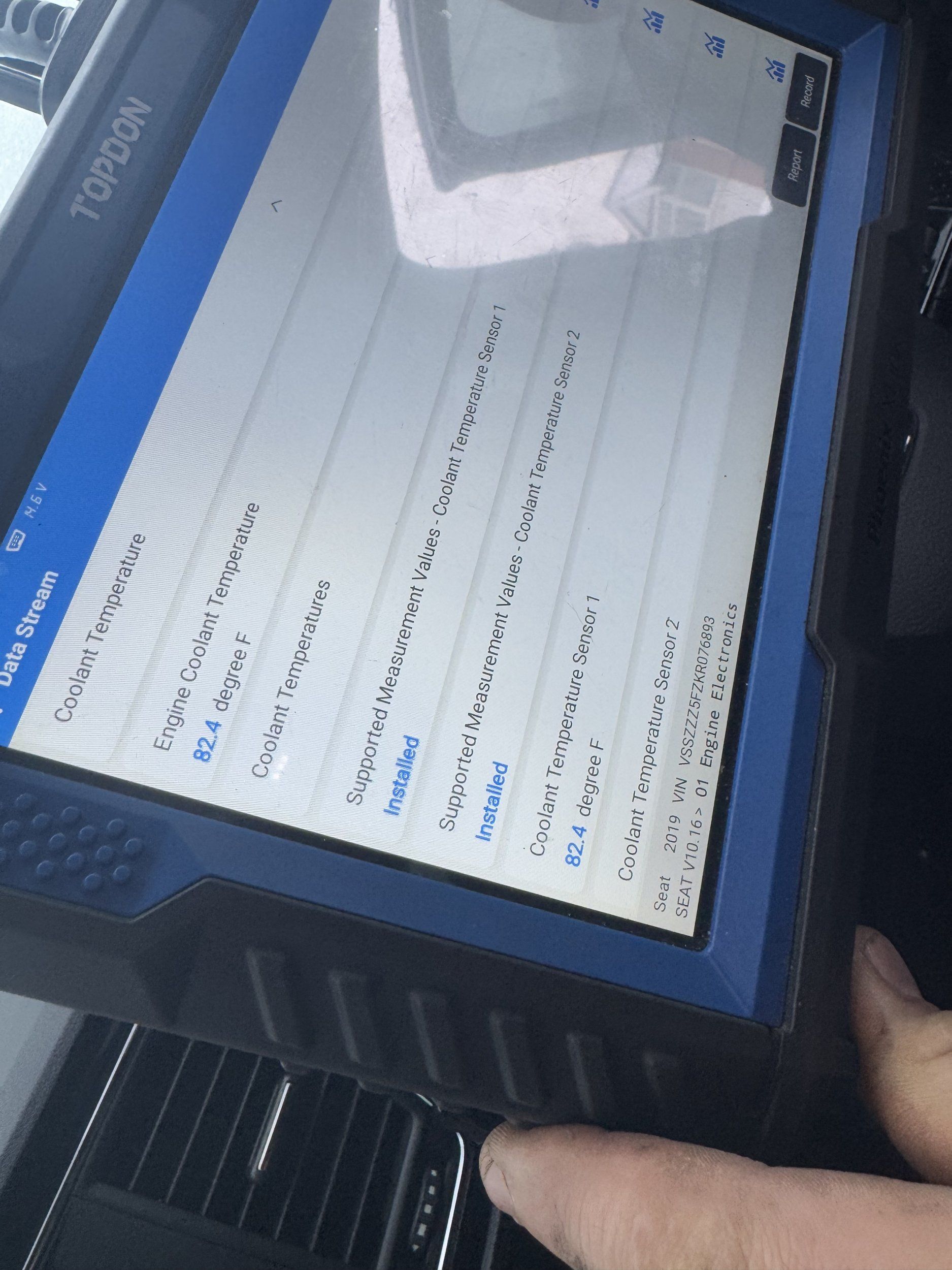

Funnily enough I had a mechanic out in January one of those mobile ones to see if they could shed any light on why fuels so poor.
It was a snowy day so outside temp was 2c. He plugged his diagnostic tool in and started the engine and within less than minute, coolant temps was showing at around 29c.
Which he said was suspicious and thought based on that one of the sensors could be giving false readings.
Would you agree with that being odd? I’d imagine the coolant temp would’ve been same as outside temp initially?

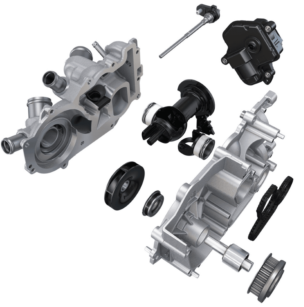

Is that the same as the 1.4? So much plastic.
I think the 1.4 uses 2x conventional (wax/mechanical) thermostats, but in a similar housing on the end of the head.
The 1.5 is using that stepper motor to rotate the drum to vary the coolant path depending on ECU demand.
