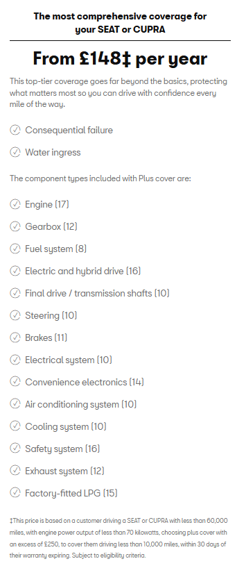

I had All in One Service + Warranty then due to car being over 6 years when it ran out November last year.
I couldnt get the all in one again, so just got the Extended Warranty Plus, which I believe is equivalent to the warranty cover I had with the all in on plan.
However its only valid until 60k miles, im at 52k ish - I dont believe the warranty under all in one had this restriction.

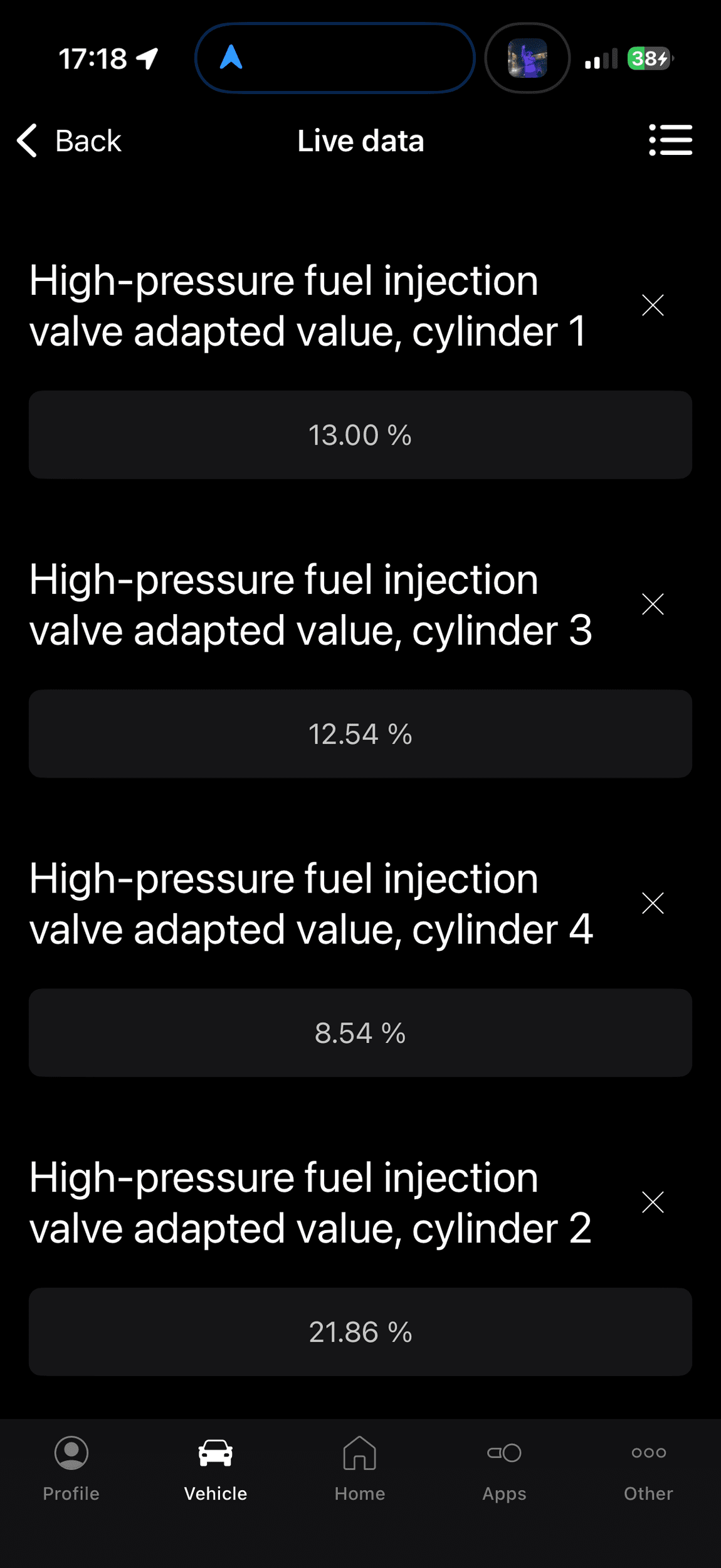

You'd need to go to a GDI fuel specialist, to put them on a test rig to check their spray pattern.
I would find one who specialises in the GDI system on your car? like Bosch, Conti, Delphi, Denso etc...
I don't know what values on your high pressure valve adapted value to expect - but they are all positive which is positive!
I would expect them to evaluate the root cause of your supposed engine failure (though with a tapping noise, high oil consumption, and scored bore i'm sure the engine has effectively failed)
Hopefully you get a new full engine, but in the event they just replace the short block - I would request /expect a full test of the fuel injectors.

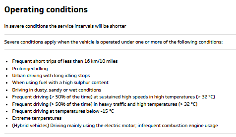

The trouble is - even a car with 'full dealer service history' doesn't mean the car has been well looked after!
All manufactures (not just VAG) have schedule guidance which should be read before selecting the suitable service schedule - which no one seems to know about or read!
It says for the operating conditions below - they are classed as 'severe use' and service intervals will be shorter, and I think we can agree most cars usage would fit into some of these categories!
