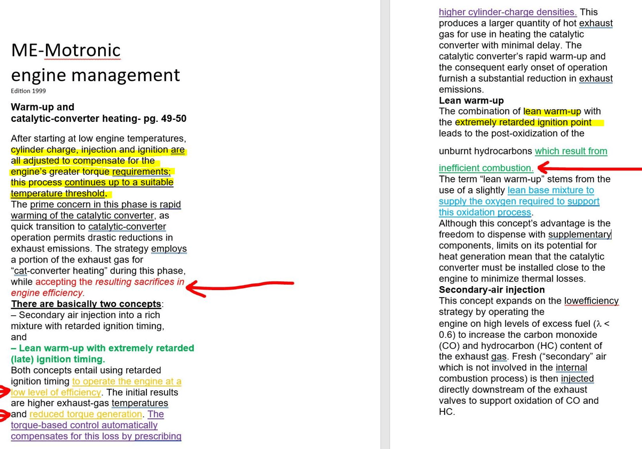

Please check the "Motronic engine management" edition 1999, page-49-50.
About engine warm-up and catalytic converter heating. There is the KANGAROO!
