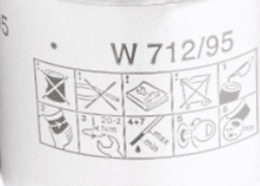

Is there a correct torque setting for the oil filter?
MANN-FILTER W 712/95 (the filter for the 1.4 & 1.5tsi) has 20-2Nm torque on their filter for what its worth.
