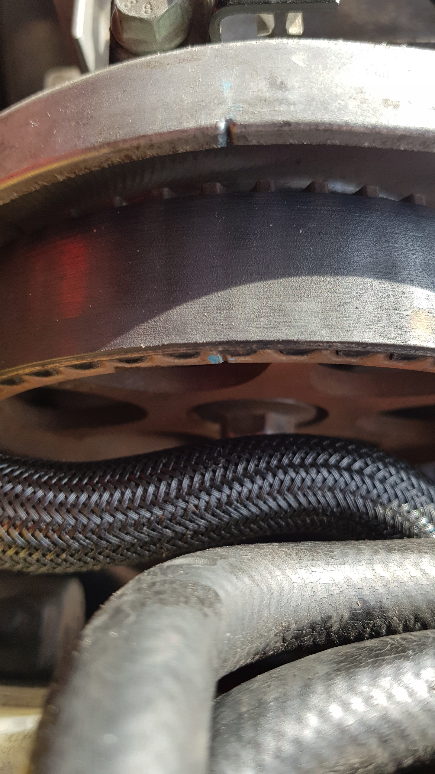

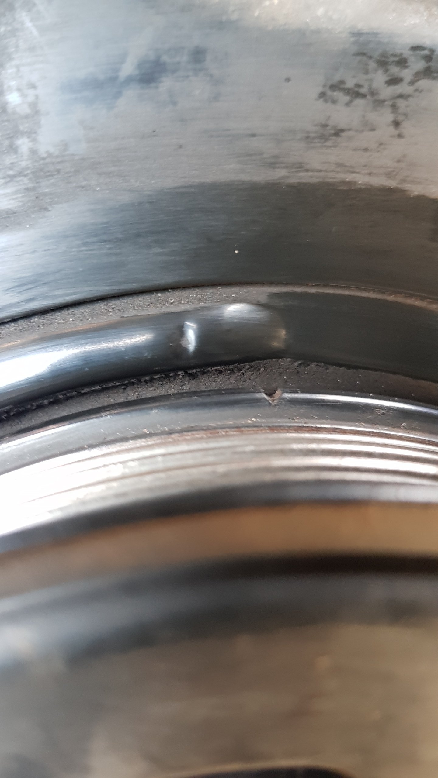

Got the car ready for a new belt today. I lined up the cam marks and the crank markings were off. After releasing the tension in the belt it basically allowed the marks to line up by gently moving the cam forward a tooth. I'm guessing the crank was pulled forward when I re tensioned the old belt back up. Atleast now I can see everything and do it properly with a new belt.

Here is a picture of the crank relative to the cam when the cam was lining up with the top marks.
