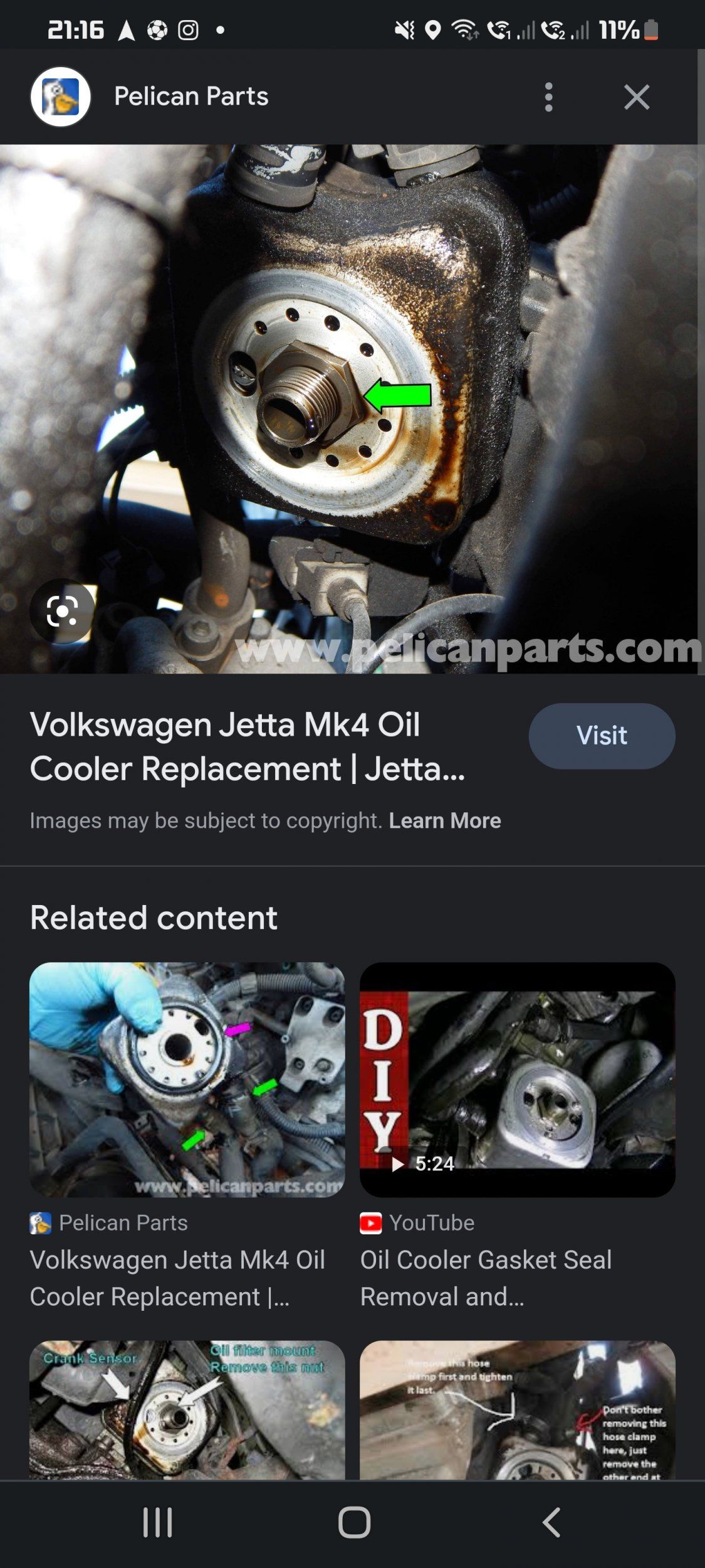

So where the arrow is loacted on this pic, is it normal for oil to drip from behind the nut? Doesnt seem normal to me however mine is doing that... just wondering if i damaged something taking filter off as the last person to do it ripped it up so f£%king tight
