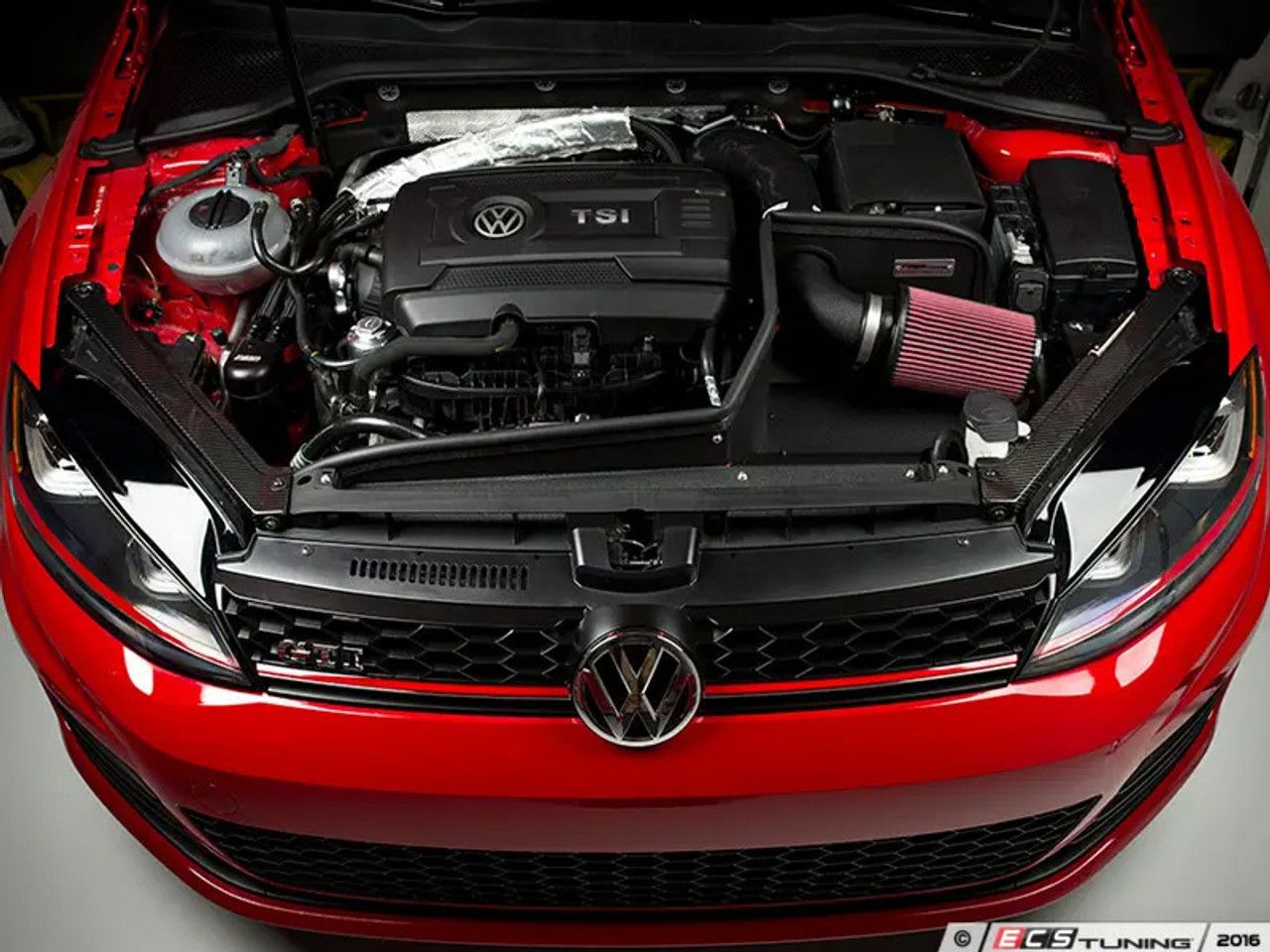

Thats the best in my opinion so if ur willing to buy the r600 buy that instead nit sure if it fits the leon tho looks like it should and it cheaper than the r600 my mate has that now on his 7.5 r the one that made 394bhp a few month ago at rtech

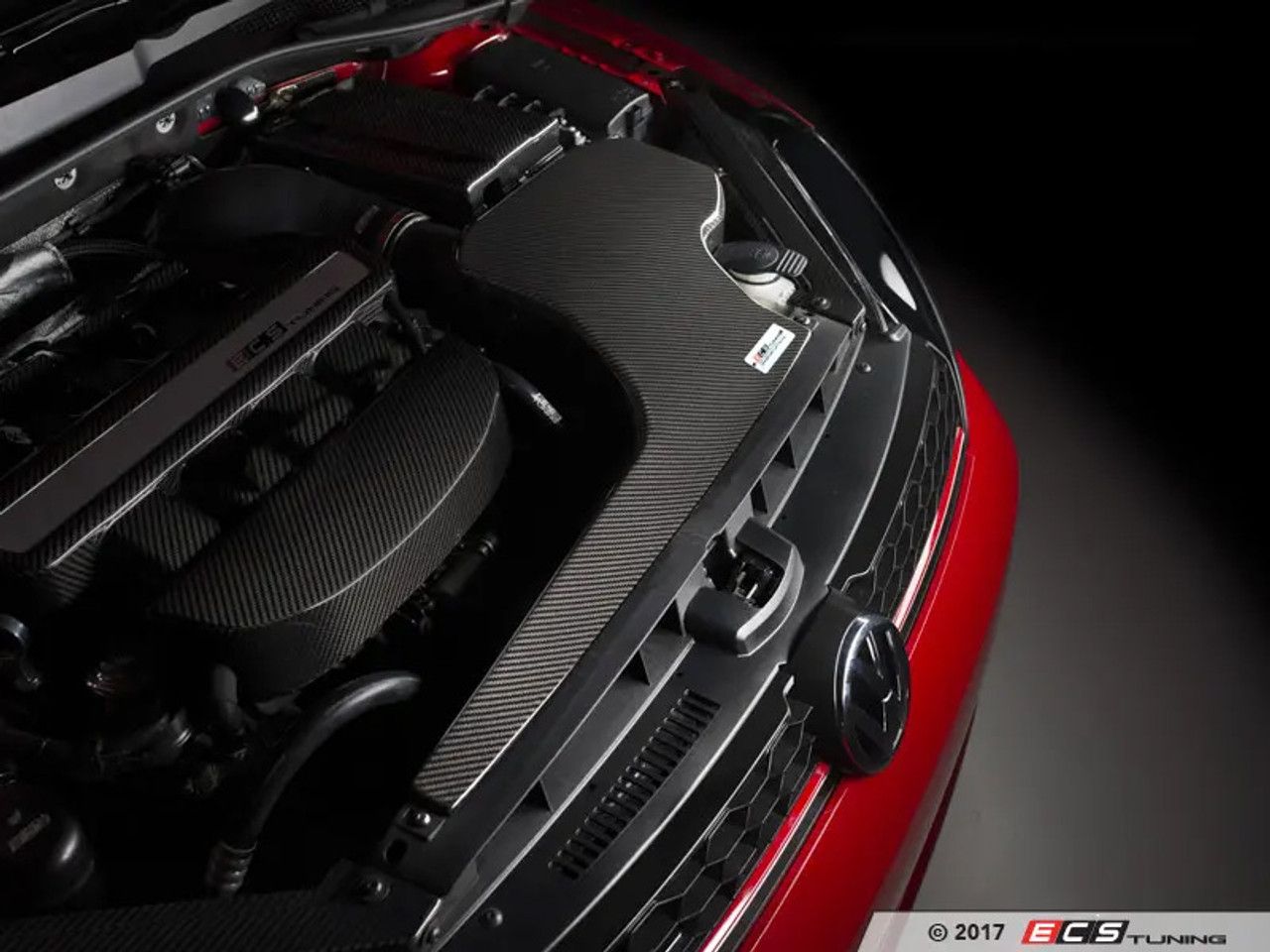

He has the open one was like 450 i think awesome gti stock them the closed design is the same just has a carbon lid put thats not cheap ?
Looks decent for that money the ecs one is 550 now my mate got his last year from awesome 450 so 100 increase in a year ??
