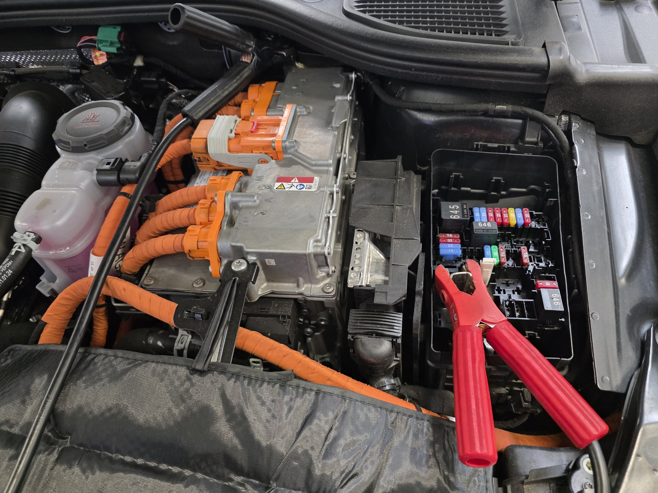

If the vehicle is a PHEV then you need to charge it through the engine bay points like in the picture I have attached.

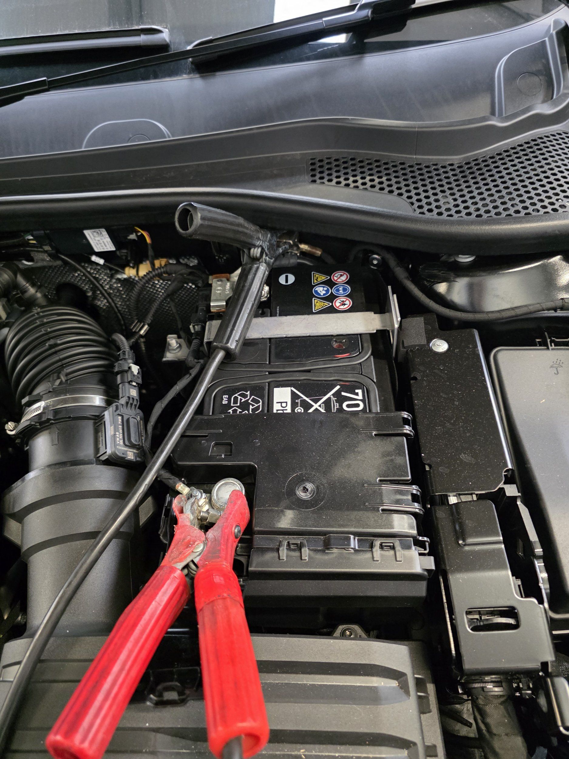

If it's a normal I.C.E engine then the live needs to go onto the battery positive terminal and the earth on the earth point on the bulkhead like in the picture attached.

Image of a non PHEV on charge.
