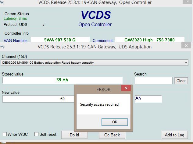

Hello, I replaced the original 12v Varta battery with an Exide battery. I have VCDS and I'm trying to change the values to code the new battery, but I'm getting an error. Can you help? Thank you.

Have no idea if this is just marketing rubbish but Carista are advertising they have now got SFD2 Customization working, however it looks like you have to buy the gear first to find out what it can do for your car.
If you were running a fully legal and up to date version of VCDS, and so were reg'd with them, you could ask them how you resolve this issue.
I'd be surprised if VW Group were forcing owners to have to get a battery change done at VW Group workshops only - but maybe nothing should surprise you!
The SFD2 Setup is different to SFD in that you have to get permission from VAG Servers to make changes, this also applies to BMW.
In time OBD11 AND Carista and such tools will be able to offer limited changes (I say limited because we dont yet know what will and wont be allowed). But if the garage you go to (and I am guessing Halfords as well) has tools that talk directly they can make changes
