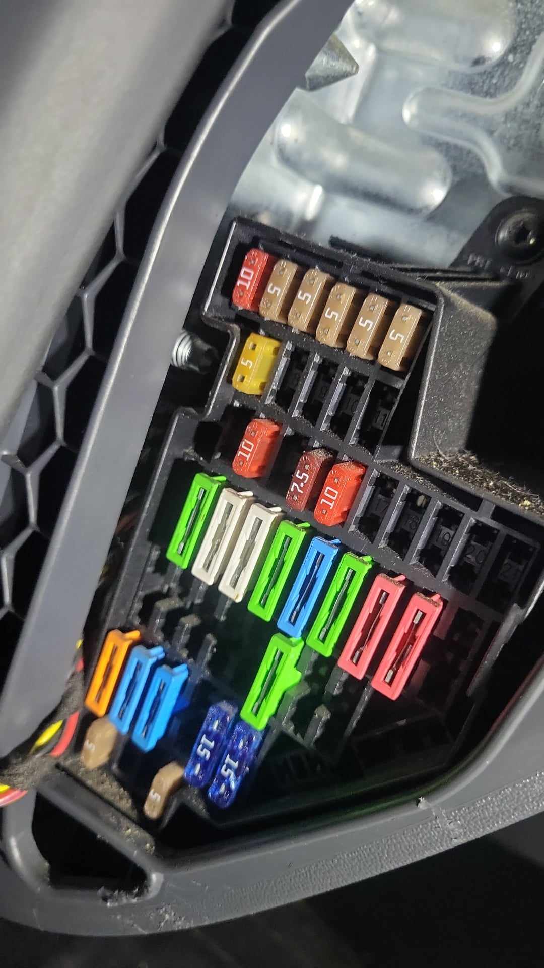

so i wanna convert my cigaret lighters from constant 12v to ignition 12 some say i have to moove a fuse but i dont know its a 2006 seat leon how do i do it?
I don't know about the 2006 one nut just find the fuse for the cigarette socket and remove the fuse and you should find there is three connectors where the fuse comes out of if the fuse was in the upper section then replace into the lower section and it will be Ign fed.
