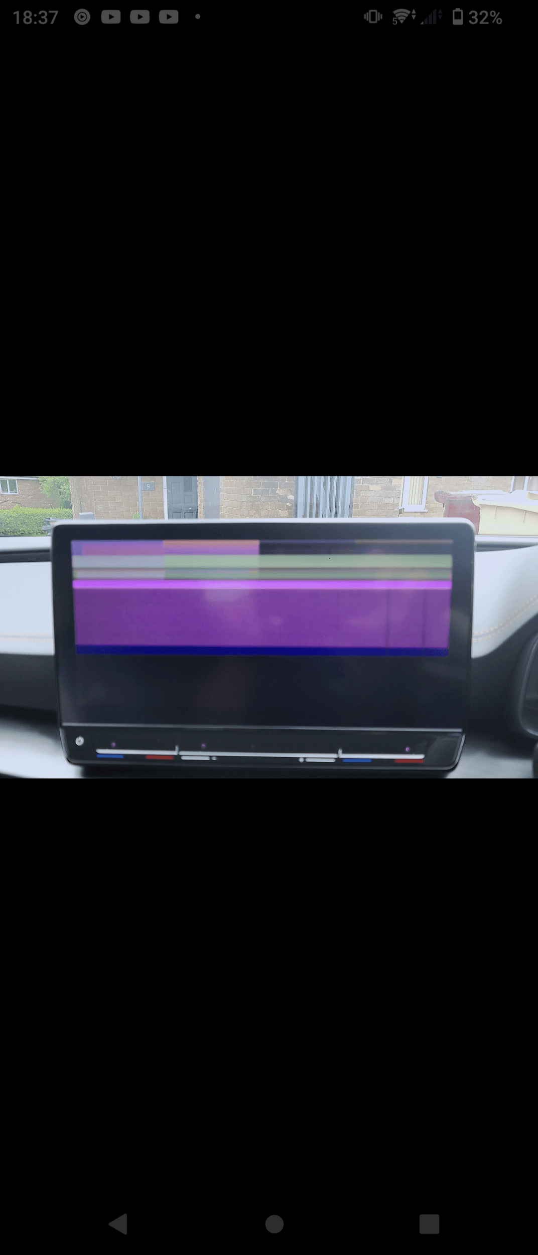

Please can someone help my software is on 1790, sos warning pop sound and now this happening, many thanks friends
Take it to the dealer, or is that an issue? I had mine updated under warranty last Thursday & it's cured a whole host of issues. Dropped it off at 08:30 & it was ready to collect at 13:00.
No issue taking it to a dealership, but earliest appointment is 6th if June till they can look at it,I m just curious if anyone had the same issue with the screen. Also if the software on the v2 should be on 1790, as mine is the 1.5 petrol
Engine size/trim is irrelevant. 1896 is currently the latest software release for the unit
The purple screen is normal for your current version
This is normal for this software version... Hence why it's now long outdated
I've found the dealers are just choc-a-block with these software issues. I booked mine in on April 10 & it went in on May 5! Mine's a V2 Hybrid and it seems so much better now I'm happy to say.
I'd get it booked in ASAP then if the OTA update becomes available you can always cancel. Good luck with it ?.
