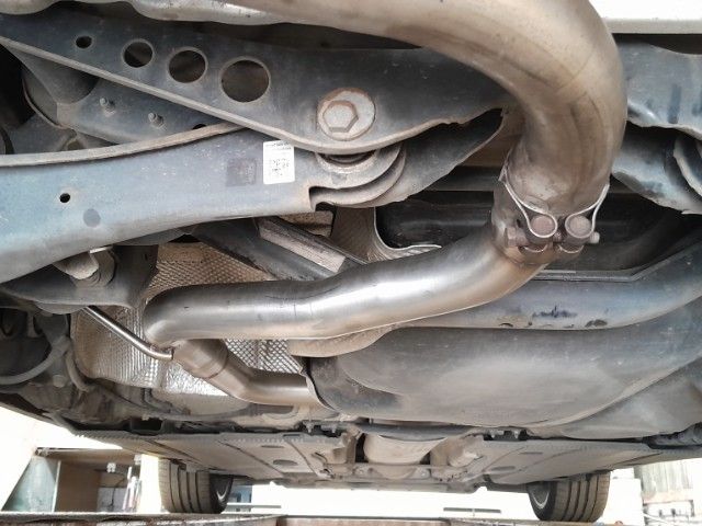

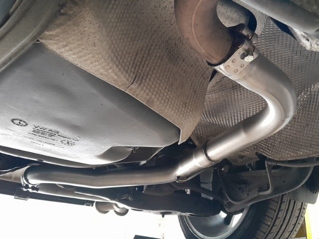

In reply to BlueLeonFR re exhaust mods I have removed backbox and next box so still have GPF and resonator fitted,car has deeper sound but still not loud but my god does it go a lot better without all those restrictions, I have Revo stage 1 and Revo airbox system with about 240+ BHP on 95 octane and it is amazing, still gets 50+mpg on motorway, hope this helps

Hi there everyone, just joined but looked at site since 2018,I have a 2019 FR Sport 190 DSG

Yes,still have car,I have tried to record video of exhaust sound but cannot hear anything on video, however, on idle it doesn't sound any louder than standard, slightly deeper.
Inside car when driving you can hear a deeper sound but not loud and no drone,with windows open(in summer,haha)it sounds good, it will never be loud with a GPF fitted but as I said on my post the car goes a hell of alot quicker, well worth the effort and money (about £200)

I would just do it,remove backbox and box next to fuel tank,leave GPF and resonater, you won't be disappointed, however it took a short while to get used to sound but I like it now,definitely deeper sound and you won't offend anyone unlike some exhaust systems
