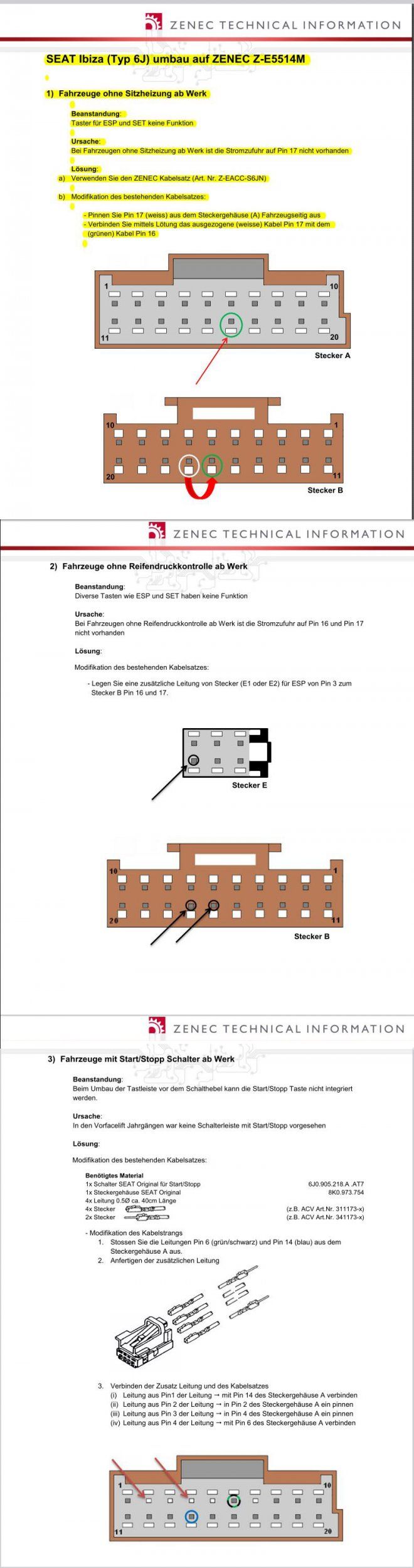

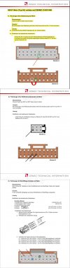

What good news. Let's see if we can all install an android screen, with a start/stop button included. I am attaching some photos of all the information I found a long time ago.
