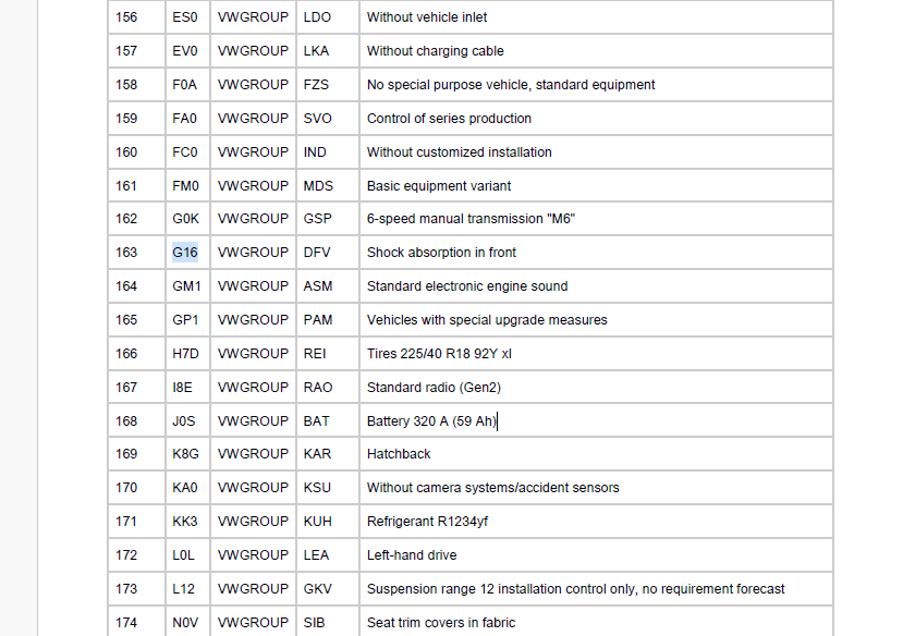

PR code is a general term for production codes.
They are three-letter codes, like the ones in second column in the attached screenshot.

@serdar_18fr :
This is interesting because I can see H7D in the maintenance programme and looking at the screenshot you sent, this means 225/40 R18 were fitted from the factory? In this case I wonder why the pressure values are lower on my fuel tank flap label ?
Anyway, in this case I think it's best to use the values on my label, which is 2.0 bar (29 PSI) for the front tyres and 1.8 bar (26 PSI) for the rear tyres. Which are lower than the values you and @SkiTTbicepS mentioned hmm...
On a side note, it says the model is 1.4 ACT so the engine has Active Cylinder Technology.

You have H7D, meaning it was fitted with 225/40R18s in the factory.
