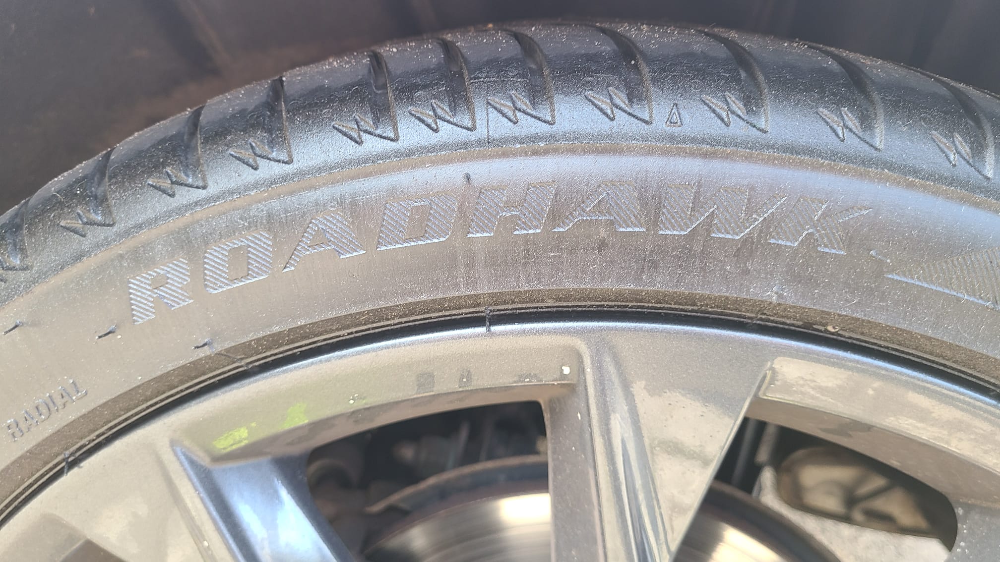

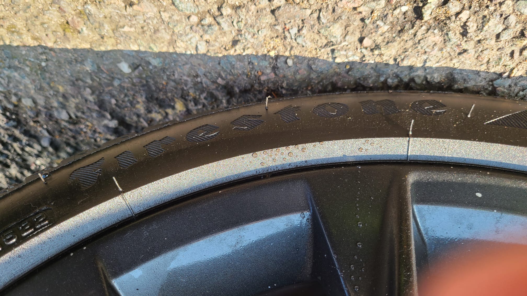

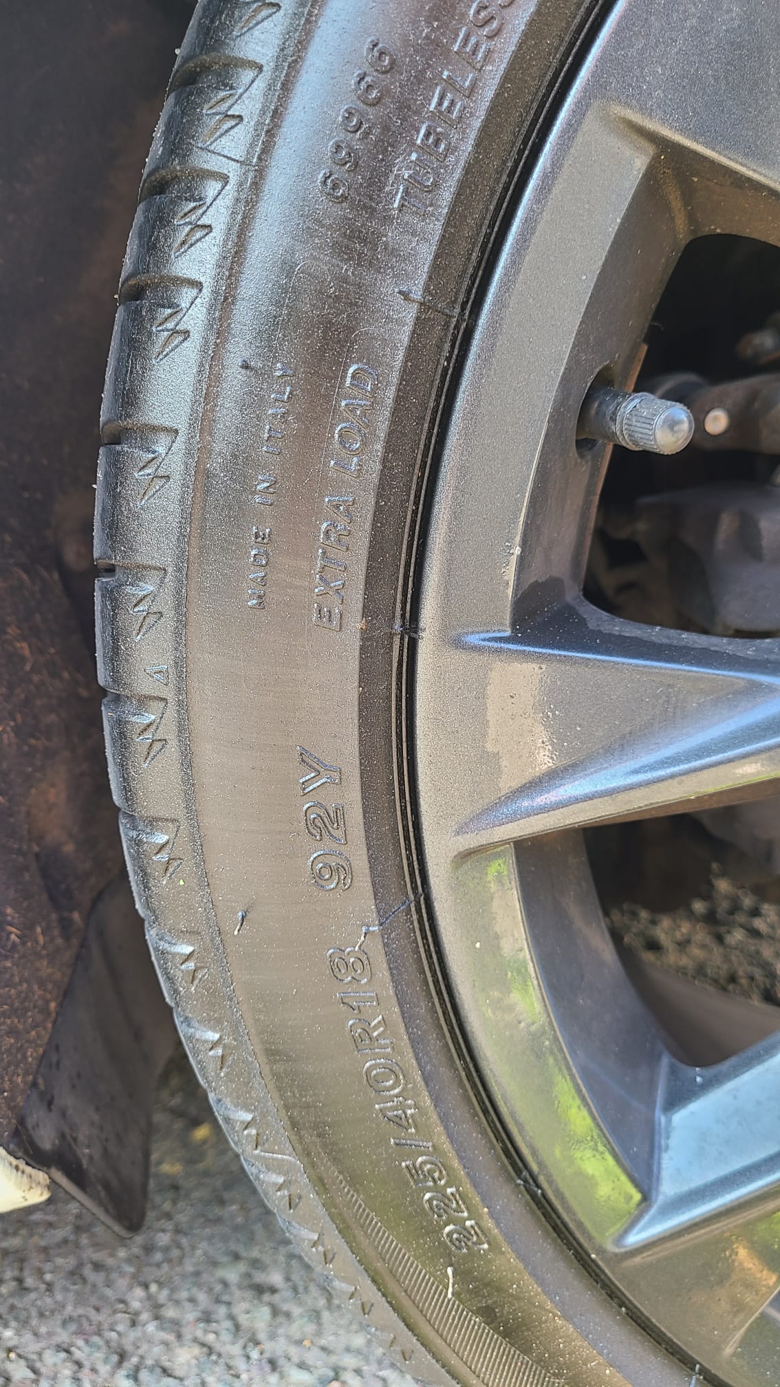

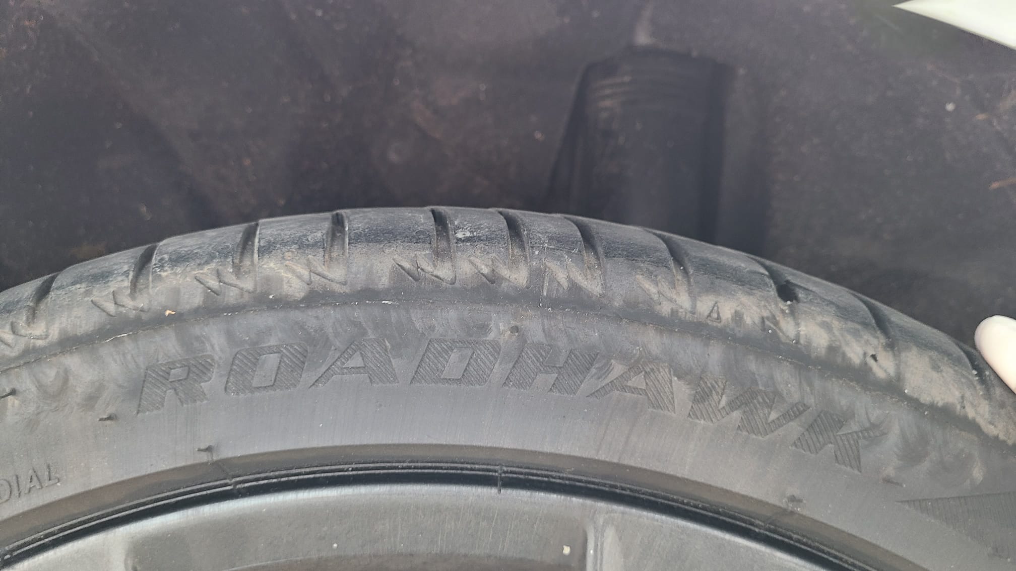

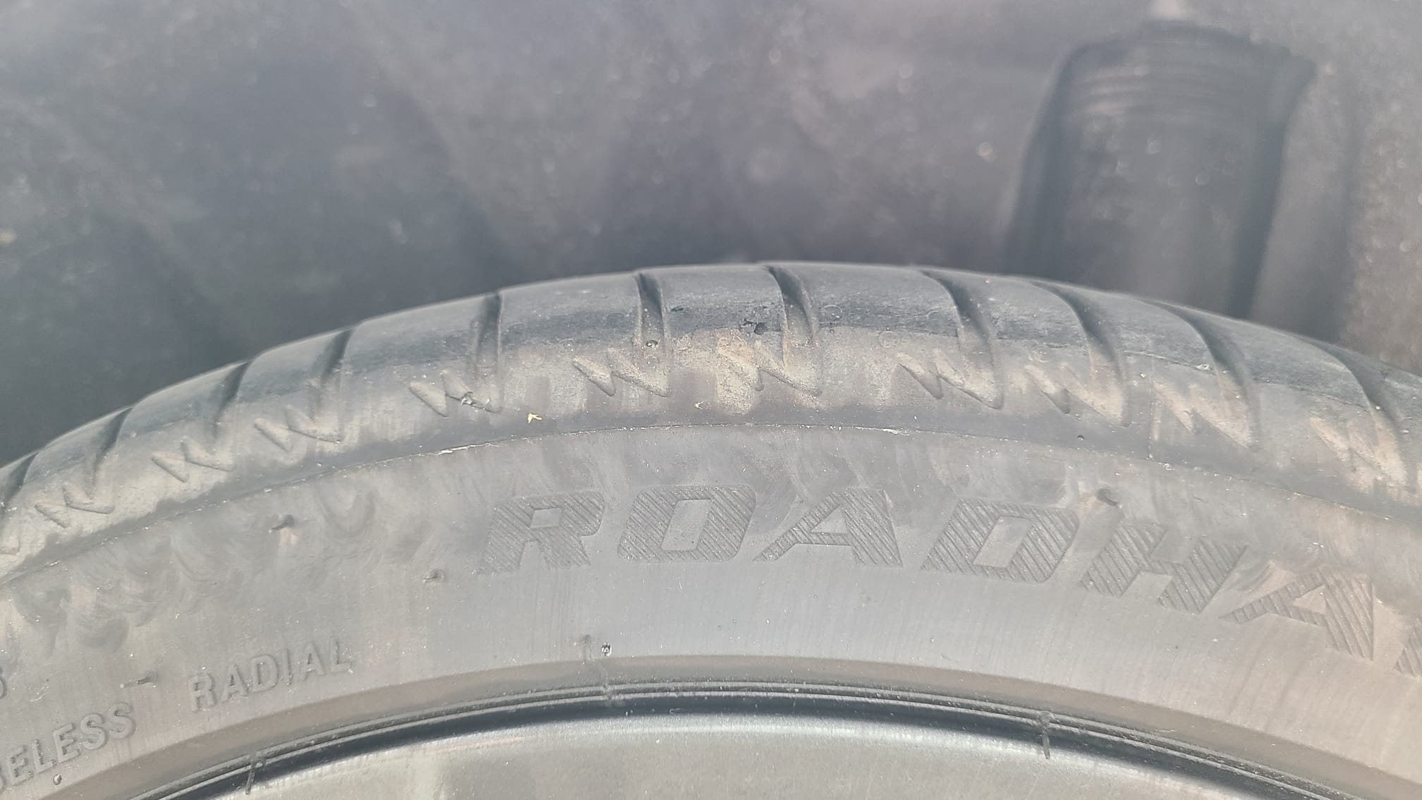

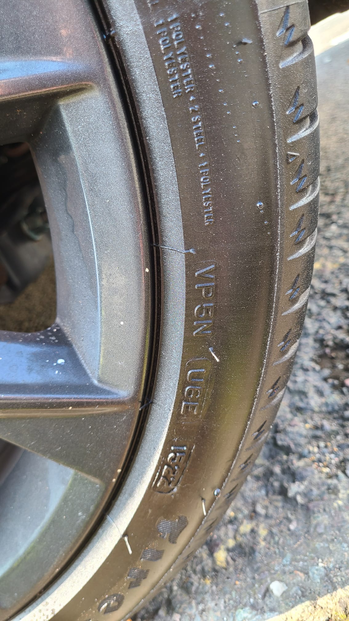

Hi everyone,
I recently purchased a MK 3 FR Sport 2.0 TSI with 18-inch alloy wheels and Firestone 225/40 R18 tires manufactured in 2022.
When driving on A roads or highways, my wife and I experience significant road noise that is quite unbearable. Even though I always drive within the legal speed limits, the noise is sharp and piercing.
This road noise is noticeably different and more pronounced compared to my previous vehicles like the Honda Jazz and VW Golf, which didn't have this issue. We measured the noise level to be around 85 decibels.
If the road noise issue cannot be improved, it will be difficult for us to use this car for daily commutes.
I have a few questions and would appreciate your insights and suggestions:
  1. Is road noise a common issue with SEAT LEON, or is it specific to my LEON?
  2. If I want to improve the road noise, would changing the tires or downsizing to 17-inch alloy wheels be more effective?
  3. Are the methods found online for soundproofing the cabin effective? I prefer not to dismantle door panels or carpets to avoid damaging the vehicle.
Thank you all for sharing your thoughts.

Leons are noisy, they don’t come with much sound deadening. I notice it when I’m in the wife’s merc, so much quieter. One thing to check first is tyre pressures and check that there’s even wear across all tyres as if the tracking is out that can cause more noise. I don’t have any any experience with firestones but I have Michelins on mine and they are loud, especially at motorway speeds. I believe it’s easy enough to remove the carpet and wheel arch lining (on the inside) to add more sound deadening. There’s a few thread on adding it to the boot, rear arches and rear seat bench which apparently helps a lot. It’s on my to do list. In the interim, I find most noise issues in the Leon can be fixed by turning the radio up ?
edit, I went from 17s to 18s, no obvious change in cabin noise. Wouldn’t bother downsizing if it were my car

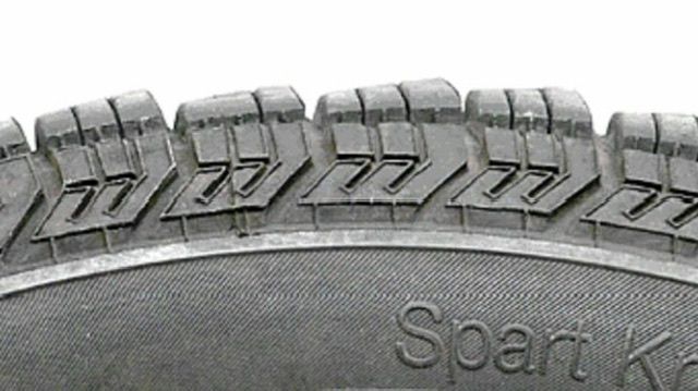

Also check the inner edge of the tyre treads on the rear tyres to see if they have worn in a stepped / sawtooth pattern (also known as cupping). If they have, then they will generate a droning noise similar to worn wheel bearings.
With sawtooth wear - if that is the cause of the excessive noise you’re experiencing - you’ll probably be able to feel it if you run your hand around the inner tyre tread. When it’s particularly bad, you can also see the ‘ steps’ in the tread, like in the picture below.

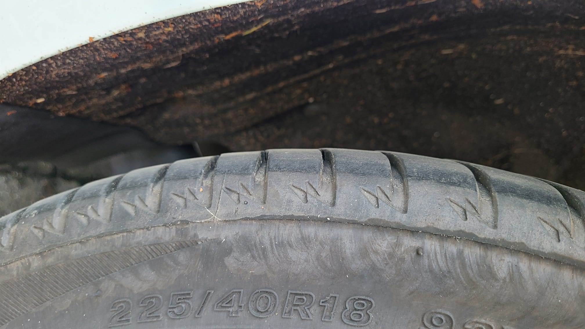

Update: After inspection, I noticed that the rear tires feel like they have a stepped pattern when touched, but the wear is not too severe. It's not easily noticeable by visual inspection, and I could only detect it by running my hand over the tires. The stepped wear appears to be more pronounced on the rear tires compared to the front ones.
While I'm not 100% sure if it's a stepped/sawtooth pattern or cupping issue, just in case, I plan to get a wheel alignment done when I replace the tires.
The MQB platform is known for the saw toothing on the rear tyres.
It is not caused by tracking.
It is more than likely the cause of your drone.
Do you know anyone local who would do a rear wheel swap with you for 20 mins or so to prove it before you get new tyres ?

I have a Mk3 FR TDI, I don't find it particularly noisy, but the sawtooth wear will produce a drone, I had that with my Mk2 Leon, and a wheel alignment and different tyres made all the difference.
Thanks, Mate.
So....after wheel alignment and new tyres, is that never happen again?
Toe in and improper inflation are the primary causes.
Lightly laden axles suffer more and tyre rotation to a different axle will minimise this effect.
Tread pattern can influence it, there's complicated reasons why this happen beyond my understanding
