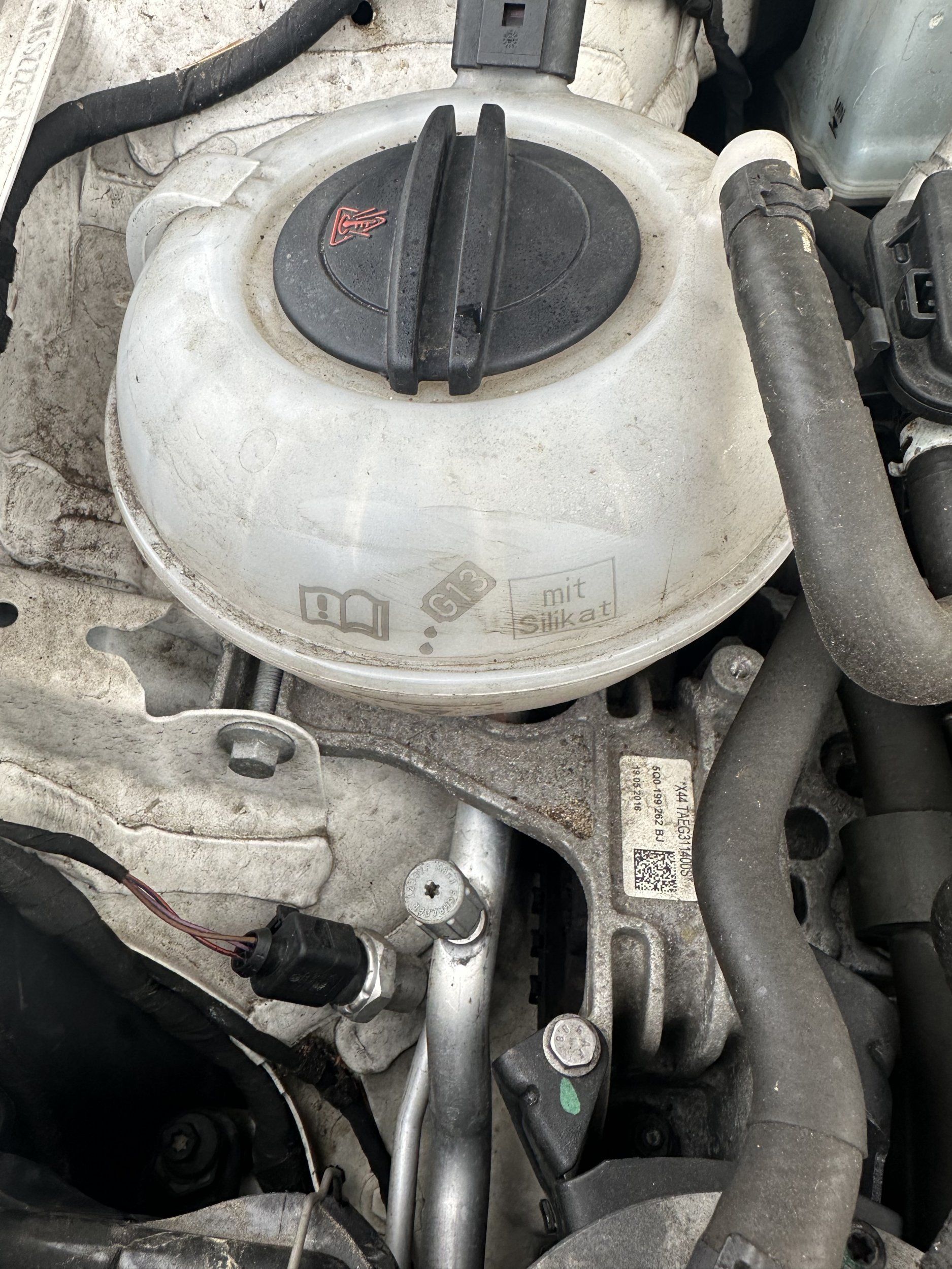

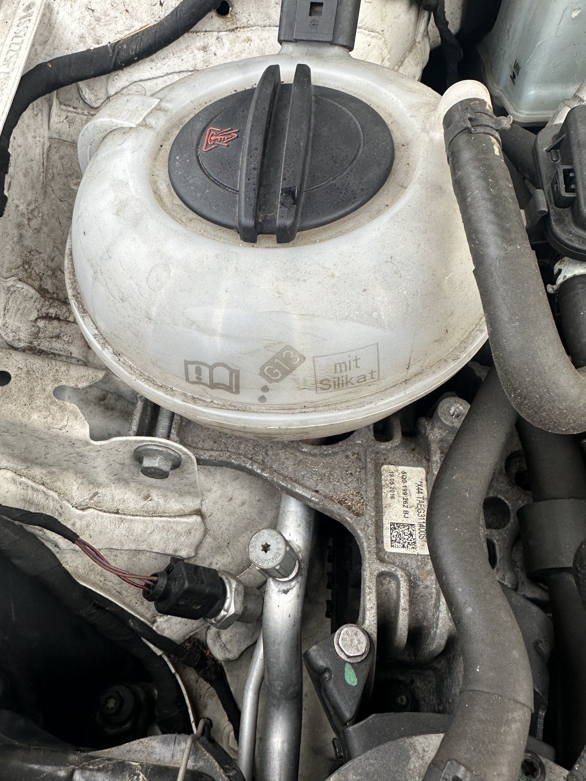

this little pain here? Means I do have the silicon bag of balls. Pain in the arse time then.
Welcome to the Heater Matrix Club.
You can get a matrix for about £90 and change it in under 2 hours of you're okay doing it yourself. About £25 to £35 for a new header tank `sans bag` and a coolant refil. You are meant to do a full system bleed etc but that's a specialist thing to get done. If you can drop the rad hose and dump most of your coolant you might be okay. That's what I did and mine has been fine for 3 years (touch wood).
