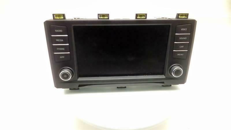

Sooo I bit the bullet and bought a used infotainment LCD display unit from the auction site at an OK price. And it works.
It's actually a very slightly different, and I think older model (button layout a bit different & has SOUND instead of NAV button - but you can access the NAV from the menu or voice commands anyway) - but it works perfectly well, with no coding/pairing required, works with Android Auto and anything I've tried. What a relief!

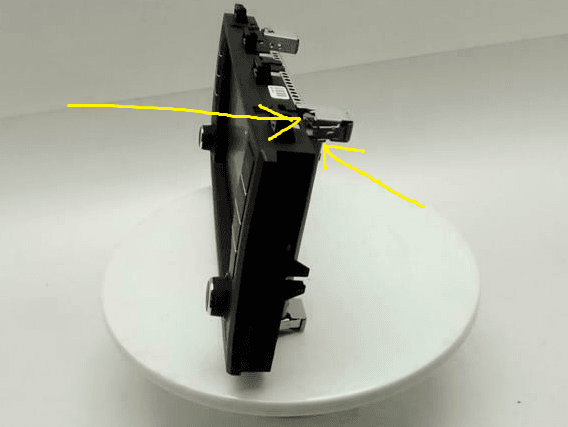

Fitting it was very straightforward - I just had to remove the bezel around the instrument cluster, then pop off the panel with the 2 air vents. Used a cheap plastic prying set I bought from Amazon.
Getting the unit out was easy and didn't require any specialist tools, there are 4 clips that you can just push in with a small flat head screwdriver or similar.
Possibly the swap of the nav for sound button may be due to that one being labelled up for the cheapskates units that didn't have navigation - the near bottom of the line. But your button press gives you sound, so a 1-1 mapping for the media《cheapskates》unit and you find navigation on the menu.

You will have that one. The 8" screen. The Media System Plus screen....
For reference the June 2016 Ateca launch price list which gives the options and where your screen fitted in. That one was on the Ateca SE. First Edition and Xcellence got navigation with the button ?. Must be the pin out on the unit allows you to match it to the mib2 unit in the glove box. Menu gets matched to menu etc.
