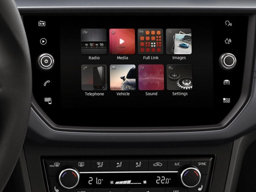

Just to make sure that I'm not making wrong assumptions ......do you have this kind of infotainement display?
Jul 14, 2021
8
Preston

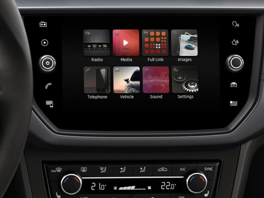

This is the same unit the media plus pack,
I know the screen isn't the sender for the sound so the way the optisound works is its switched on when needed and when you set it up you set everything to 0db because the Vibe 4 channel amp is doing the work and is plugged in between the MMI amp and the cars loom so the amp flows 1 way which is out to the speakers not back into the MMI amplifier so By all rights if I Splice the 2 frequencies together and then splice them into the vibe amps fR+/- and F/L +/- channel this will amplify the same channel it was amplifying in the first place (tweeters which aren't installed as I removed) and it will amplify the full frequency for the door speakers which are being missed due to the quadlock setup a i'm not splicing the loom I'm splicing the T-harness and it doesn't require me to adapt any software worst it will do Is blow thebvibe amps fuse no damage will be done to the actual cars MMI

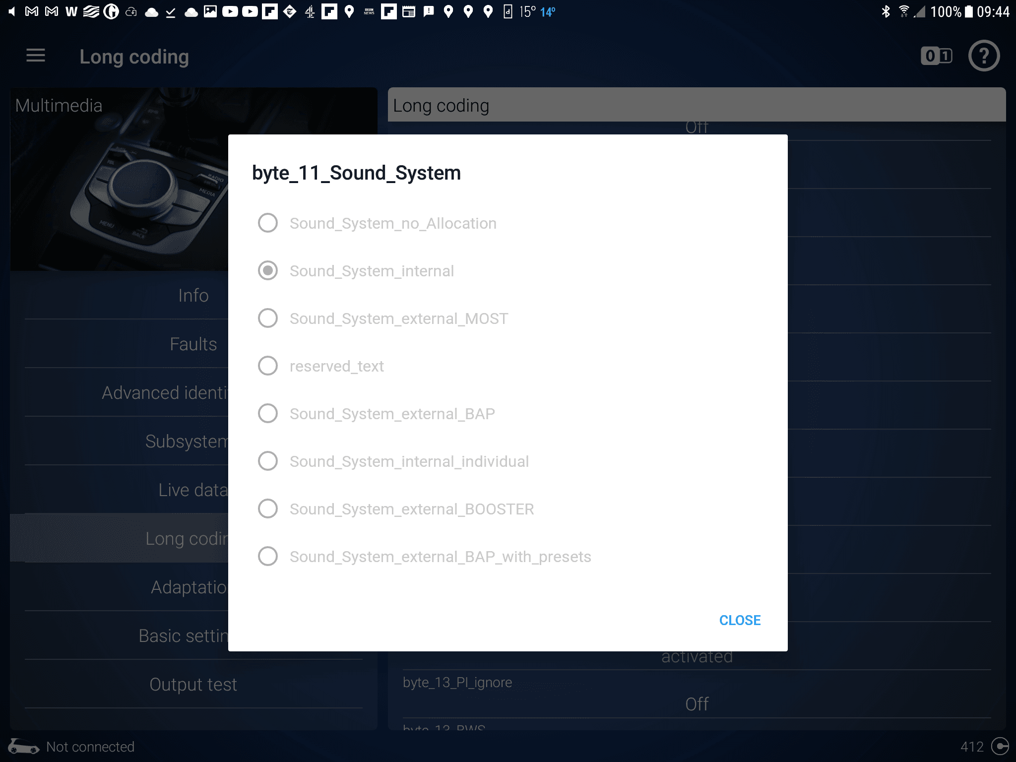

In order to get line level outputs from the MMI (for the Beats audio amplifier for an example) there is a need to use VCDS to reprogram the MMI....the same as it was with the VW cars and the Dynaudio package.
