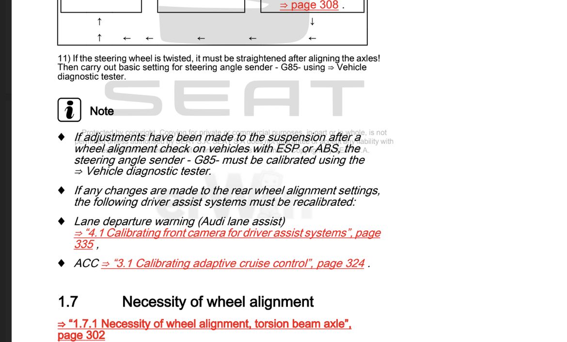

@Mike_2626
One for you to check - was a 4 wheel alignment and/or front assist/ACC sensor recalibrated post damper/top mount replacement.
The sensor needs to be recalibrated if the rear suspension is altered.
@Mike_2626
Ah, I wasn't aware of that. I never got told anything regarding that like - just that the work was done and here's the paperwork. It was done at a Seat dealership (warranty repair) so I'd like to say yes but I shouldn't just assume so, I guess.
I'm actually waiting on a call back from them so I'll bring that up with them when they do.
Thank you
Some ammo. More post replacement of top mount.
