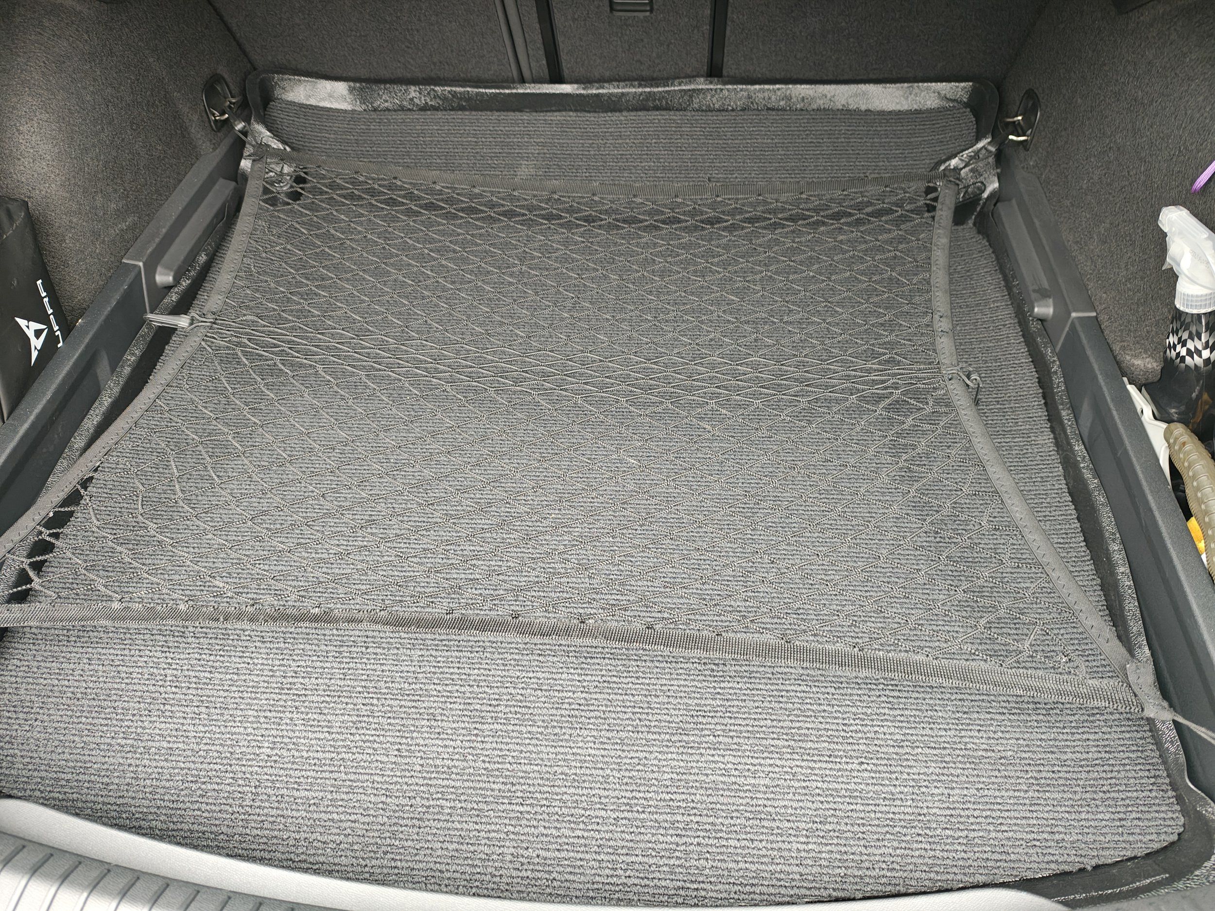

Its a 74 plate, one owner (Cupra) with 2,330 miles with same VZ2 spec and Pano roof. So same spec and colour as my old 73 plate. Interior looks nicer and there are some subtle updates which will be nice (like a phone charger). Forgot to lift the boot floor and check though, had a lot on my mind and I have been a bit cloudy and forgetful over the last week if I am honest.
I watched some Youtube videos yesterday and it appears there is still a well for the spare, so that is fine.

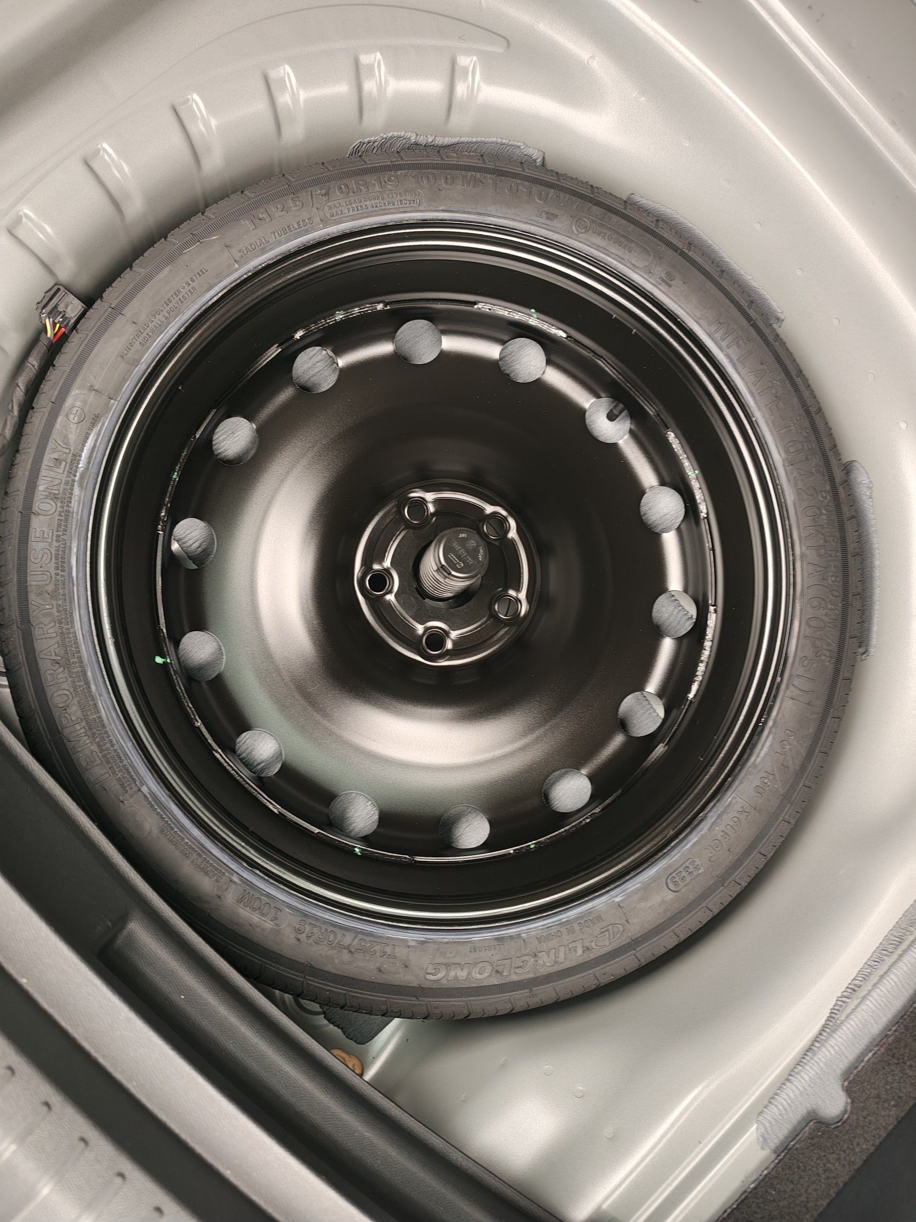

I have the car now and have put the spare in there and the pump and gunk sits on top. I have a jack and such also, so it has all worked out in the end. Mine is a VZ2 so no sub etc.

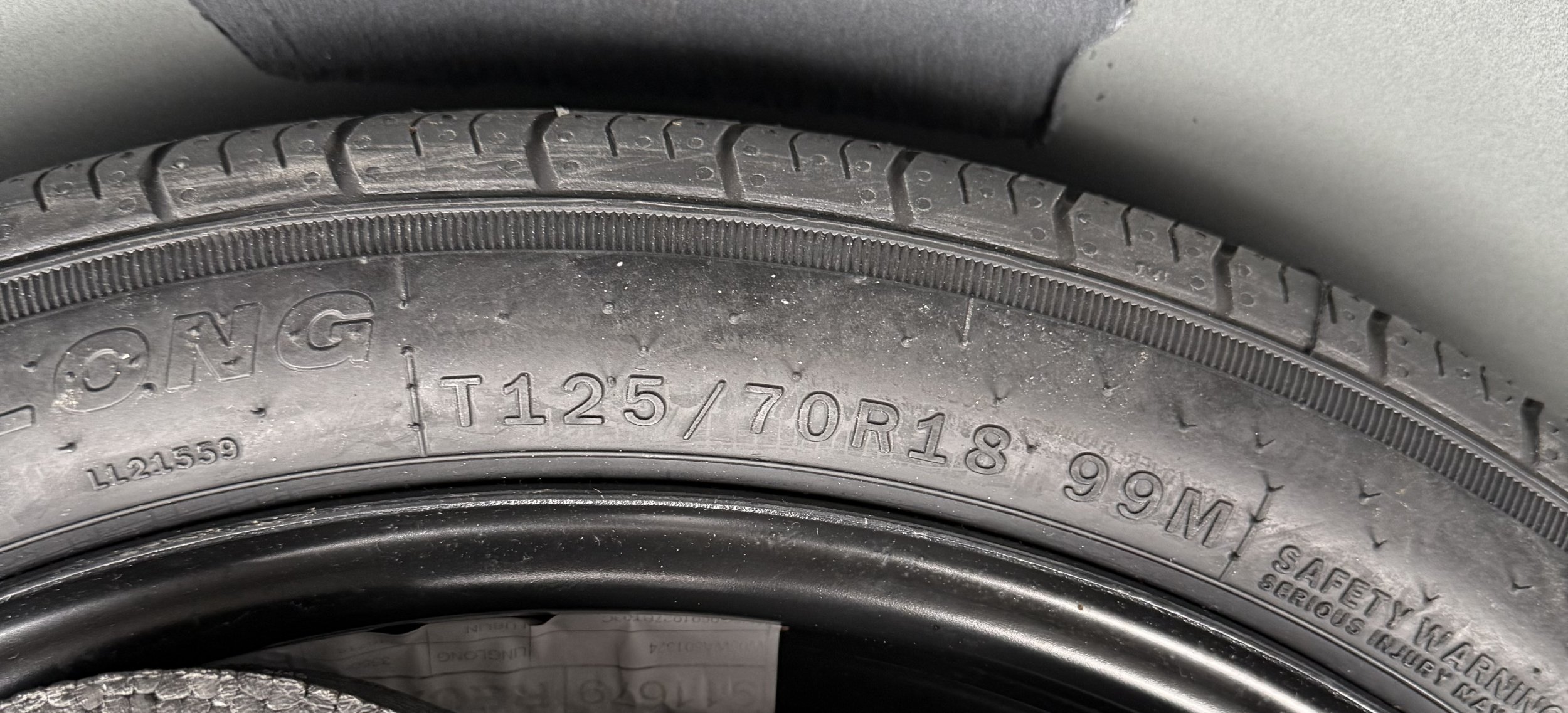

out of interest what width and profile is your spare? when I look at the depth of the well it seems deeper than the average space saver, but not as deep as a full size wheel by a long way - so was always intended for the space saver - which is doubly annoying that the car doesn't come with one. ho hum

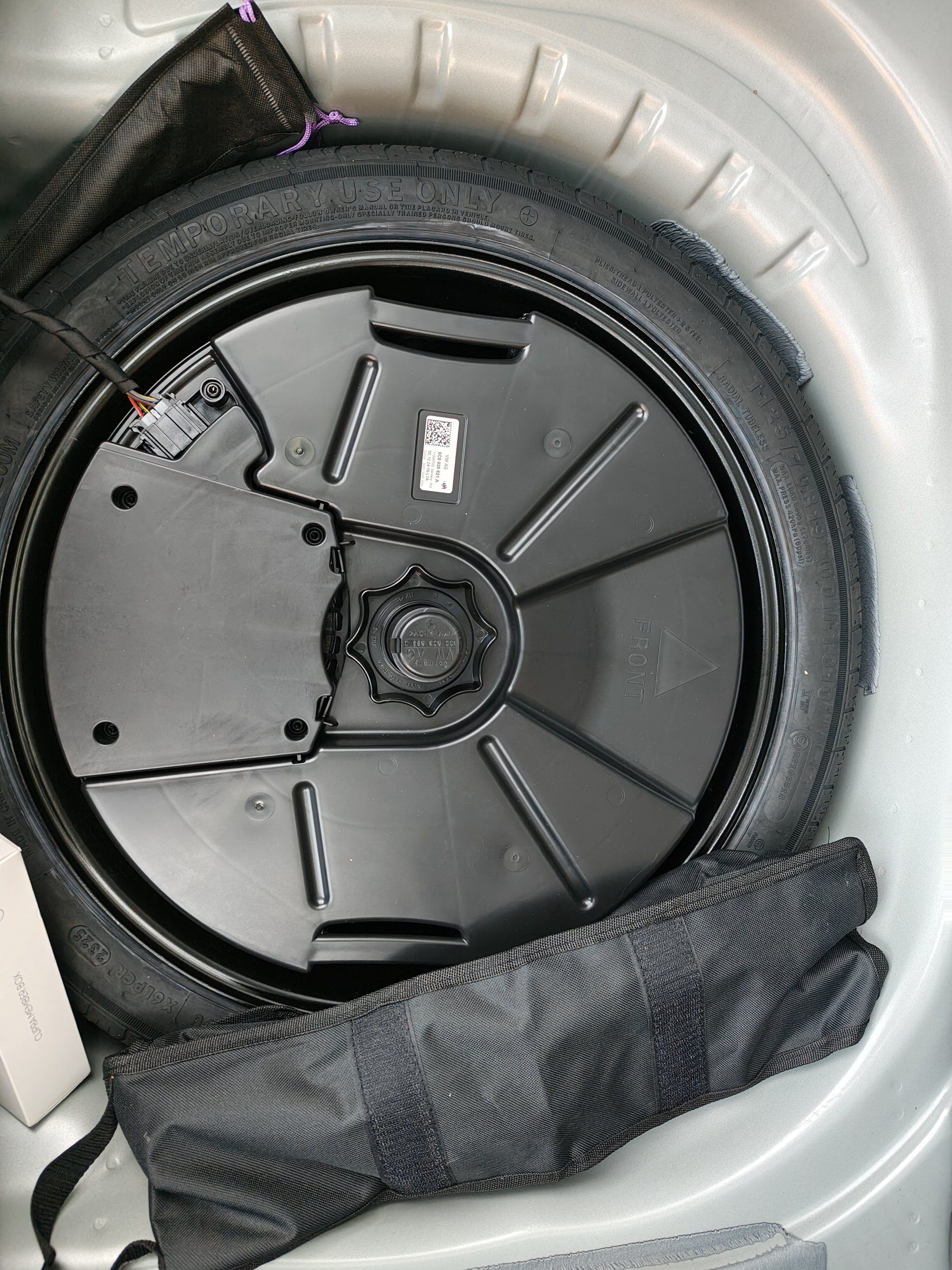

Hope this helps.
sorry I’ve been manic at work and had the worst case of man flu ever lol.
this was the spare that came as standard with the previous VZ2 310 bhp estate I had.
Reactions: pwebb
thanks for posting space saver pic, I am thinking 125/70R18 = 24.9" diameter and 4.9" width and therefore a close enough match for the 235/35/R19 OEM tyres which equates to 25.5" (9.3 " width) although 135/70R18 would be much closer at 25.4" I am going to see some folks in Manchester about a custom spare as I also want to check the spare wheel will actually clear the brake calipers ok, as well as fitting in the spare wheel well - more soon
No idea. It's the wheel that was from the previous 310 estate I had. I just assumed it would fit this car also, unless the disks are significantly larger (again no idea).

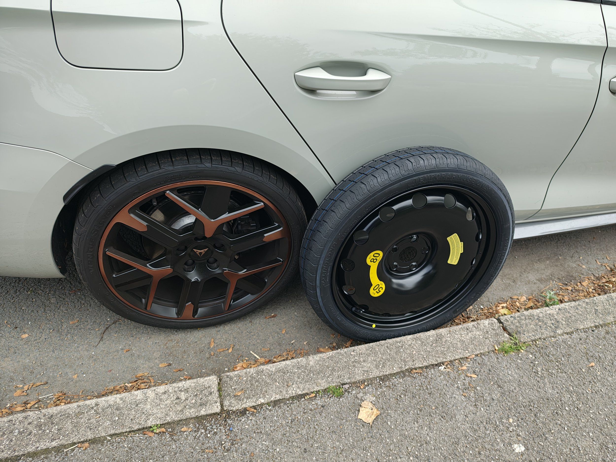

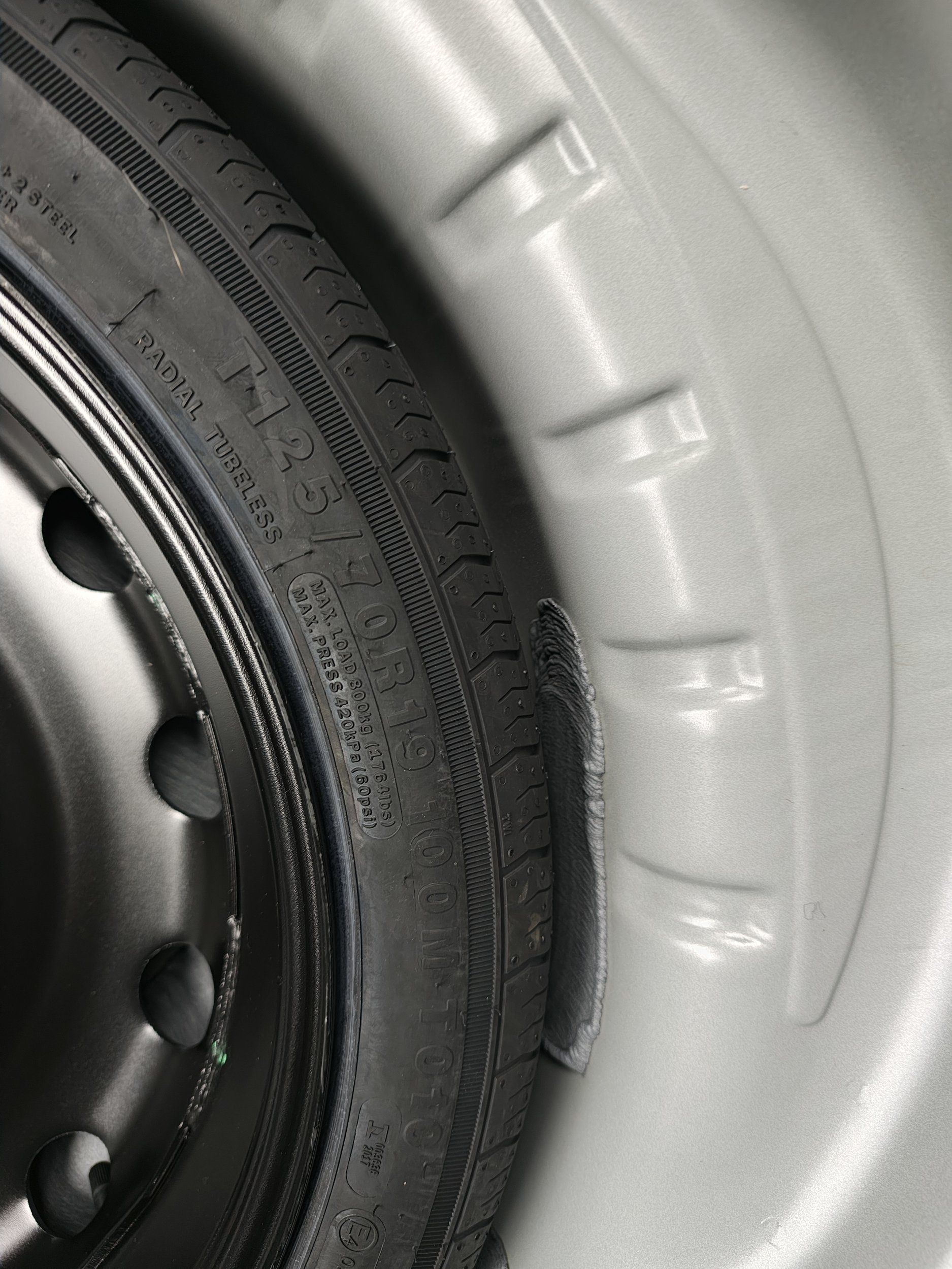

some progress:
I sourced a 19" space saver with 125/70/R19 tyre fitted - this has diameter of 25.9" (versus 24.9" for the above) and fits very snugly in the wheel well.
It is a closer match circumference wise (+1.6% as opposed to -2.25% for a 125x70x18) and I am hoping the added wheel diameter will better clear the brake calipers - and so maybe possible to fit front as well as rear.
here pictured next to rear wheel with much smaller disc and calipers than the 6 pots fronts

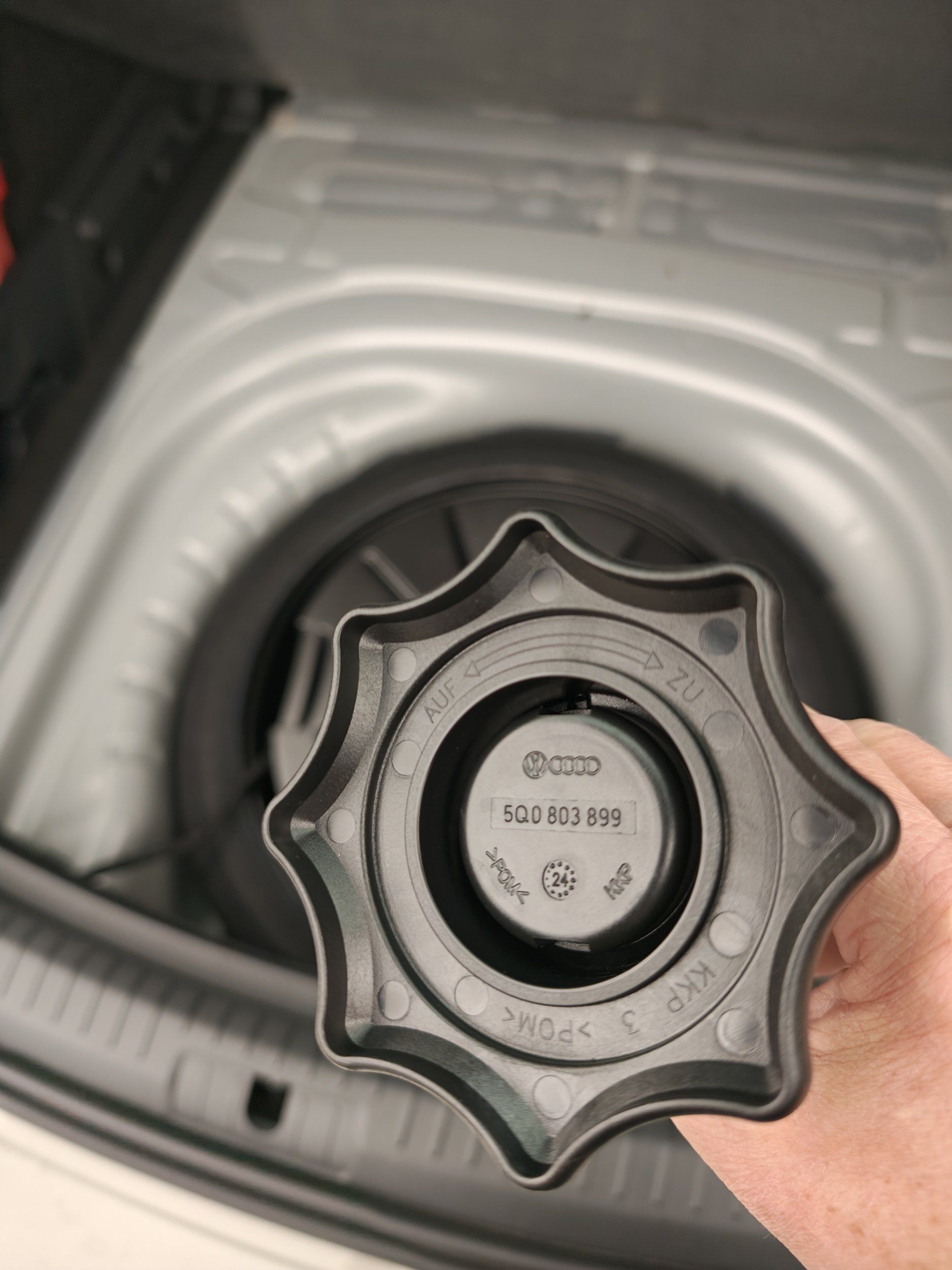

the only issue I now have is the centre plastic threaded screw that holds the sub down is not long enough and so I am hoping there is a VAG part with a longer shaft - to hold the sub woofer down securely.
I will update the thread with the new part number when I find one - above is the original which is 127mm version and about 10mm too short ;-) I will try to source the longer 184mm 3G0 803 899 D
in the meantime I have managed to get a new wheel brace, 3 ton scissor jack and toolkit alongside the spare under the boot floor in the LOWER position so I am happy that everything fits tidily away ( although there is no space for the load area blind to fit under the floor so that will have to stay in the boot area if I am carrying multiple bicycles etc.
I hope the above may help someone else, its a crying shame there is no OEM spare, jack and wheel brace in a £55k car - but hey ho

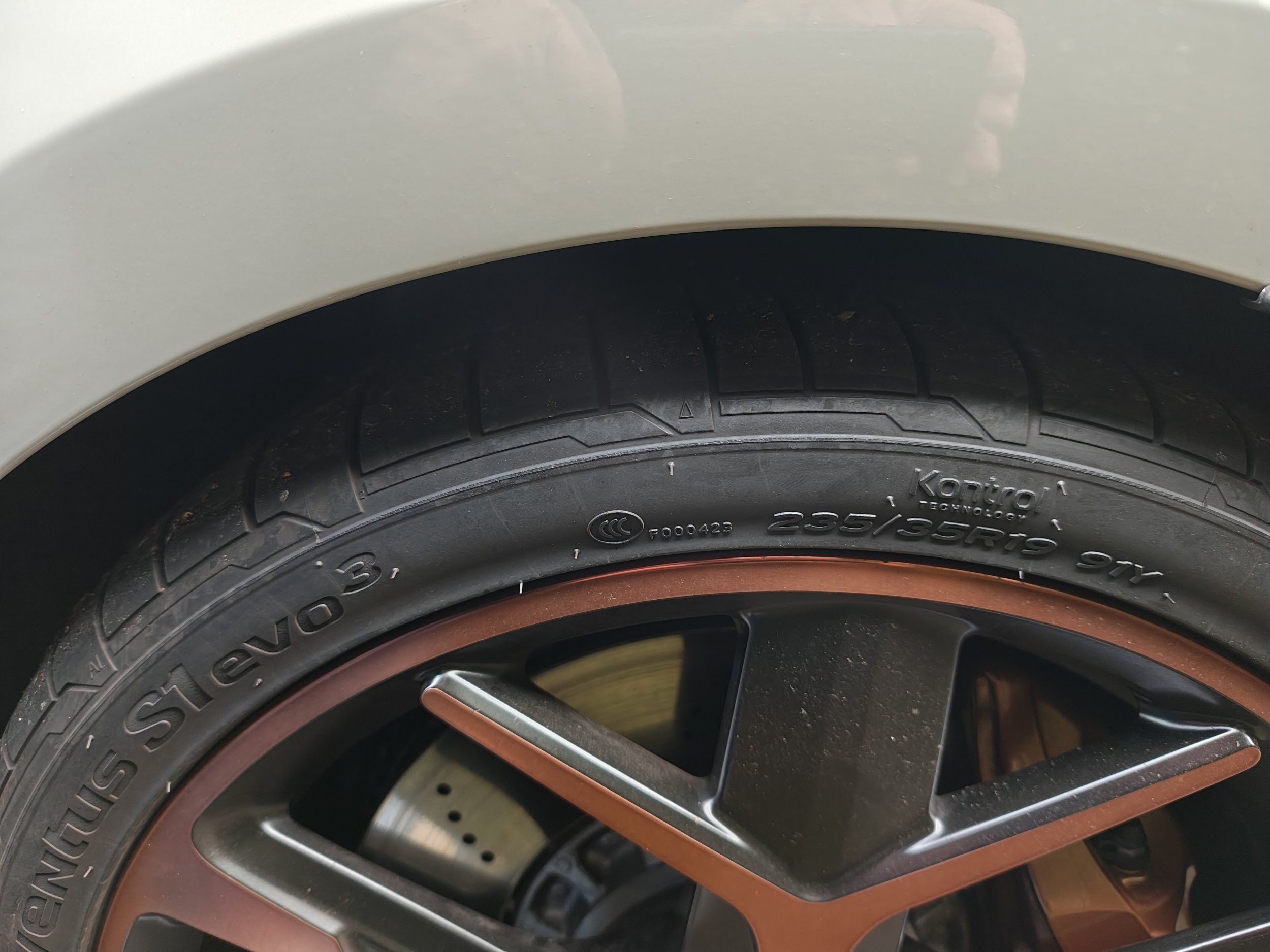

The wheels and tyres fitted to my current 333 estate 235/35R19 are the same as fitted to my previous estate 235/35R19 - same tyre make and brand actually lol.
The spare I have just came with the previous 310 estate I had, so I assumed it would be fine?
hi yes it will be fine as long as it fits over the brake calipers at the front ( the 6 pot akebonos on mine are the issue) - the difference in tyre circumference is about 2.4% smaller in your case - which is within tolerances - see this website for a handy visual calculator https://tiresize.com/tyre-size-calculator/

job completed finally - comparing the length of the original (left) and longer 3G0 803 899 D part (right)
fitted and tightened down
