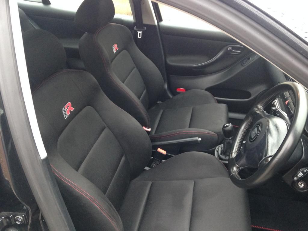

Right made some progress
De-badge grill fitted and got my cupra r splitter on the front too
Also got this armrest off eBay and it screws in the coin tray and fits nicely and secure and good storage so happy with that
Next on my list is a lip spoiler for the boot but will keep updated
