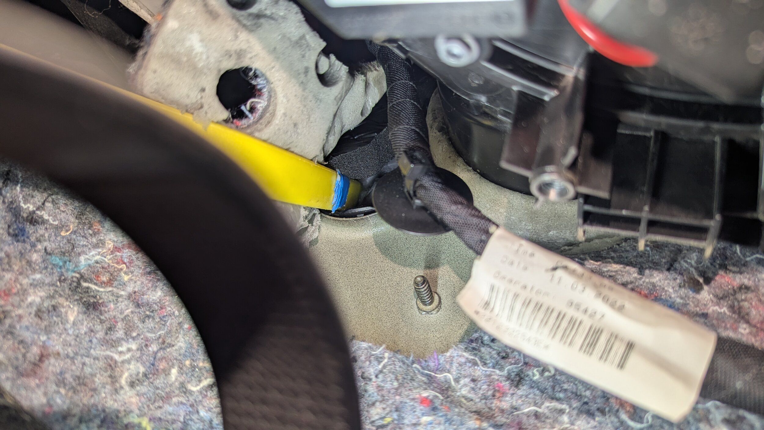

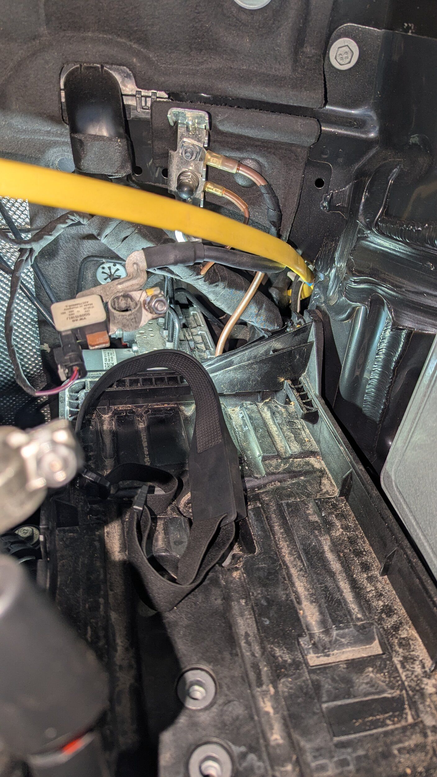

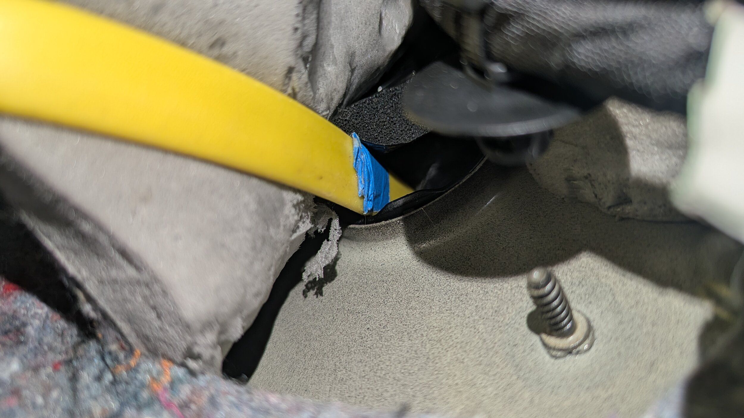

Was a bitch to find the spot. But managed a path through. Just under the wires I believe U were talking about. If U pull away one of the clips holding some wire and pull back the fire proof material U see a rubber bung. I pierced it with a knife and using a yellow tongue got my power cable through. I'll put the post up and photos if anyone else searches.

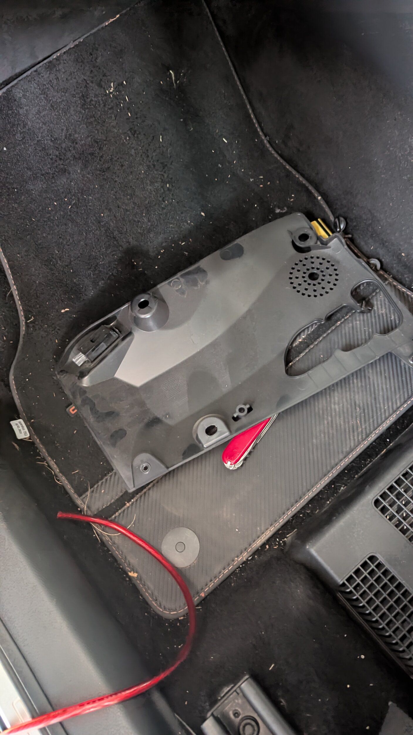

You have to remove the under cover. In the passenger footwell to get to it. Don't really need to remove the globebox
