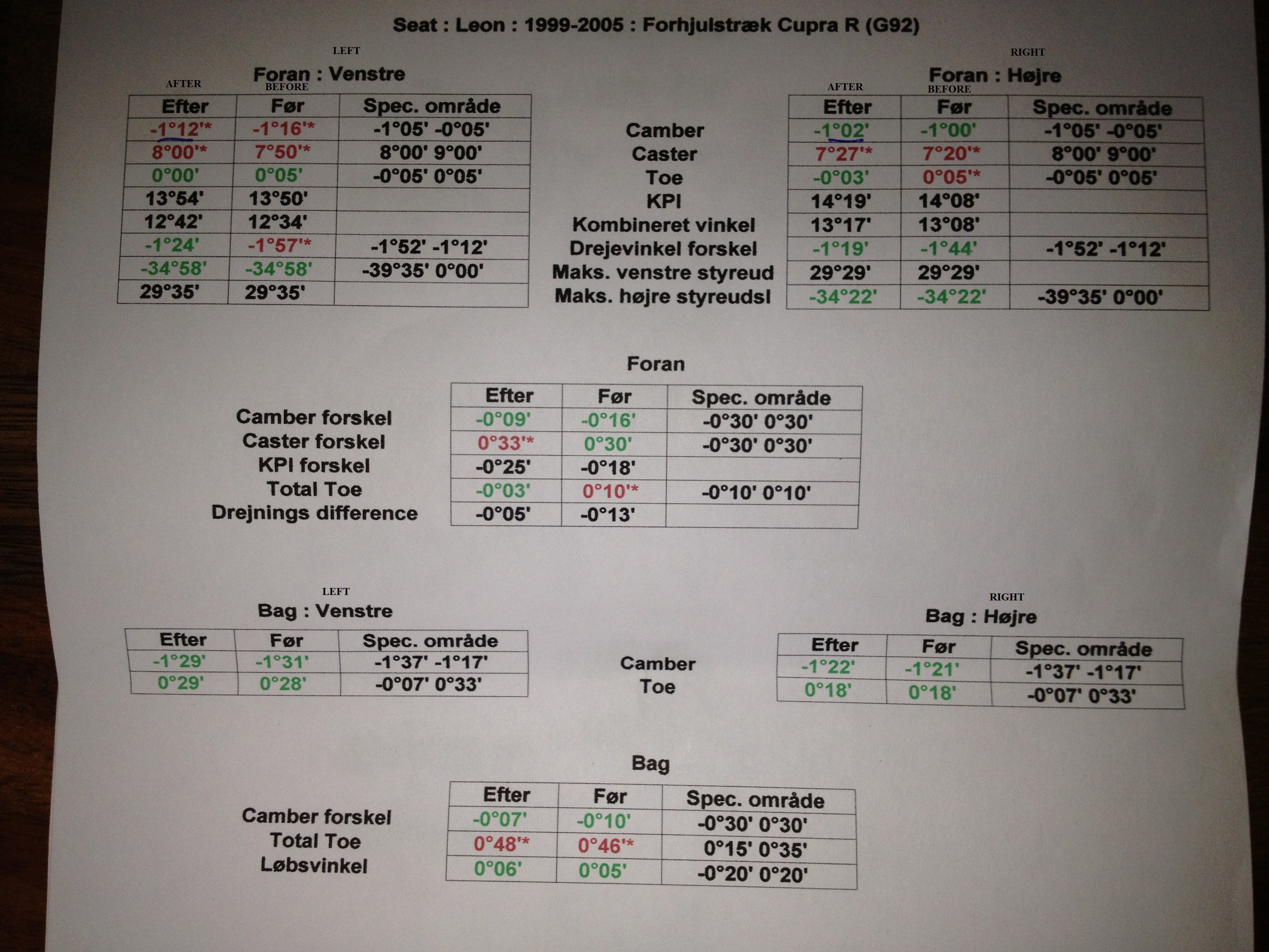

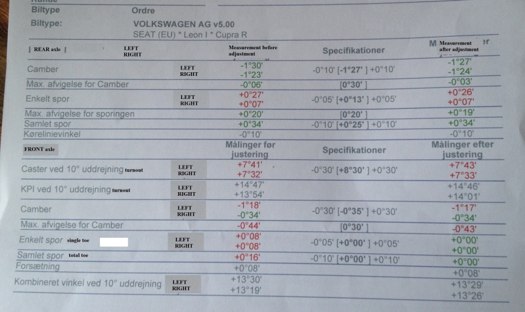

I really dont have a clue on this 4-wheel alignment apart from I dont think red number are great
I had mounted Bilstein b14 coilover kit, and today, (14 days after) had it aligned.
After mounting my summer tyres, stock LCR rims + Pilot Sport 3, if I let go of the steering wheel it dives to the right side.
So I thought a aligment was in place, however, it does not seems like they have fixed anything. Definitely not the "diving" to the right.
Here is the paper, with some translations, as it was danish.
