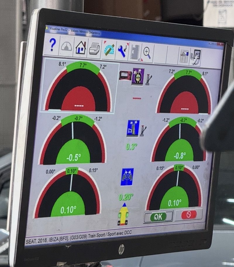

The alignment software has the car listed as “SEAT: 2018, IBIZA (6F0).(G01)”. I wonder if it needs more information specifically on the FR model (suspension difference etc.)?
VAG uses PR codes like G0x for different suspension setups. Your FR most probably has a different setup (lowered & harder springs and accordingly rated shocks) than non-FR models with standard suspension and it is possible that yours is not G01 but some other G0x code that you need to find in the alignment software before starting aligning. Not sure if this would make such a difference that could cause the problems you've been having but you would want to use correct values for the alignment anyway. Let me help you identify your suspension PR code: Send me your VIN via a private message and I'll get back to you with the code.

As I guessed, his car's suspension is not G01, it is G03.

Just an update. Visited the garage and they removed the 225’s and fitted the 215’s as ordered (albeit the newer SportContact 7’s instead of the 5’s).
Mechanic wanted to then test drive it before alignment and he said the tyre change alone seemed to have cured the issue (hard for me to tell from the passenger seat, and he hadn’t driven the car with the issue).
He then ran an alignment. He was the first to do this without the ignition on (keyless system) which kept the day running lights off (all others pressed the stop start button with feet off pedals so turned ignition on, engine off, activating day lights even with light switch set to zero). Day running LED’s off may have helped but only negative was potential activation of steering lock when steering wheel already braced with rubber brick and clamp (with engine off and driver door opened at end of alignment). I’ve read if the locking pin can’t find a hole and steering wheel has no movement to find one, then it can possibly damage the system.
Anyway, when he selected the car model in the computer at the start of the process, I was by his side and said we need to find a G03 option. For a “2018 Ibiza” there were only 2 options with G03 in the descriptor. One was with the 6F and the other I forget - perhaps KJ. As the previous alignment was done with 6F G01 and the suggested change was to G03, we stuck with the 6F option - although in hindsight I’m not sure if KJ G03 is the correct identifier for an FR? KJ does appear in my VIN too.
He didn’t seem to be very bothered about what option we selected and tried to suggest anything 6F (whether G01 or G03) was the same…
Either way the one we used was “SEAT, 2018, IBIZA [6F0), (G03/G09) Train Sport/Sport avec DCC”. It’s an FR but I don’t have an electronically adjustable suspension which I think is what DCC stands for (in sport mode only steering is more responsive I think). No descriptor specifically mentioned FR but this was used rather than the previous 6F G01. Post adjustment (whether to the correct values or not) the car tracks straight at least.
"Sport" is your FR's G03 suspension, and "Sport avec DCC" is G09, obviously the suspension with DCC.
Having both in the same option should mean their alignment values are the same.
A quick look at the official service manual titled "running gear" would most probably confirm that.

Having selected “2018 Ibiza” there were 20+ options. Only 2 had G03 in the full description. The 6F one that we selected and yes the second option (not used), which was (I think) KJ and yes it had G03 in the descriptor too (I forget what other data, wish I’d taken a photo).
I’ll attach a photo from my last visit showing on the left column the starting position (how the car was set up after 5 alignments on previous days whilst the 225’s were fitted) and the final settings the mechanic set with the 215’s on. At least L and R values are equal and the car tracks straight - even under aggressive acceleration or deceleration. To the untrained mind (mine) that seems better than the previous -0.4 on the left and +0.5 on the right.

Screen is mid-alignment
