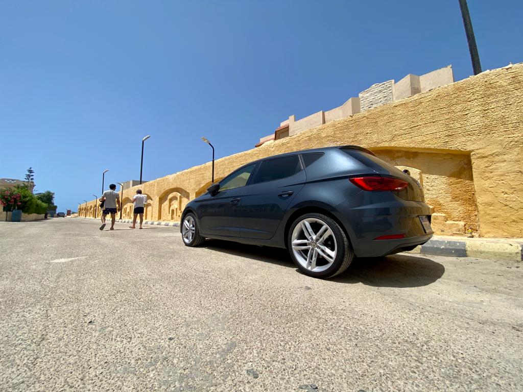

I own a 5dr hatch that came with 17s as standard (SE?). I wanted to change the wheels but could only go with 18s because of the seriously crappy roads over here. The wheels are 18x8j with a ET45.
I'm looking to close that nasty wheel gap and have a nice stance without the wheels poking out too much. How much should I go with the spacers and the springs? Keeping in mind how bad the roads are here and the fact that the car is an SE, so standard bumpers and no side skirts. Along with the 18s, going too low would look quite odd.
I attached a pic, forgive me if it's not the best thing ever :)
Thanks!

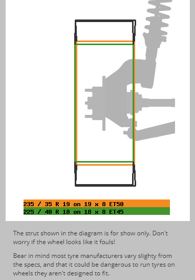

Stock Cupra wheels are 8” wide and ET50.
Cupra R ST wheels are 8” wide and ET45
Cupra R 5 door wheels are 8” wide and ET40.

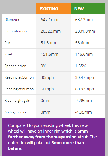

So your wheels are 5mm further our than a standard Cupra or the same as the Cupra R ST offset. Bare in mind Cupra R’s have different suspension setup at the front and rear with more camber.

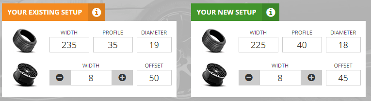

I remember using a different site to calculate, and I ended up with the conclusion that the tire position would be the same. Keeping in mind, my tire size is a 225/40 vs 235/35 for the Cupra.

Appreciate you putting in the effort to take screenshots. I guess, I'm worse with numbers than I thought. :) I was about to go and order 10 and 15 mm spacers, good that I didnt as I dont want any sort of rubbing. I will have to reconsider my options as I only want to go hubcentric.
