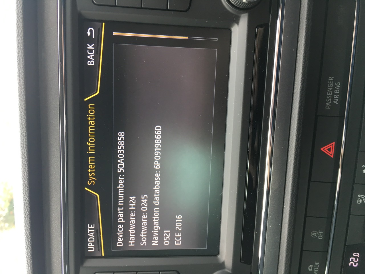

My understanding of it was that only MIB2 units could be activated. I had mine activated so it must have been a MIB2 unit. I had the hardware, software etc shown in the picture. I think the first two letters of the hardware (5F or 5Q) tell your which unit you have

Mark you have Harman MIB2-high device. So it must be possible to have full link.
USB on the center console or on the glove box it doesn't mater. They are connected on the same place on the main unit.
