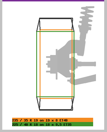

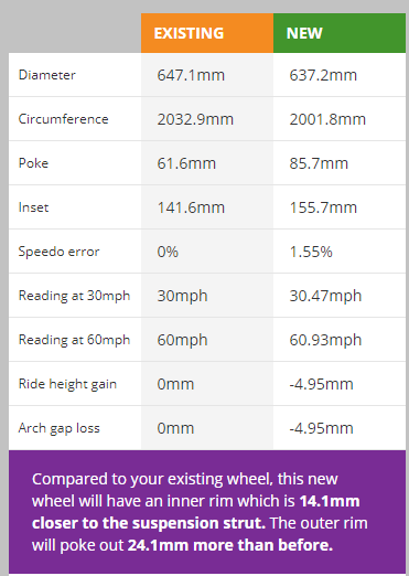

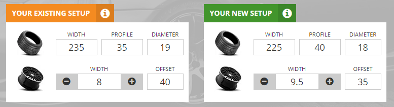

I wrote in the first comment that the rear wheels are 9.5j haha. I didn't say they were that size all round. Any who, I fitted them and I'm happy with the result.

I like the way you think and I haven't got round to cleaning them yet, I need some info on decent products and stuff if anyone has any? So scared to curb them hahaha! Just got to be careful! Cheers mate! And yes damo 8.5 et 42 front, 9.5 et35 rear, they do like slightly but only really the lips. All I need to do is roll the rear arches very slightly as when there is excess weight in the boot(like when I had the standard wheels, subwoofer and mountain bike in on the way back from fitting the wheels, there was a slight rub on the bumps, but nothing bad enough to take the paint away.
They do poke slightly***
