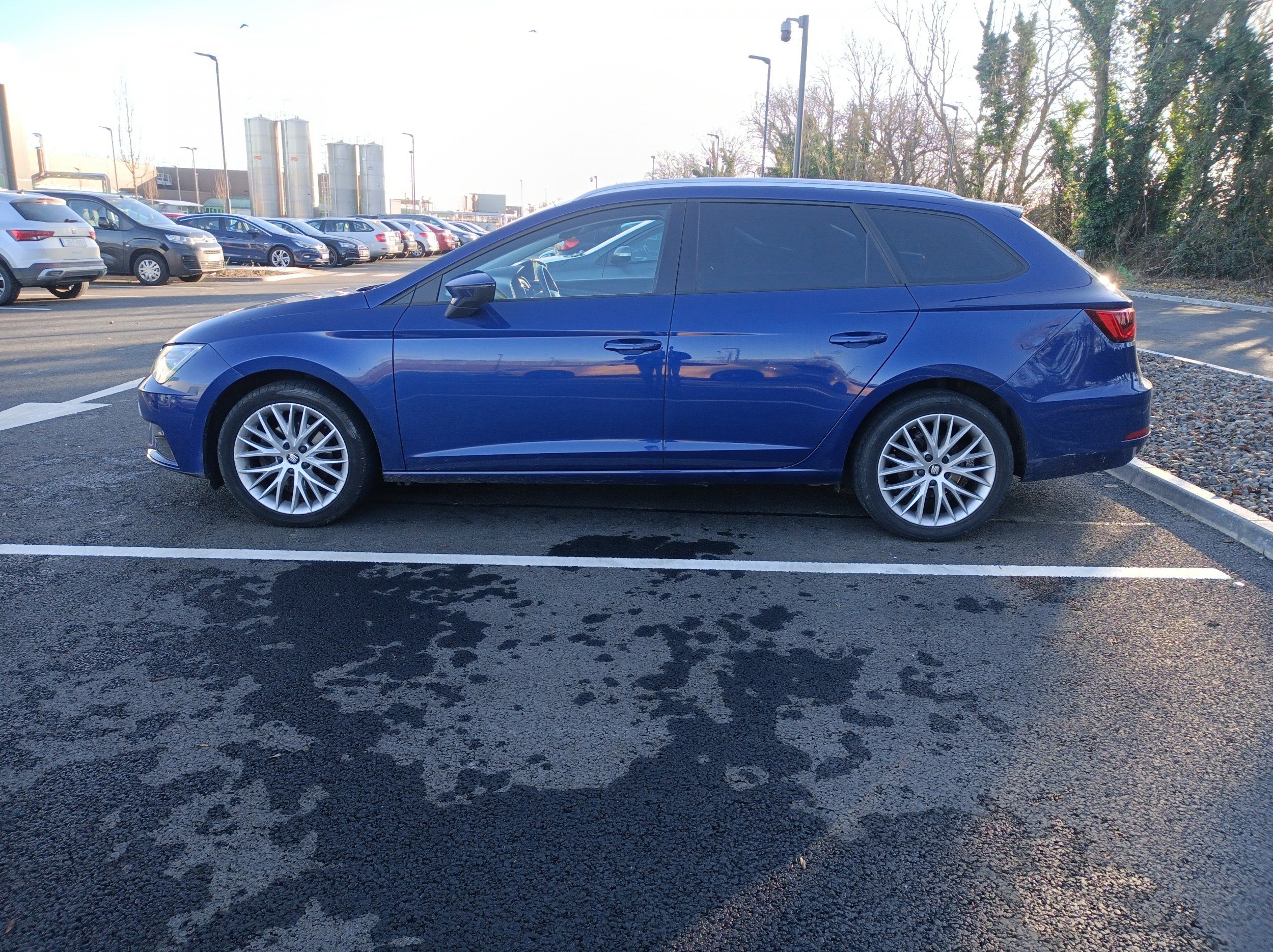

Next up is rear window tint. Went for 15% (2nd darkest in the shop) Darkest was 5% and its just too much so very happy, makes the car look way better.
I believe its just a roll of material stuck to the indide of the windows, but its a good option. 3 year guarantee on it too

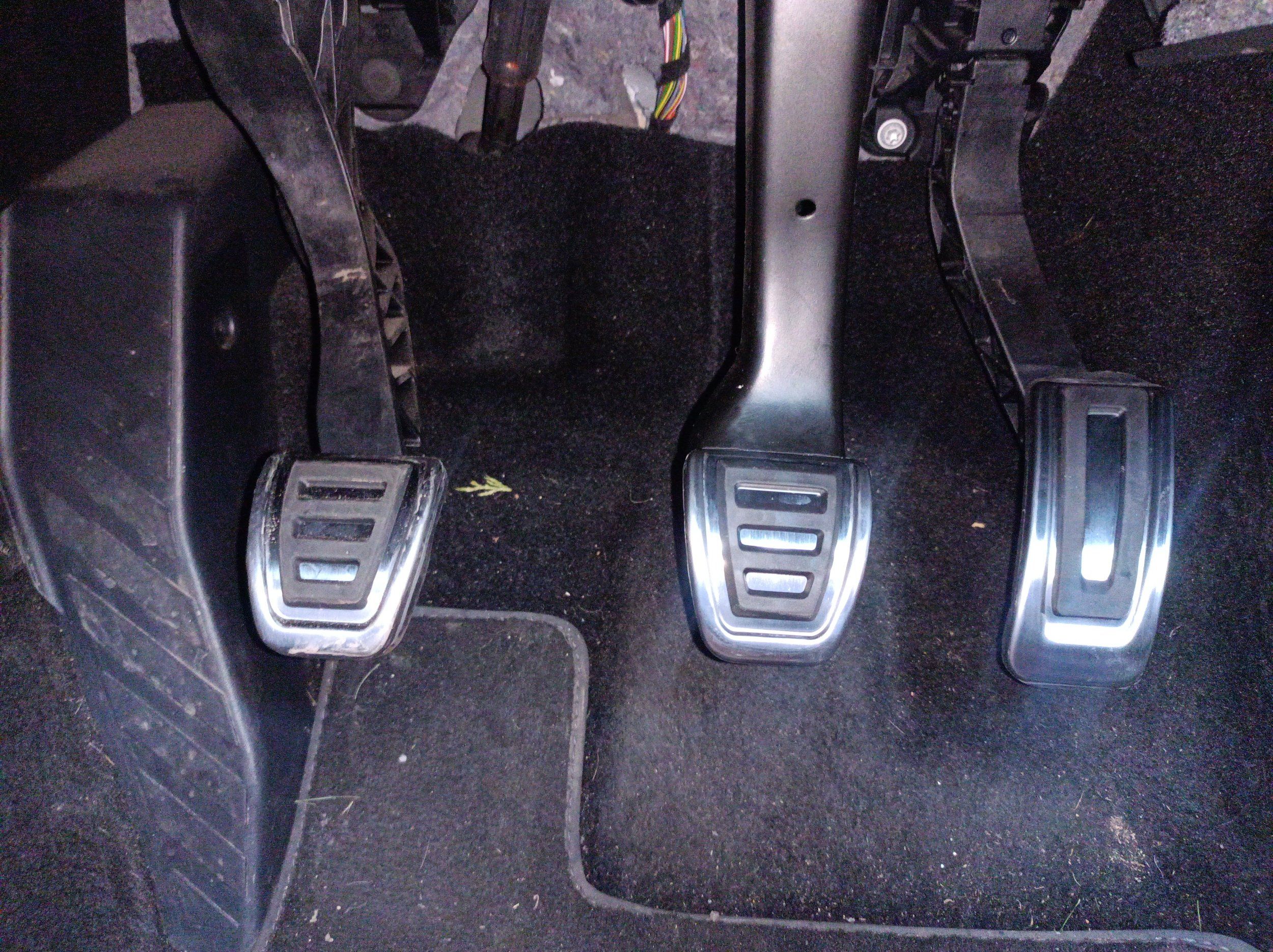

First silly mistake of mine. Bought some aluminium 'sports' pedals off of aliexpress, much cheaper than other options.
They're actually very good quality and improve the look of the pedals a lot...however I bought the wrong ones!
There's a difference between manual LHD and RHD cars. I bought LHD but have RHD. Differences are in foot rest style and *I believe* accelerator pedal length.
So the footrest is useless to me, replacement one ordered.
The clutch and brake pedal fit perfectly. You pull off the current rubber pedals and push in the replacement ones, very easy.

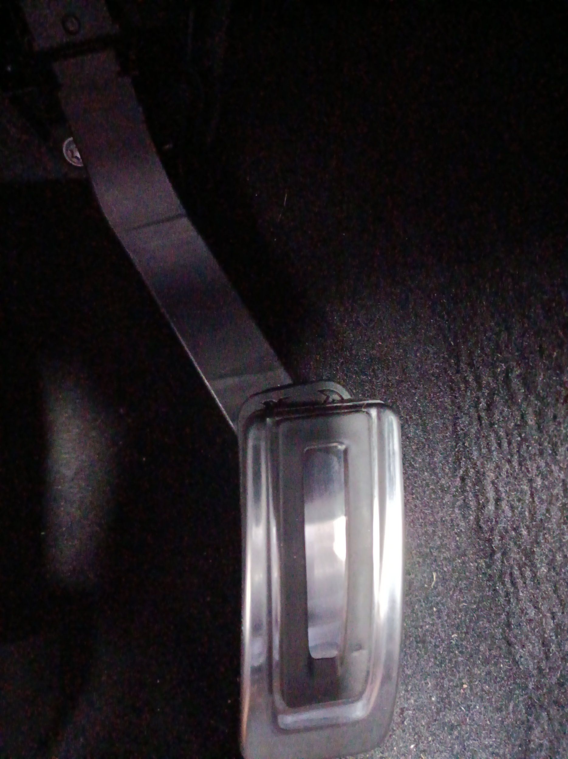

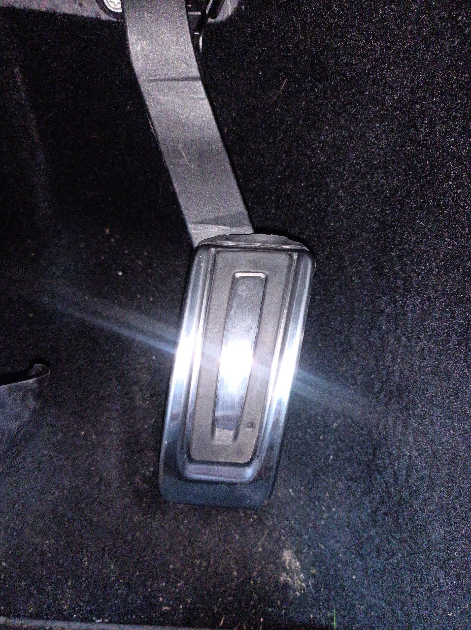

The accelerator pedal is different. It fits over the current pedal. If it was 10mm longer it would fit perfect, makes me think the LHD accelerator pedal is that little bit shorter too and I have the wrong one. I made it work by pushing it on really really hard. It's wedged on there pretty solid for now but still not 100% happy. I'll see how it holds up
Accelerator before elbow grease
Accelerator after elbow grease (rubber is folded over the original pedal on the top, pretty secure but looks a bit **** up close)

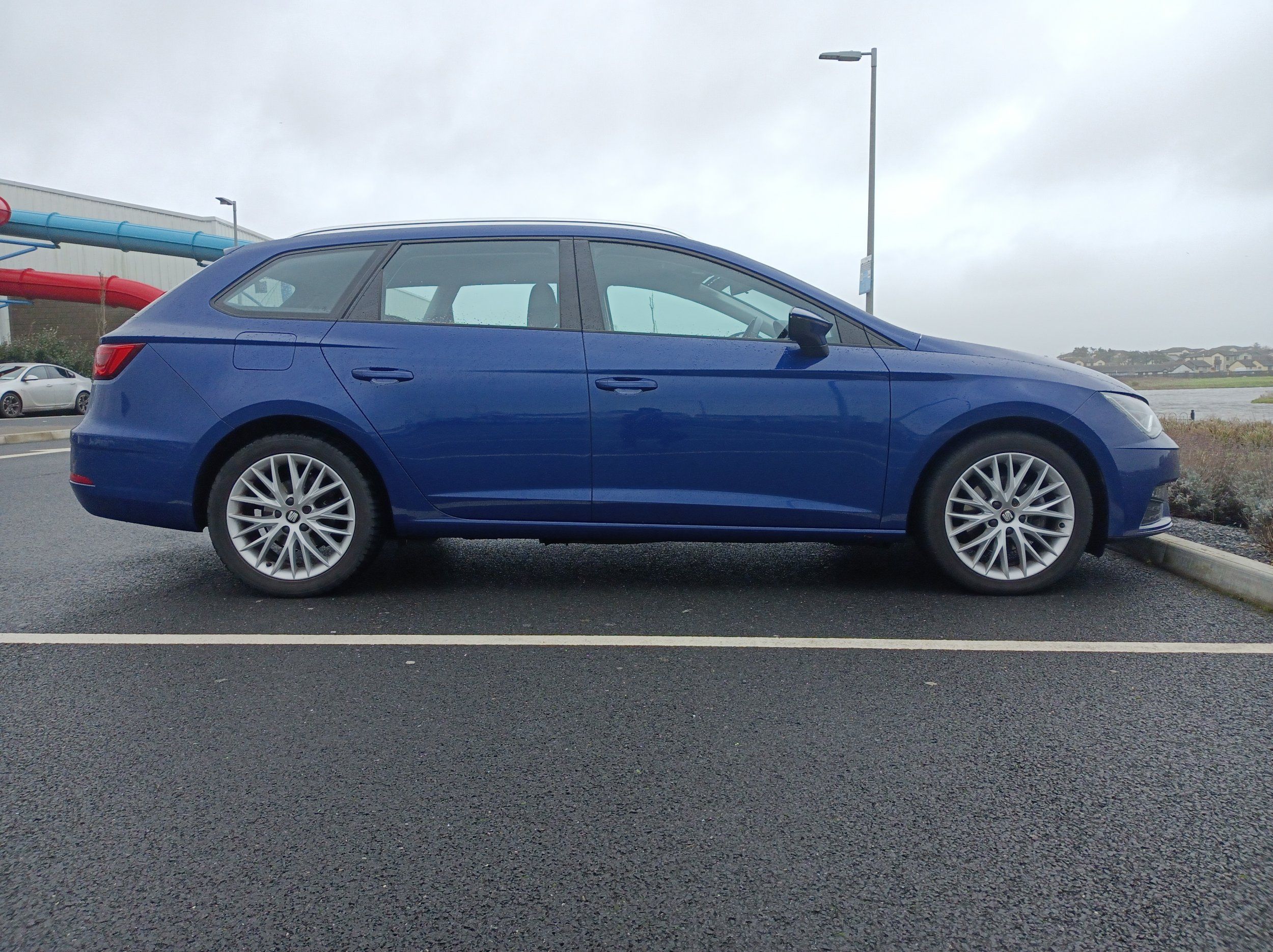

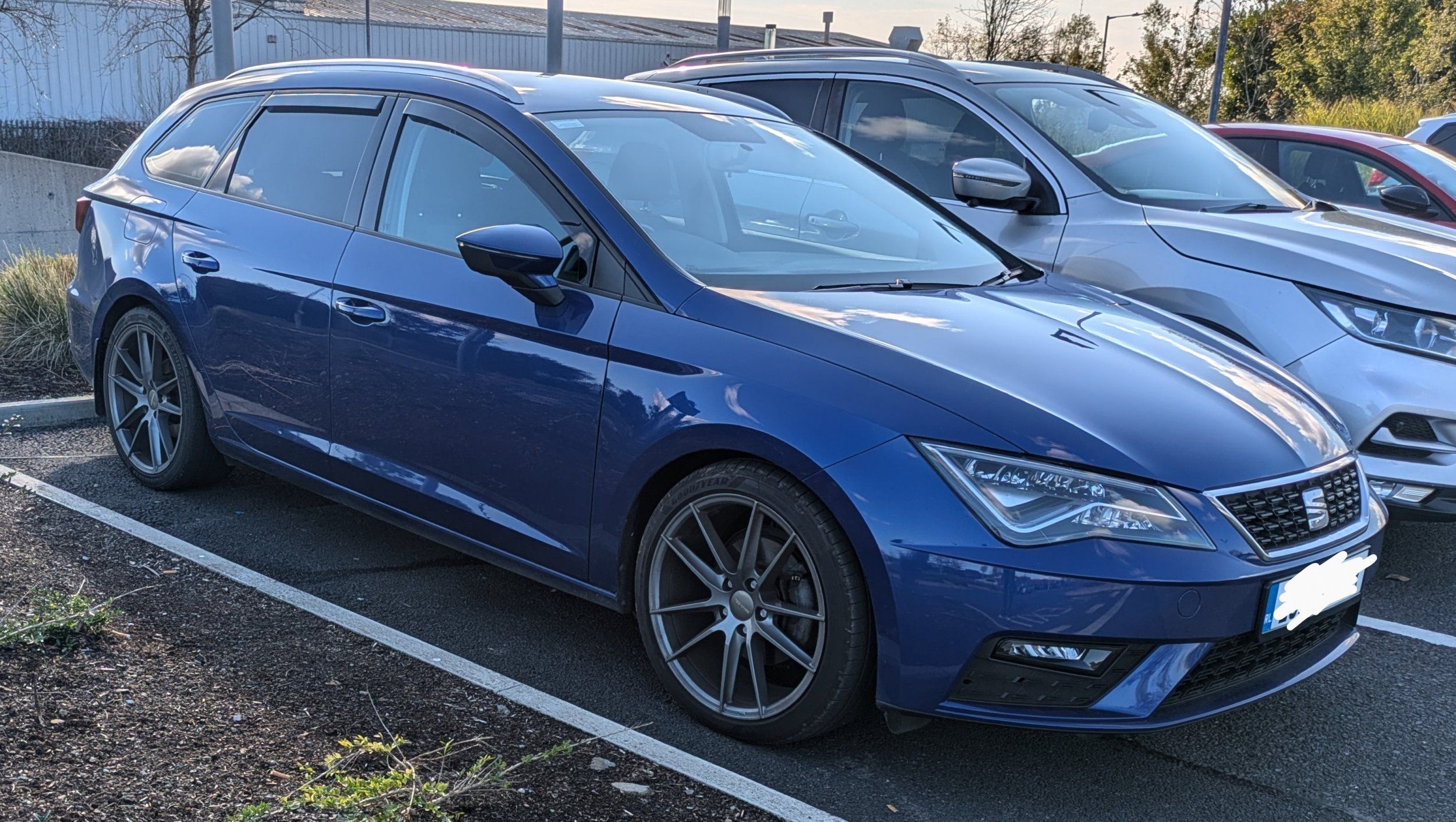

  • Eibach Lowering springs Pro-Kit E10-79-010-04-22 for solid rear axle. Car sits much sexier now, but not too low. Makes the SE sit more like a standard cupra estate. No real difference to ride quality in my opinion either.
  • I tried cleaning the original alloys...and they are such a pain. The spokes are so small so you can't get a wheel brush in between them! So I changed alloys from 17" standard alloys to Veemann VFS25 18" in gunmetal grey. Was originally looking at VW Pretoria alloys in grey but came across these second hand and in mint condition instead for a very good price from a alloy wheel company in Ireland. Came with 4 tyres, 2 no name brand and 2 pirellis but the pirellis were below the minimum tread depth, so I replaced them with Goodyear Asymmetric 6s. Great tyres. I'll eventually get all 4 tyres on asymmetric 6s. Ride quality is also completely fine on the 18s with the lowering springs. Also put some lock bolts on the alloys from halfords.

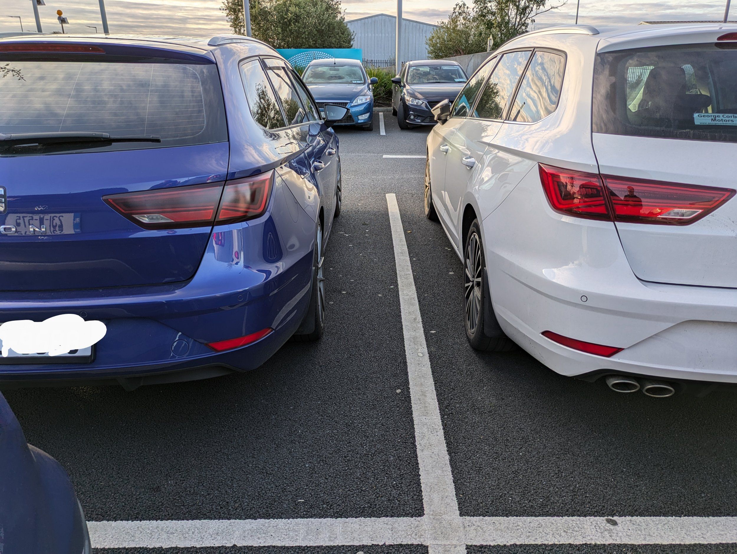

  • Tinted the rear lights. I went quite light on the tint. I tried a vinyl wrap and I must admit I failed spectacularly. So instead I bought a can of spray from halfords. Very watery stuff so had to do 5 or 6 coats. Newer VAG cars have just slightly darker rear lights and I love the way it looks. So I've tried to replicate that. I don't like super dark brake lights as I feel it's a bit unsafe. What I have currently passed the NCT so all good. The only thing I need to do is give them a wet sand/polish as they are slightly hazy. I might also put some clear coat on them too after sanding.
    Halfords tint spray

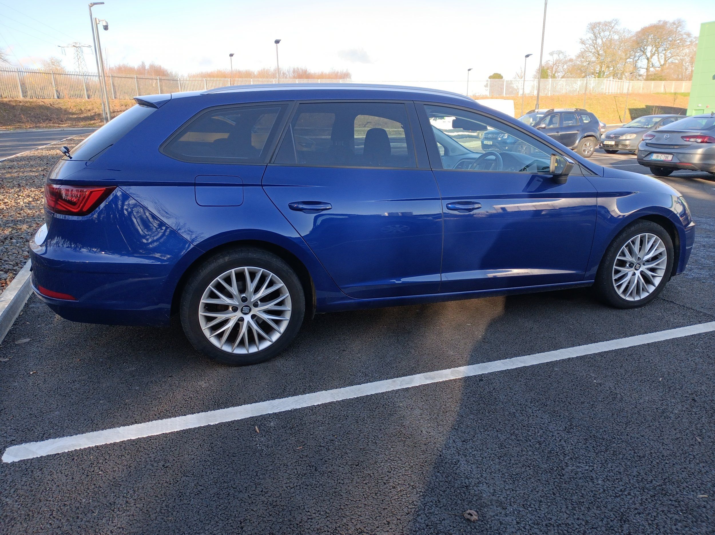

    Here's a side by side with another leon facelift estate in a car park for a comparison:

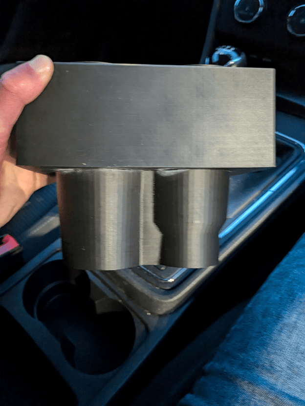

  • The cupholders on the leon are so small as to be useless. I have a nice water bottle that is too wide to fit them, so I 3D printed an adapter. I will eventually release it on thingiverse as I'm not entirely happy with it yet, but it does the job.

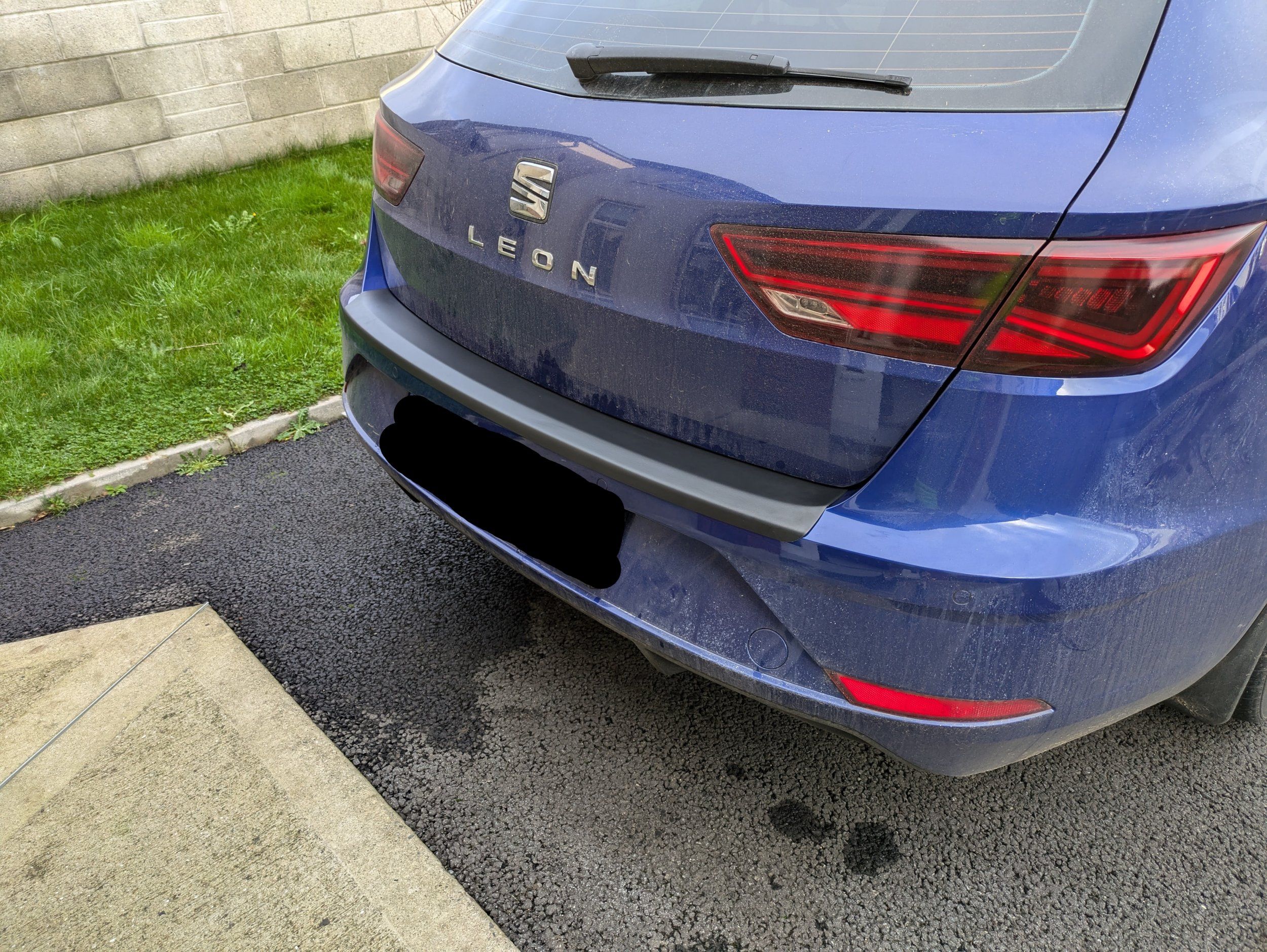

Added a RGM RBP192 rear bumper protector. Previous owner left a big scrape sliding a bike out of the boot, was thinking of buffing it out but was very deep. So covered it up instead and even though the bumper protector was pricy (£75 from amazon uk) it’s a perfect fit and very tough. I feel it looks OEM too.
Also protects the bumper from myself with loading the baby’s buggy in the boot! (Please excuse the very dirty car! Will get a clean soon I promise haha)
