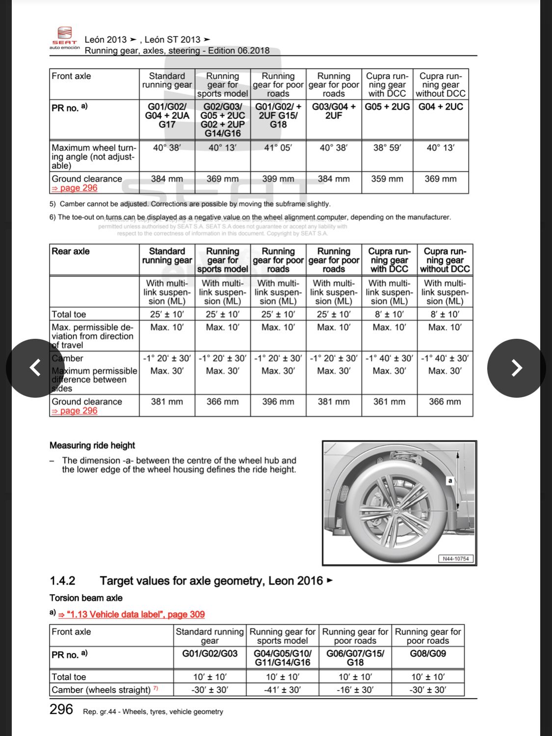

If you look at Section 44 (Geometry) of the workshop manual I referred to previously PR code G16 is referred to as ‘sports suspension’ and a 15mm drop front and rear versus standard suspension.
Reactions: serdar_18fr
Yes, I saw that.
I also noticed that Cupra without DCC has the same ground clearance as FR sports suspension.
With DCC , it drops another 15 mm.
I infer from those tables that DCC makes no difference to the ground clearance on an FR.
They all have 15 mm lowered chassis, with or without DCC.
I would assume that is correct - think that the manual is dated June 2018, which was post FL model with DCC. I guess that you could always measure the ground clearance on your own vehicle in accordance with the measurement ‘a’ in the diagrams - I recall that it tells you what laden weight the vehicle must be to achieve.

But it will never be a precise measurement because I wouldn't know where I should take the measurement exactly at the front and rear, also it isn't clear where exactly the measurement should start: At the lower end of bodywork, or some place at the underside of the car, possibly higher than the bodywork ?
By the way, manual refers the 'a' measurement as ride height, meaning the distance between the center of the wheel and the lower edge of the fender but it doesn't provide data for it. That would also be helpful for a comparison.

The measurement in the tables referred to as ‘Ground Clearance’ is the measurement ‘a’ referred to as ‘Ride Height’ in the diagram.
Oh, you are right, thanks for the clarification.
The use of two terms as "ground clearance" and "ride height" led me to think that they are two different things.
I should have known from the data (366 mm etc.) itself :)
