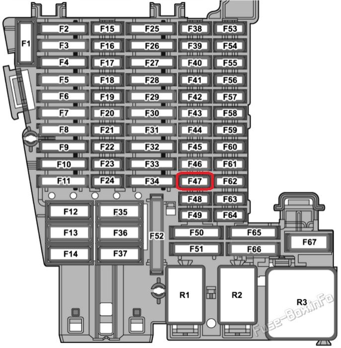

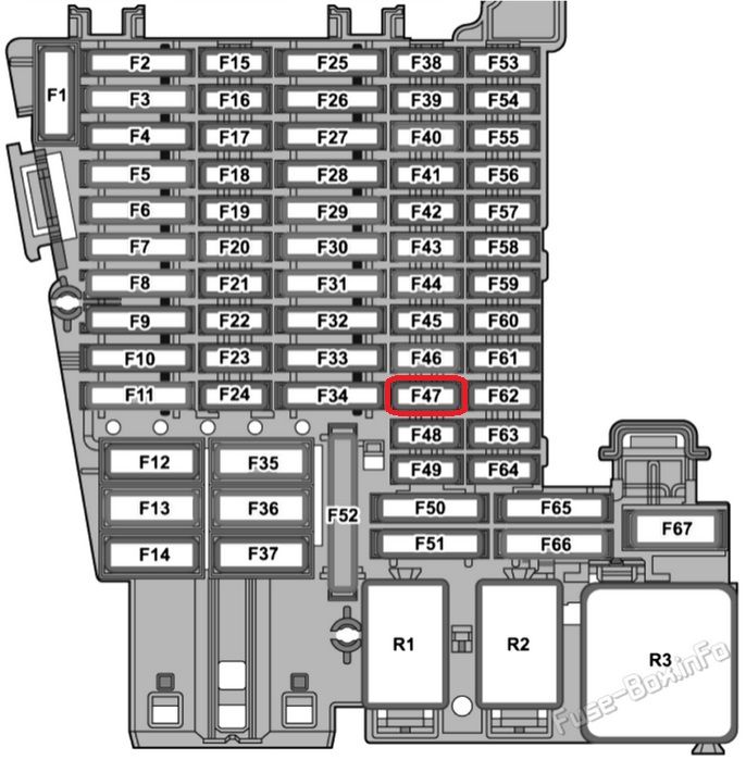

Pull the fuse #47 and let us know. Do you know where they added grease?
View attachment 43147 View attachment 43146
I tried it and to be honest it was not clear for me that there was a difference. The clunking comes after I have driven for long time. And I shortly took the fuse of.
