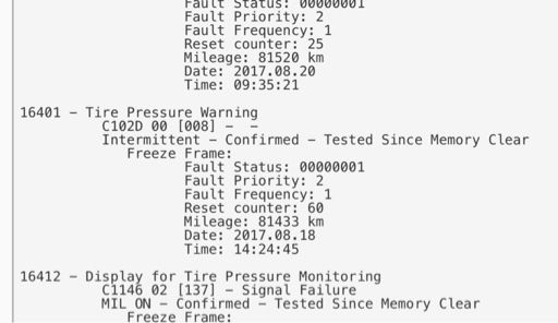

Sorry to dig up an old thread, but I have just been looking into this.
I scanned my car today and had the same 16401 fault code come up. After some research, it seems Carista throws this up as a crankshaft / camshaft position sensor failure, when in fact 16401 on VCDS is to show whether the TPMS (tyre pressure) system has been tripped.
Since last scanning my car, I have had a puncture and the TPMS came on. Scanning the car today I got the 16401 code, but this will be relating to my previous puncture. Cleared the code and it has gone.
