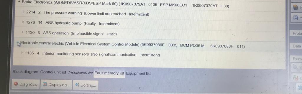

Had this issue pop up yesterday while driving to work. "Error: Brakes Workshop!" Message came up, the ABS light and ESP light came ond and the handbrake light is flashing.
Have these error codes from hooking up to a fault reader:
1276 14 ABS Hydraulic Pump (faulty intermitent)
1130 8 ABS operation (implausible signal static)
Anyone come across these before and can give me an idea what the likely issue might be.

I've no experience of the mk2, i'm usually over in the MK1 section, but the rosstech website is the best place to look up codes for any age leon.
http://wiki.ross-tech.com/wiki/index.php/01276
http://wiki.ross-tech.com/wiki/index.php/01130
Looks like it could be a lot of things, but i'd definitely start by checking the fuses and then possibly deleting the codes and seeing if they come back. It looks like it was just a momentary fault, and it says that sometimes that code can be the result of EMF or electrical interferance, so i'd clear it and see if it happens again before spending time/money chasing the fault.

Thanks for the links. Cheched all the fuses that were located next to the battery, all good. Are there any other fuse locations linked to the ABS pump?
Tried clearing the code and comes back up instantly.

Thought I would update in case it might come in handy for someone. My mechanic has investigated and has narroweed the fault down to a solenoid issue within the ABS Pump/Module. New part upwards of a £1000 from seat, so I've ordered a second hand pump and module off ebay for £70 :) , cross fingers this will do the trick.

I had a replacement ABS pump/module fitted, 2nd hand part bought off ebay. If i remember correctly it was a bit if a struggle for the mechanic to programme the part to the car
