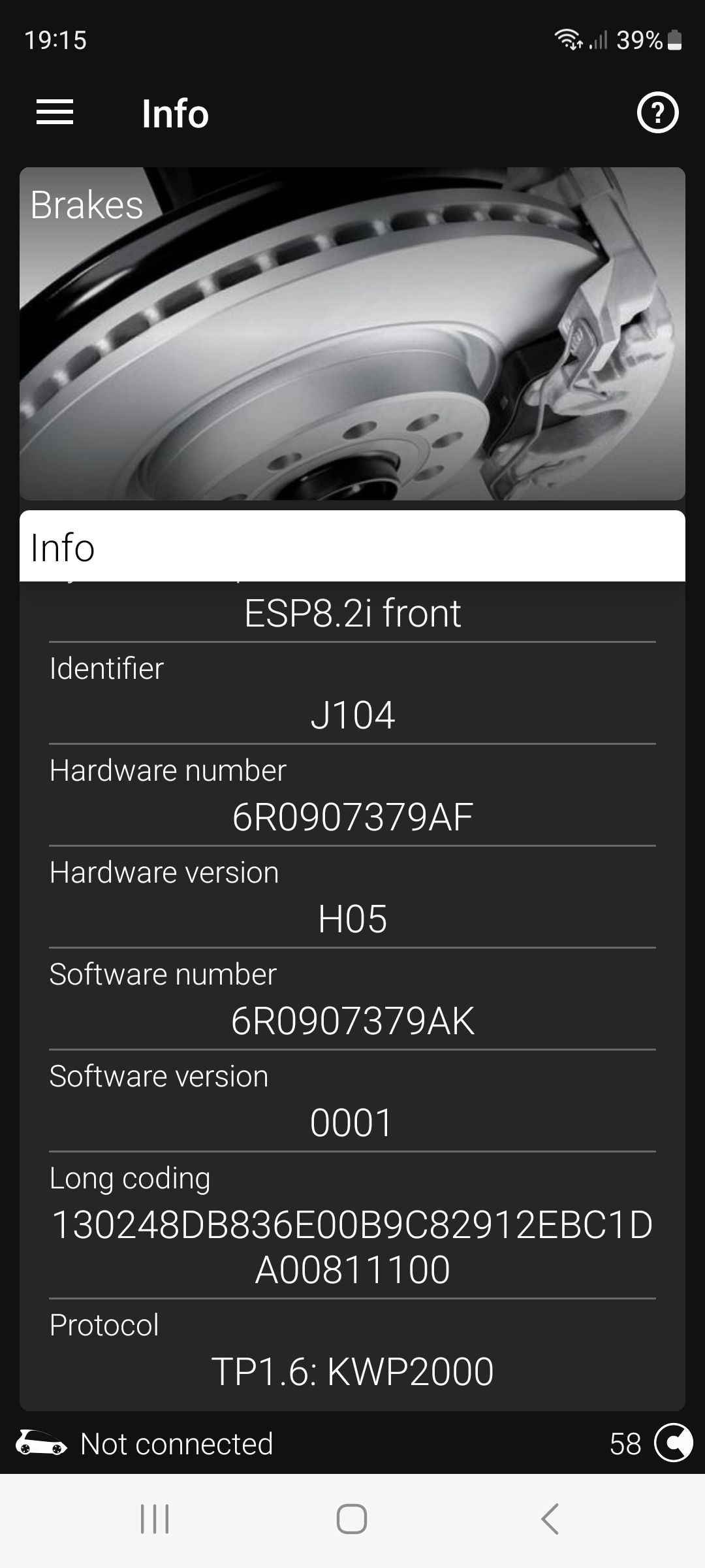

Hi, while going through my modules on my Odbeleven device I've noticed my abs module is coded for a diesel engine with rear sport shocks and no trans selected.
Car in question is an Ibiza Bocanegra which is a petrol, automatic and rear sports shocks (going off the drop down selection menu).
I have tried to login with security access but all codes tried are invalid, I have tried to select correct engine etc but keep getting function unavailable (22) marginal conditions not met.
How much will the incorrect coding effect braking/pedal feel if at all?
Abs pump is a bosch 8.2i front, I've seen a retrofit to a 9.0 can be done with coding and repinning the connector, this would allow for me to select 312mm disc also as 8.2 doesn't support this (but not a major concern).
I havn't got access to the PR code and Ross Tech wiki doesn't have any information on my plaform to generate a login code either.
Any suggestions as a route forward with my current abs?
Thanks
Thanks

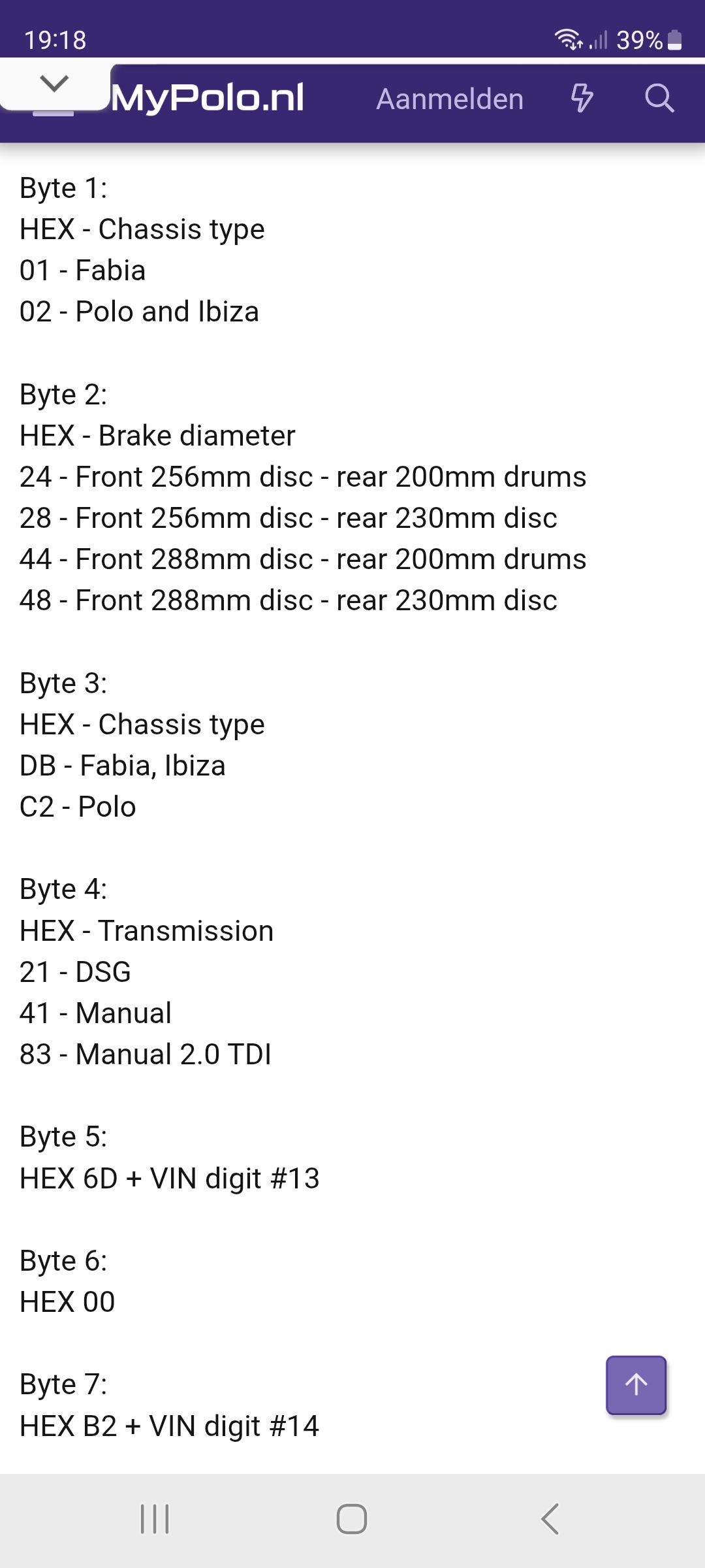

It’s likely your ABS coding is absolutely fine and the labels are incorrect.
Reactions: BocaBill
So you are using OBD11
What does it say on the landing screen (INFO) you will see under the Engine Code I suspect CAVE which is a petrol engine.
Under Engine Control Unit INFO I suspect it will show something like 1.4L R4/4V TS so Petrol Engine.
What does it show in Long Coding Byte 01 - I bet its Direct shift gearbox (DSG) and 7 speed
Under Brake control module I suspect you are looking at Byte 04 with HEX83 which the label shows as Diesel Engine
but if you look at Byte 15 it shows engine type as CAVE (See above)
I think this ABS Module was used on the POLO as well so I suspect a POLO Diesel user has updated the descriptions,
Some of the better options show things like Gasoline Engine with automatic trans / diesel engine because this brake kit is used on both Petrol and Diesel cars. As I said in my first post these descriptions are manually created by users and are error prone as many components are used across multiple platforms, further some people just post rubbish.

Yes that's corrects byte 4 is 83 and from what I've found online the correct value should be 21.
Yes correct same above for ECU info, long coding ecu byte 1 shows HEX 00 'No manufacturer selected'
My coding does show CAVE in byte 15
OK I have fixed the label on Byte 01 for control unit 03
I have updated byte 03 and it now shows Fabia, Ibiza as per your list
I presume that no coding changes to Byte 04 in Control unit 03 therefore this is how it came out of the factory.
If it helps I am happy to try and change the label so that it shows Petrol / Diesel but I think you need to be careful of the list you have provided as this ABS Module is used on both Petrol and Diesel motors and as stated labels are user created and often wrong / missing information.

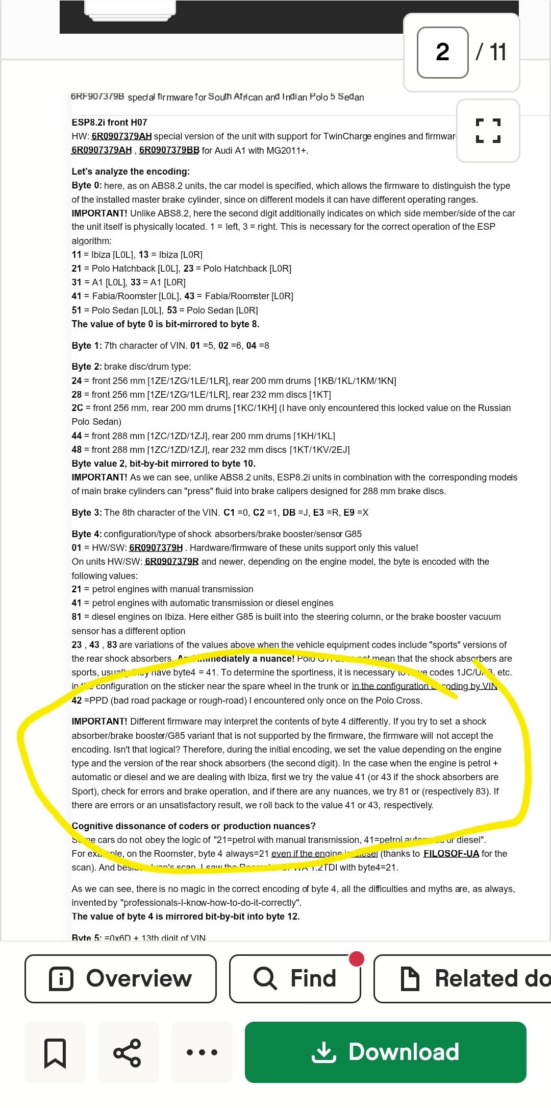

I've seen the changes, thanks. On doing some more reading online I've found that hex 83 is a variant of the other values given above to show the inclusion of sport rear shocks, so it more than likely IS coded correctly just ODBELEVEN labels don't account for all conditions
