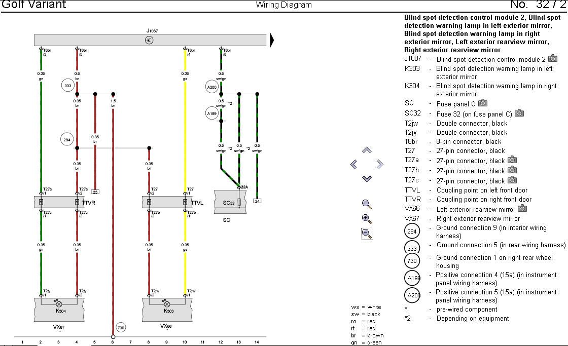

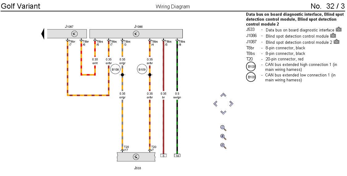

How difficult was the install and do you have the coding instructions to hand?

See if that helps a bit. Coding is pretty easy for someone with some vcds know how. Trickiest part is the wiring through the doors to the mirror itself.
  • AUDI A3 8V side assist Spurwechselassistent.pdf
