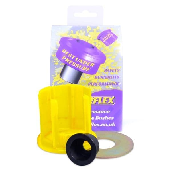

PFF85-832 Road Series polyurethane bushes - you can fit them and forget them because they won t wear out ekm productattributes key MAKE ; productid
www.powerflexsuspensionbushes.co.uk
It’s your traction which is stopping wheel spin I think, not the brakes. Mine used to wheelhop a lot from a standing start. Upgrade your tyres and add that mount. That helped my car.
