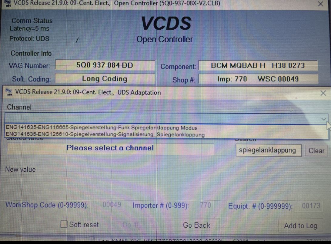

Mirror Folding:

Ok, first off, complete an 'Auto Scan' and 'Save' a log file.
Mirror Folding: (note these were both active and activated from the factory on my vehicle)

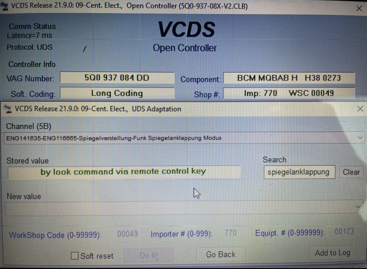

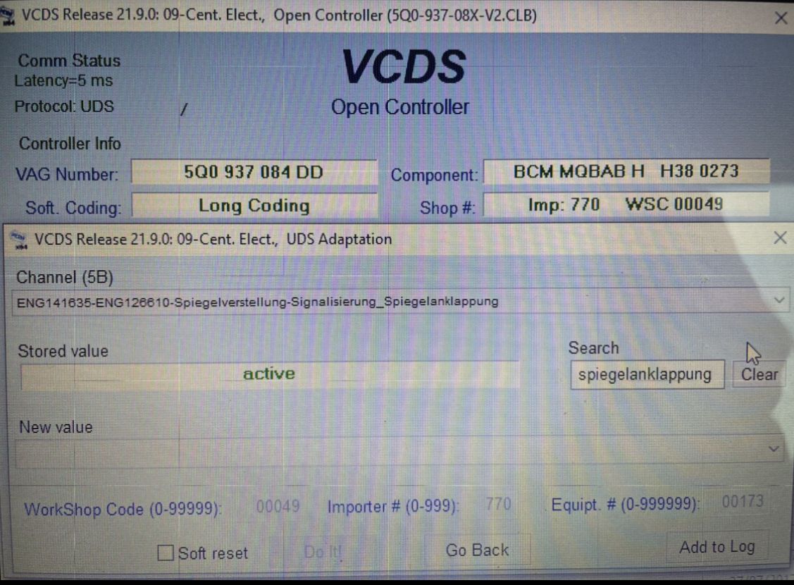

Open control module '09 - Cent. Elect.'
Open function 'Security Access - 16' and enter code '31347'
Open function 'Adaptation - 10'
In the search box type 'Spiegelanklappung' (mirror folding in german - this will reduce the number of adaptation channels when you use the 'drop down' menu)
You will then have two adaptation channels:
- The one with the text 'modus' you will need to change the value to 'by look command via remote control key' - this enables the mirror closing with remote key
- The one with text 'signalisierung' you will need to change to active - this enables a menu option on the infotainment that you can toggle on/off in the vehicle settings>>mirrors options
Close the adaptations down, check the soft reset, and click 'do it'

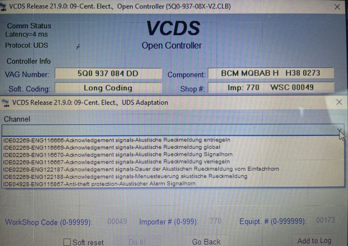

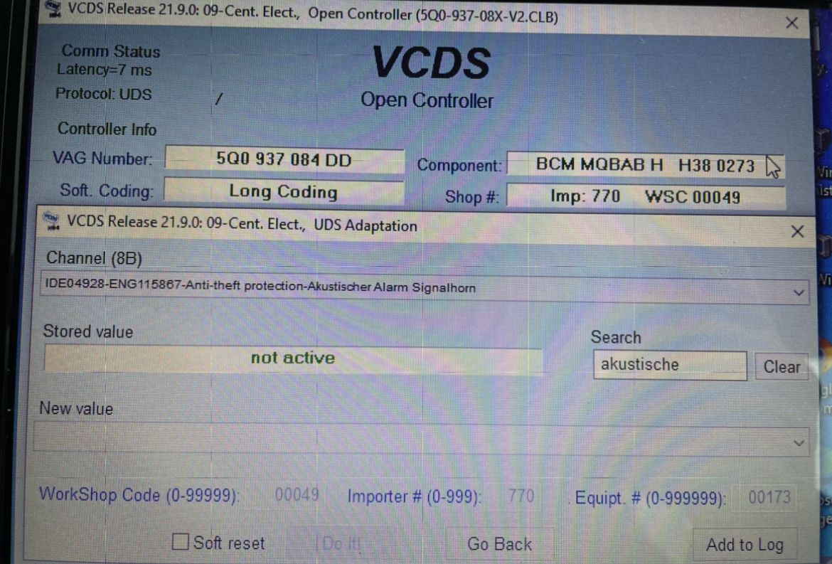

Beep when locking/unlocking:
In the search box type 'Akustische' (this will reduce the number of adaptation channels to 7 when you use the 'drop down' menu)
I didn't have time to complete this fully, but I would follow the stemei.de link and broadly follow the directions there for adaptation channel options.

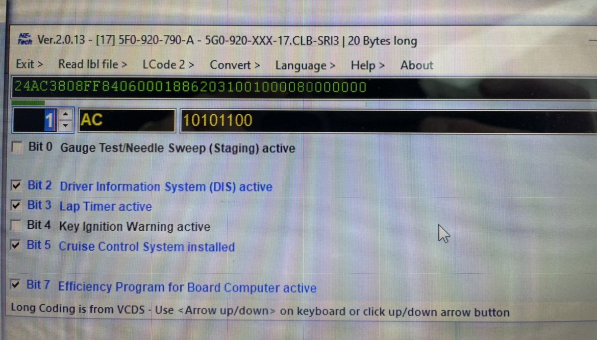

Needle Staging:
This did not work on my vehcile with revised digital dash - I was able to change the long coding, but this didn't do anything. The module was then difficult to recode back to the original settings.
Instructions are here though:
Open control module '17 - Instruments'
Open function 'Security Access - 16' and enter code on the pop-up window; mine used the second code, but yours may be different.
Initially I used the adaptations using 'staging' but this returned a 'channel not found'
I then used the long coding, 'Byte 1', and checked 'Bit 0'. The coding was accepted, but as above, this did not work. Ultimately, needle staging is to provide confirmation that the mechanical instruments are functioning correctly, whereas this is not required on a digital display.
