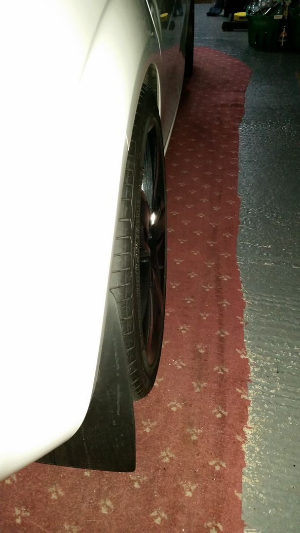

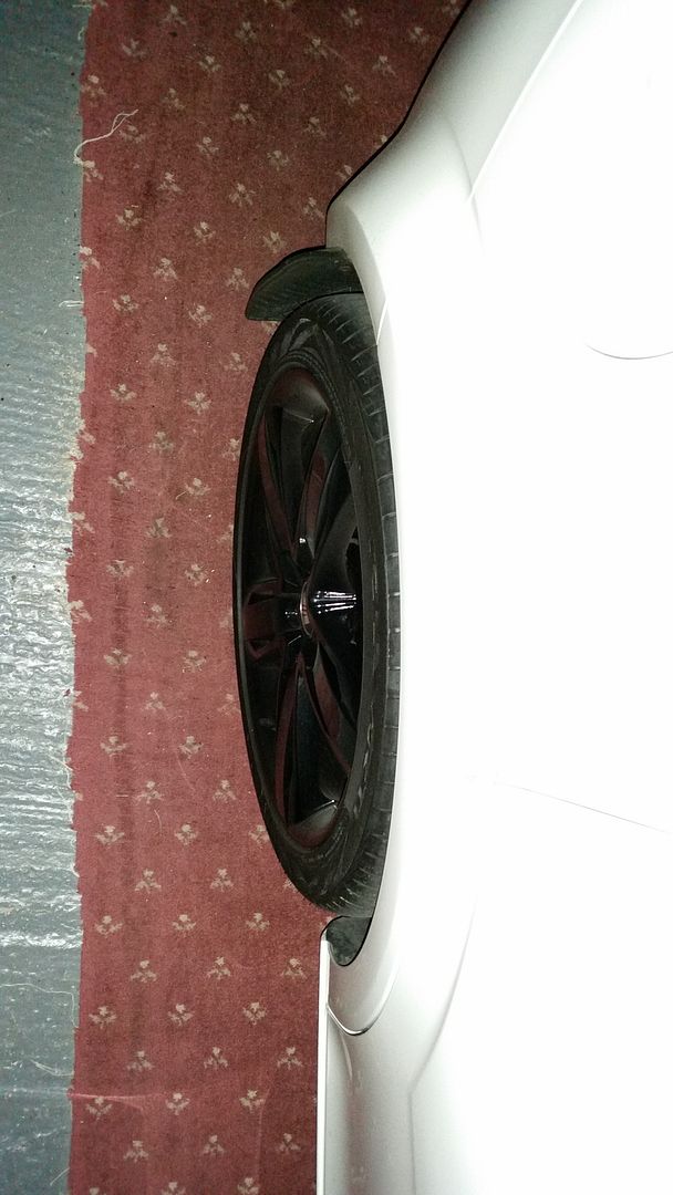

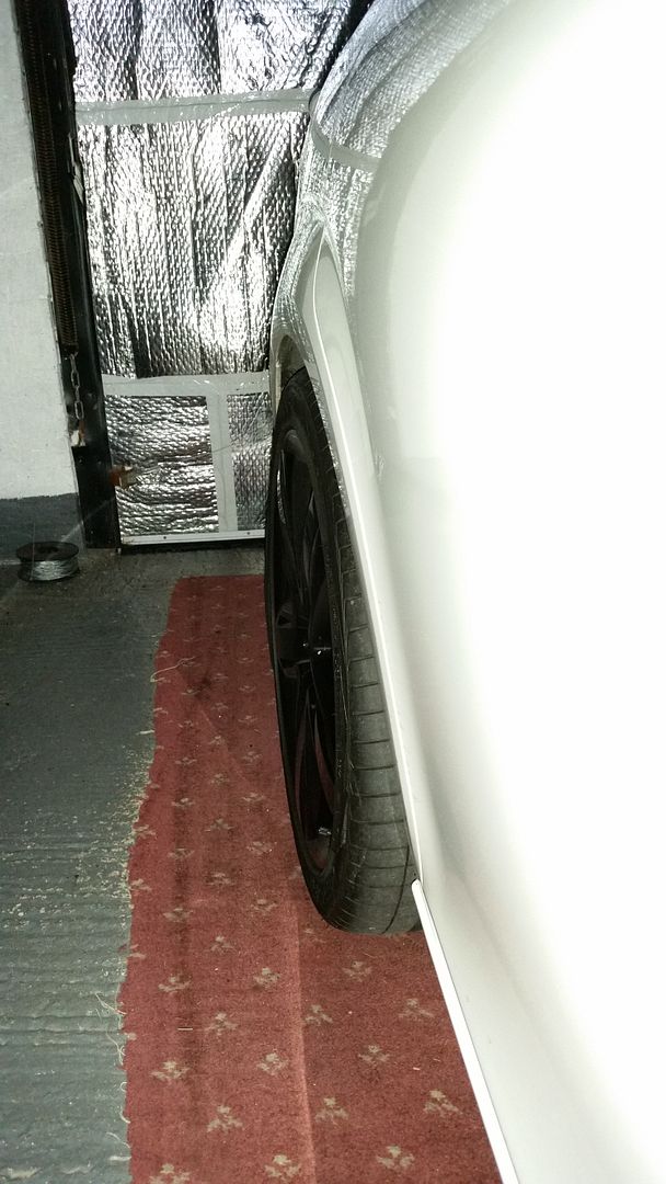

hi lads , got springs and spacers fitted and all looks well . However, the front 10mm spacers I got of a guy turned out to be "universal" ones that allough they fit they are ever so slightly off center.
The ebay 15mm ones are great quality , so was thinking of just ordering another set.
Is there anything against fitting 15mm to the front aswell as the rear ? Will it scrub on full lock or something ? Just looking at the 10mm ones I'm thinking that changing to 15mm will look better but won't fit them if they might give bother :)
Thanks in advance.

You definitely want hub centric for the front then. I'm guessing 15mm could scrub at times with your sport lines fitted as they lower the front a good amount and tend to give a 'nose down' look.
I'm wanting to space my rear's 15mm, have you got a pic of yours with the spacers fitted by any chance?

I'll answer my own question, 15mm on the front is too wide . Borrowed a set to try. It also turned out that the 1st set I had on the front were actually 8mm , so 10mm ones should be fine.
