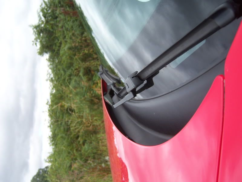

Instead of buying the wiper arms complete. You can actually buy aerotwin wipers in the correct size with the hook adapter instead of the other. As long as you know the sixe you need then its all ok. iv done it on mine... (prefacelift fr)

Just get the Bosch retrofit ones, look just as good trust me. I have them and well chuffed !! Don't waste ya money on the arms aswell. Save it and get a polo rear wiper aswell..
