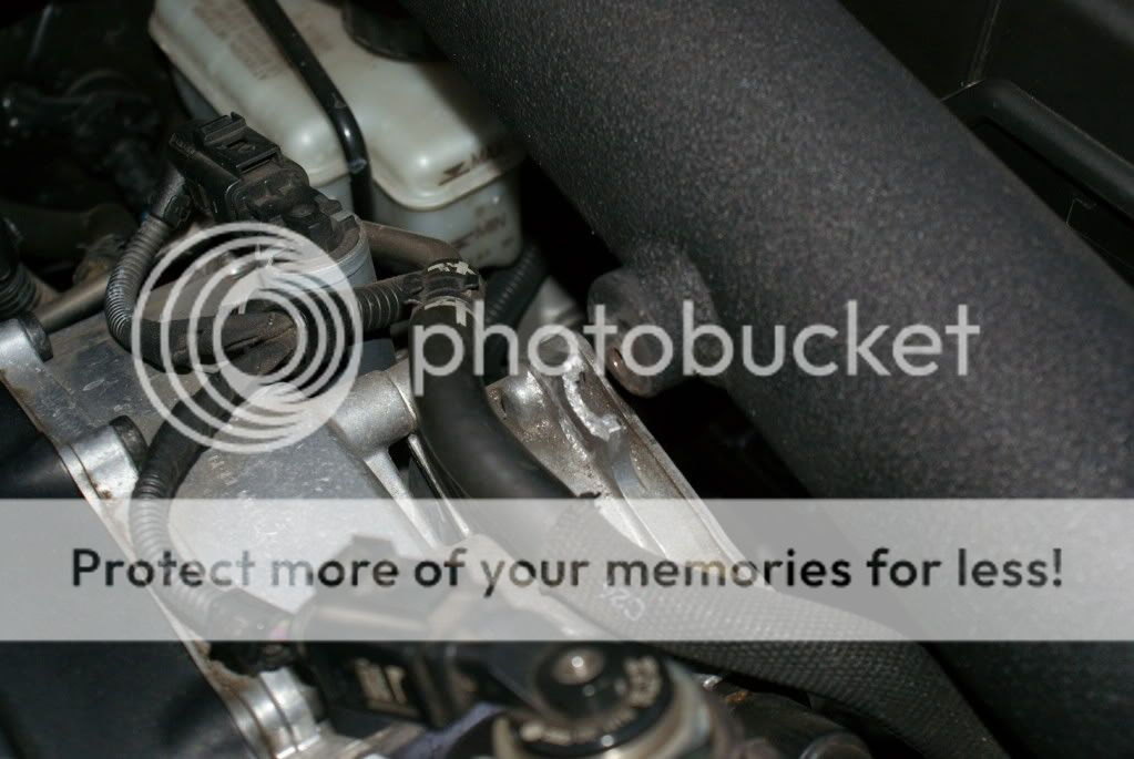

The BSH appears to be another option but not sure I like the fact its zip tied onto the engine. :blink:
The zip tie is a personal choice. The BSH kit does actually come with an attachment bracket to that piece, however after cuprak1 saw this pic he decided to ditch the bracket for a cable tie!
JEEEEZ! how on earth has that happened, it's a pretty chunky bit of metal! My neuspeed is attached to this and it is a solid as rock! Looks like it'd need a big force to snap that!?

The stock engine mounts allow a great deal of forward/backward momentum. It could well be if the bolt was over-tightened with no or little play (a washer is always worth fitting). Then the movement under hard acceleration can be enough to tear the bolt from the alloy mount.
I have an up-rated dog-bone mount fitted that drastically reduces this momentum. My Dbilas while it was fitted was fixed to the same mounting point and we used an alloy bolt and washer and left some movement/play in the mounting point. Theory being an alloy bolt is more likely to fail before a steel bolt, which would tear its way off the mount as its alloy itself.
Needless to say mine didn't break, but then my engine doesn't swing about now like a washing machine on spin cycle.
