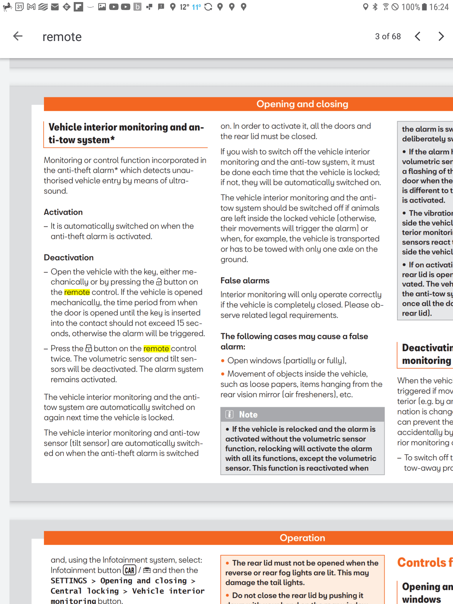

Normally it's an open window.... The battery loosing charge can do it since they are set up to monitor variations in the battery voltage. So a duff battery could be the issue. Wind vibration is another one. A lorry going past rocks the car. You could try out the ferry crossing one I use sometimes. Reading my notes, two clicks on the lock button of the remote. It is in the Arona manual. May work and be a temporary fix until you get it sorted out. Under deactivation.
