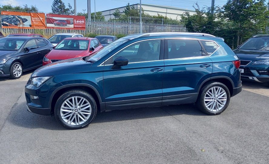

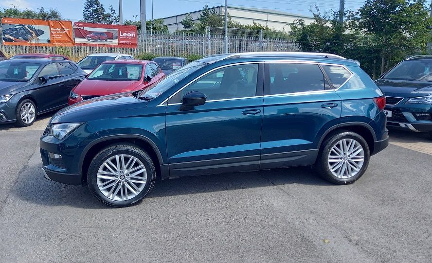

My Ateca Xcellence has multi spoke alloys and they are a pain to keep clean and they don't look particularly exciting:
I am looking to replace them with FR alloys, or possibly SE alloys. I want to stick with genuine Seat Ateca parts.
If I get a set of alloys like these ones on eBay, will they swap straight over? Can I use the existing wheel nuts etc?
