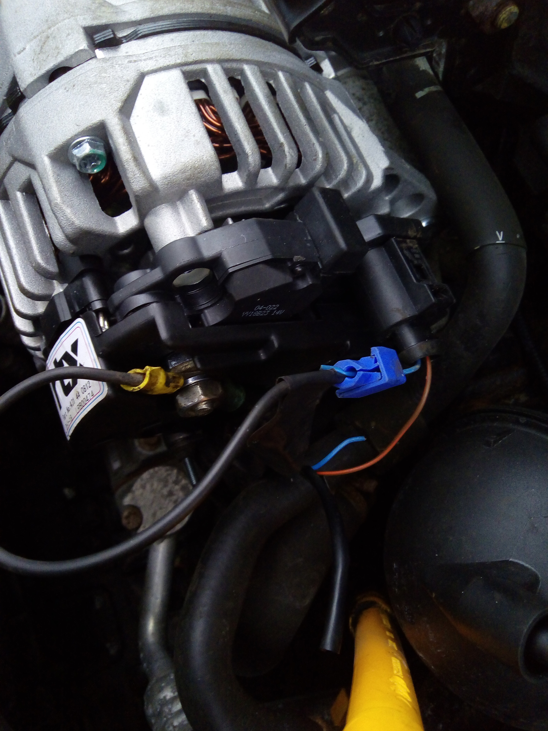

Hi, got a alternator fitted by the garage due to battery not charging.
I am having problems with the battery draining empty overnight since the alternator was fitted a couple of weeks ago. Was going to check for a parasitic drain coming from somewhere but before I do I wanted to make sure the wiring was correct in the newly installed alternator.

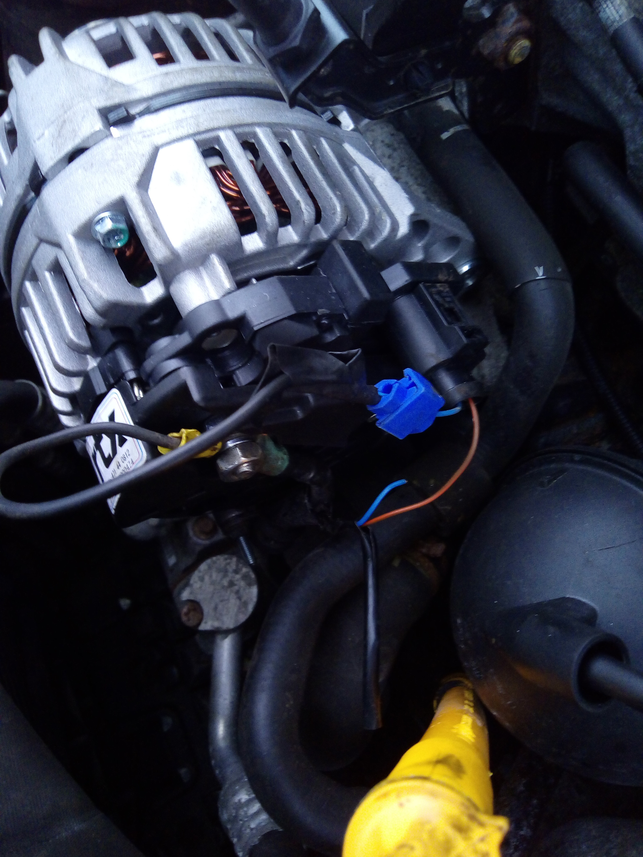

There are two wires coming from the car loom that go to a plug on the alternator. One wire is red and one is blue. The red wire is connected straight through but the blue wire looks like it has been cut from the loom side, and a new wire has been installed in its place from the chassis on the alternator itself. I have attached on a couple of pictures of it that will explain it better.

It could be that your question is a bit tricky, I'd always only fit the correct alternator for that car, what cheap skate sort of place did that for you? Take it back to them if it was okay before and is now not okay, thinking/guessing between the lines, there should be 2 wires connecting to that plug, one is for initial field excitation and the other is to control charge demand by sensing the load. Are you sure that the "moved/fudged" bit of wiring is not just being connected to the rectifier bridge and not alternator chassis?

Thanks for the reply, on further inspection the blue wire "fudged wire" is connected to the main 12v supply on the alternator from the battery? I think what's happened is the exciter wire has snapped somewhere further back and they have used the fudge to give it a 12v signal. When I remove the fudged wire the alternator no longer kicks in, however on removal of this wire I no longer have the parasitic drain of 0.5 amps that I was getting, has dropped back down to 0-10ma. I reckon I will need to try and find where the exciter wire goes to (fuse box, then dash?) and then either run a new wire or fix the break. Took car back to the garage yesterday and they said they couldn't fix it and would need to get an auto electrician in to do it. Do you know where I can get the wiring diagram for this?

I have spotted a brek in the blue wire just before it goes into a connector bolted on the outside of the starter. Looks a nightmare to get to though.
