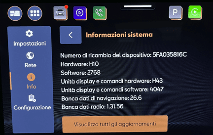

Hi everyone,I’m sharing a change I noticed on my Terramar mild‑hybrid after the latest software update performed at the dealership (version 2768 – display 4047 – Navi DB 26.6).
Before the update, the interior ambient light stayed on whenever the position lights were active, which are always on during the day due to regulations.
After the update, the ambient light now turns on only when the headlights are on (Auto mode - they activate in tunnels or at night).
I checked German forums and Motor‑Talk: other users with the same update are reporting the exact same behavior.
It seems to be an intentional change in the logic of the interior lighting introduced with the “baseline update”.
If anyone else received this update, can you confirm the same change?
