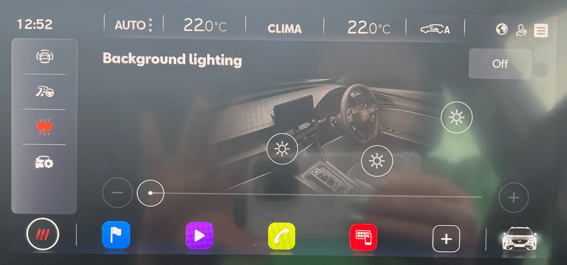

Hey guys,
I just picked up my new Formentor V1 on Tuesday and I can't seem to get the ambient lighting to work? I'm aware that this only works at night anyway but when I go on the settings I'm presented with this screen:
I can't see any options for you changes the colours etc.
Any ideas?

In the v1 you don't get the wrap around lighting if that's what you're looking for? The other (door etc) is extremely hard to see unless it's dark. From memory I think you tap the individual bulb icons to set each area.

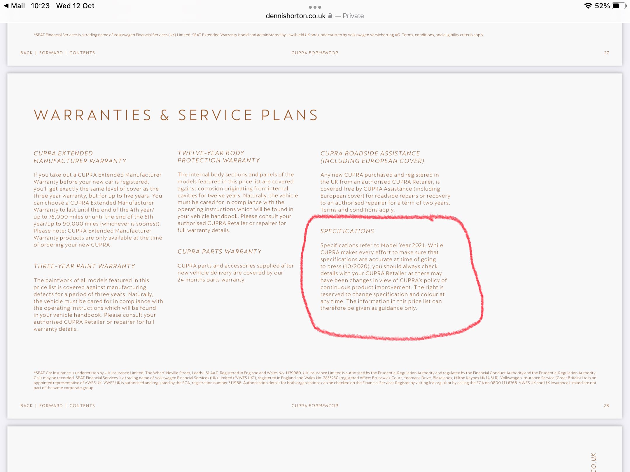

Unfortunately, I don’t think you‘ll get anywhere with your complaint if you were hoping for some form of financial compensation or goodwill gesture from Seat / Cupra or the dealer.
Page 5 of the October 2020 Formentor brochure (the launch brochure?) does mention interior ambient lighting being standard on the V1, and on page 14 it states that interior ambient lighting was standard on all Formentor models, including the V1, but it doesn’t specify whether or not that includes the wraparound lighting, and if so, for which models.
When the brochure was updated in August 2021 (which should have reflected the spec of 2022 model year cars as 2022 model year vehicles could be ordered from July 2021), the V1 was still shown as having interior ambient lighting (page 13). However all other models are shown as having smart wraparound interior lighting. So the V1 got basic ambient lighting (presumably doors and footwells?) but not the dashboard wraparound feature of the other models.
So assuming you ordered a brand new V1 and you ordered it after Jul /Aug 2021, then IMHO the brochure content should have helped clarify how the V1’s ambient lighting differed to the ambient lighting in other Formentor models.
Like pretty much all car manufacturers, Cupra include the statement circled in red on the screenshot below (from the Oct 2020 Formentor brochure) in the event that vehicle spec details on brochures differ to the actual spec of the vehicles they’re building, due to such things as model year spec changes, to minimise the number of queries / complaints from customers over the spec of their cars.

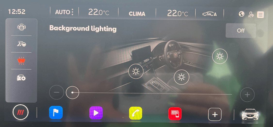

Hey guys,
Any ideas?
Cheers
Hey.
I think I got the same problem. The difference is that I got my Formentor preowned. I bought it from Sweden and on the ad it clearly says "smart wrap-around interior lighting - multi-colored" but my led strip around the dashboard doesn't light up and my "Backgr. lighitng" screen looks exactly like yours. I guess I don't have the ambient lighting strip after all!
Do you have the spec sheet for yours? Does yours say qq9 or qq8 anywhere? Or any QQ with any number ?
Also Do you have the logo projection on the floor when you open the door? I read that the logo projection can only be equipped with the ambient light strip.
Cheers!
