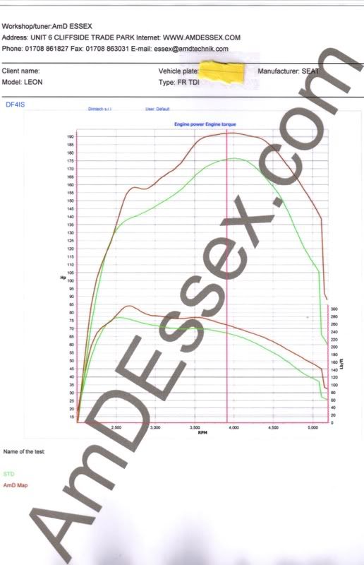

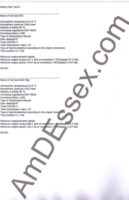

My totally "standard" car was then put on the rolling road to get an idea of the current power and torque. The figure that was achieved after a couple of runs was rather higher than i was expecting!:whistle:
176.5 bhp and 277.1 lb/ft.
As far as i was aware the car was totally standard and i can only assume that the car had been tweeked a little by SEAT or its just an unusually powerful standard car!
Alex
Anyway that aside, the new AmD stage 1 map was added and the car was rolling roaded again with the addition of a new pipercross panel filter as recommended by shaun because the old one was looking a little dirty. And the results i am very happy with!
192.2 bhp and 308.1 lb/ft
Bearing in mind that map should get a bit more powerful once the ecu has fully adapted and that the temperature in the room was 25'C i am very happy!:funk:

I saw your graph on Saturday. Pretty impressive as your car got really high before the map!

Sorry jonjay about the slow reply, i haven't had internet access for a while!
Thanks. yeah i was really pleased with both the before and after results! Do you think it could be possible that the car produced that power as standard? the reason i say it might have been upgraded by seat is because it was a demonstrator for 2000 miles.
anyway, here is the graphs for anyone else who is interested.

VAG diesel always tend to produce more power then stated plus add in the dyno lottery and those figure are very believable to me. Nice to see all the correction values at the bottom of the graph as well so it`s easy to see if any fiddling has been done. Apart from the flat spot between 2700rpm and 2900 rpm it`s a very nice looking graph. 192bhp finish minus 176 bhp start figure gives 16bhp increase for your money. Would be nice to have the car put on another dyno and compare the graphs and numbers.

ps i got that flat spot in mine too from jabba why is that??
i am not sure what causes the flat spot, but i was told by AMD that they would expect it to smooth out a bit once the car had fully adapted to the map.
next time i have an opportunity i will get the car rolling roaded again, hopefully also in slightly cooler conditions, and see if the car has fully adapted.
strugers1, whats your 130 mapped to? also do you have a print out of a graph? would just like to see its shape for comparison.
