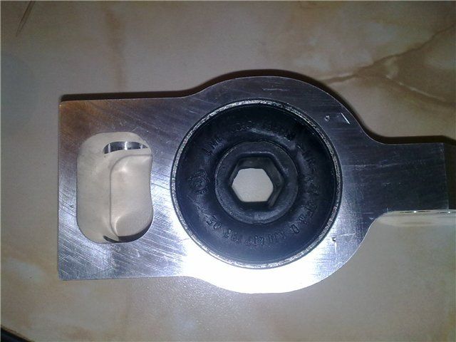

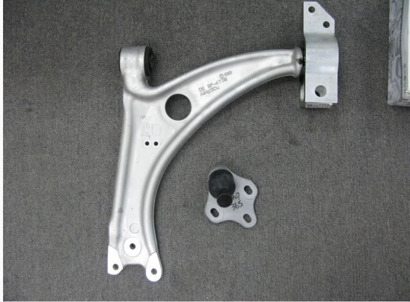

the cupra ones are solid no voids. you should also have alloy wishbones.
like so.
if you have the ones with voids then somebody has been messing. tut tut
Cheers for the info, I'll have a look. What are they like to remove off the wishbones?
Spot on! Cheers dude, probably look at getting them done next month as I'm due a months work of pay rise back payment
Just been out and checked, it's the same as your photos, so all good. Don't know why I thought there were voided, must have got mixed up with another car I've been on at work!
