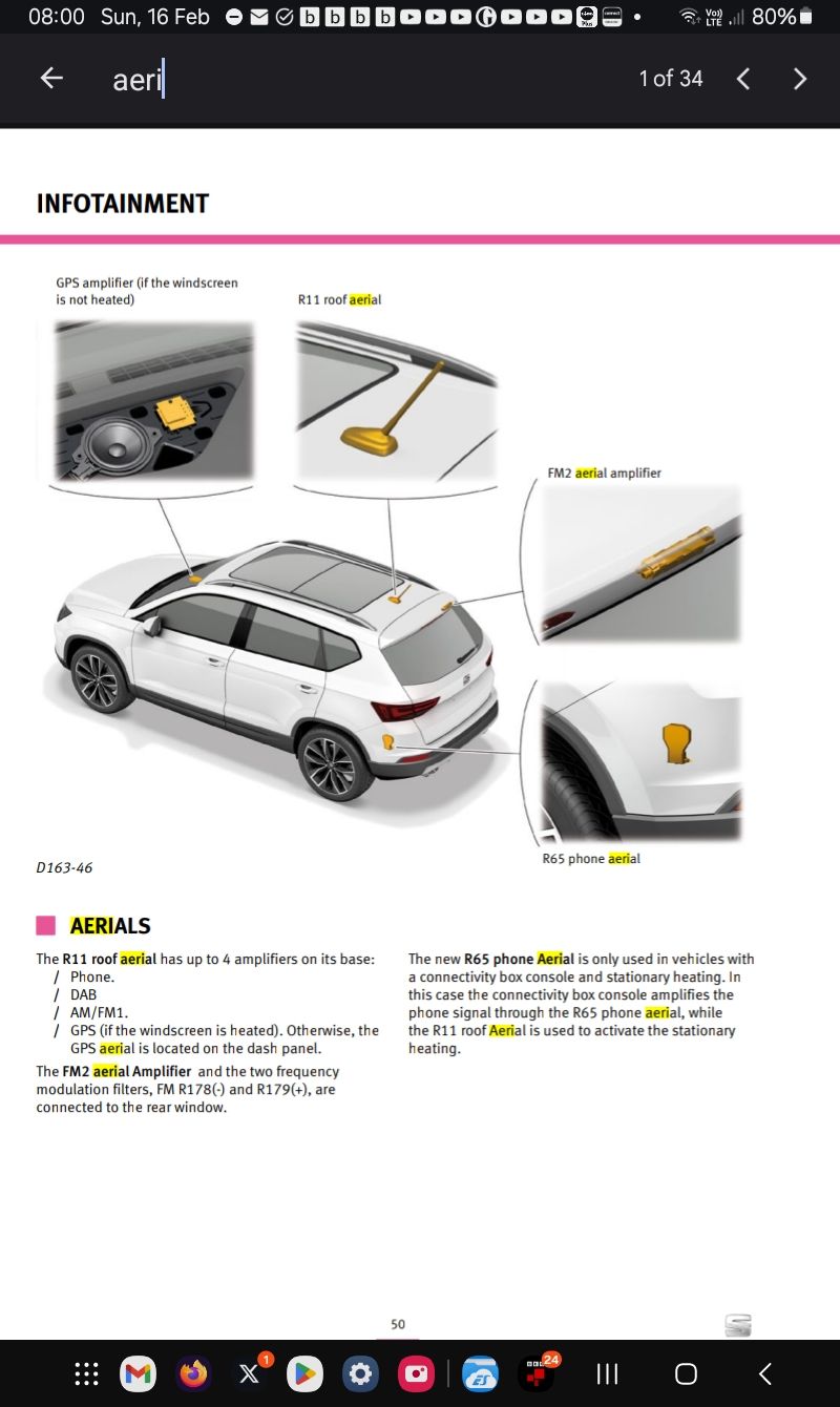

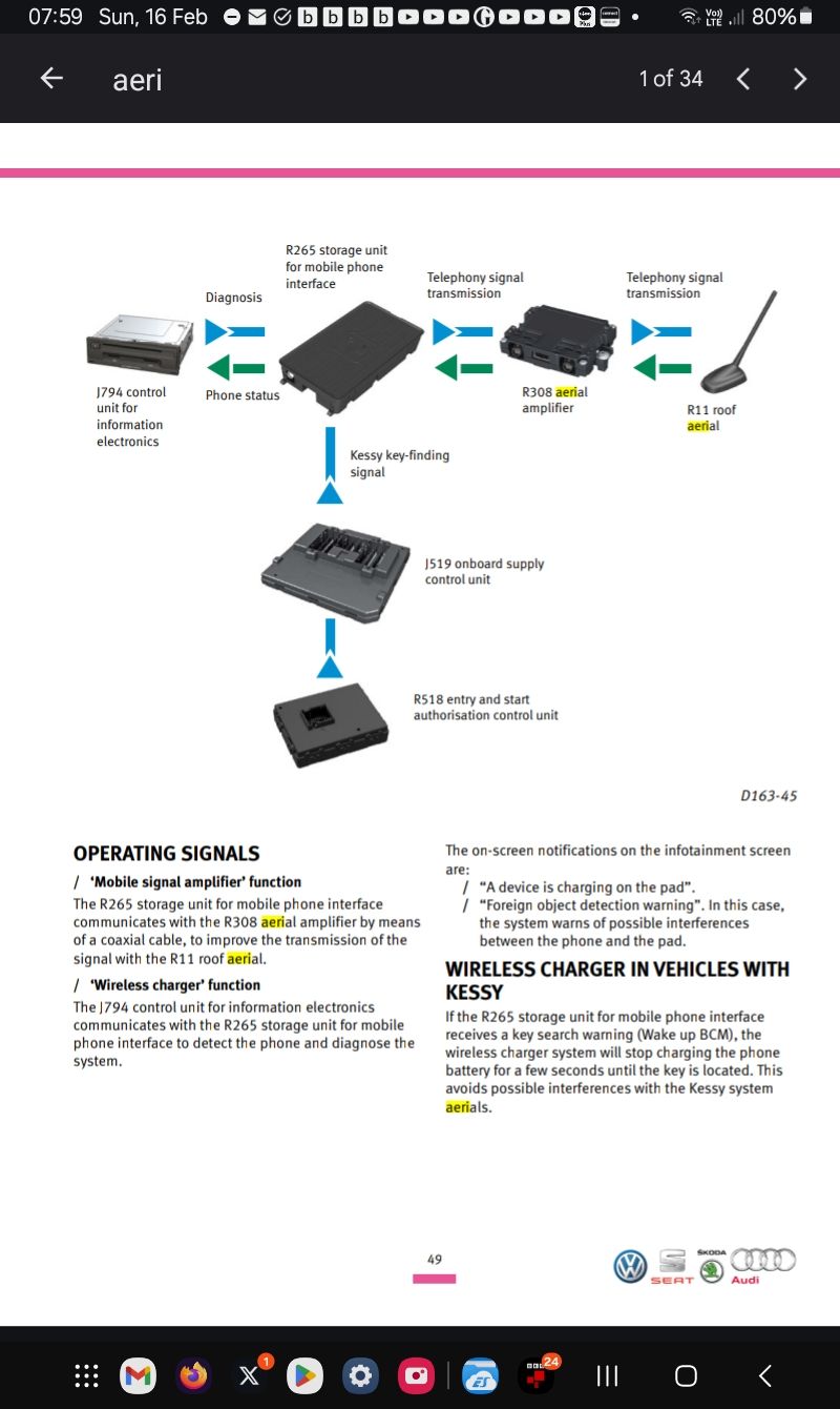

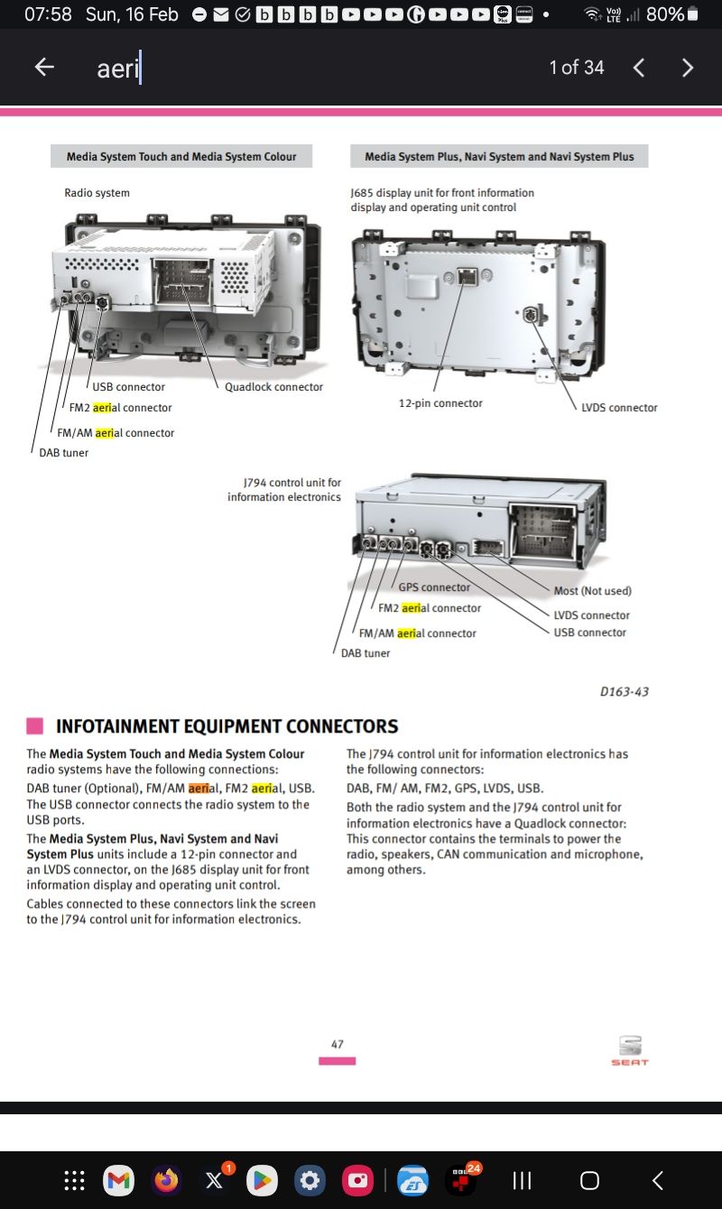

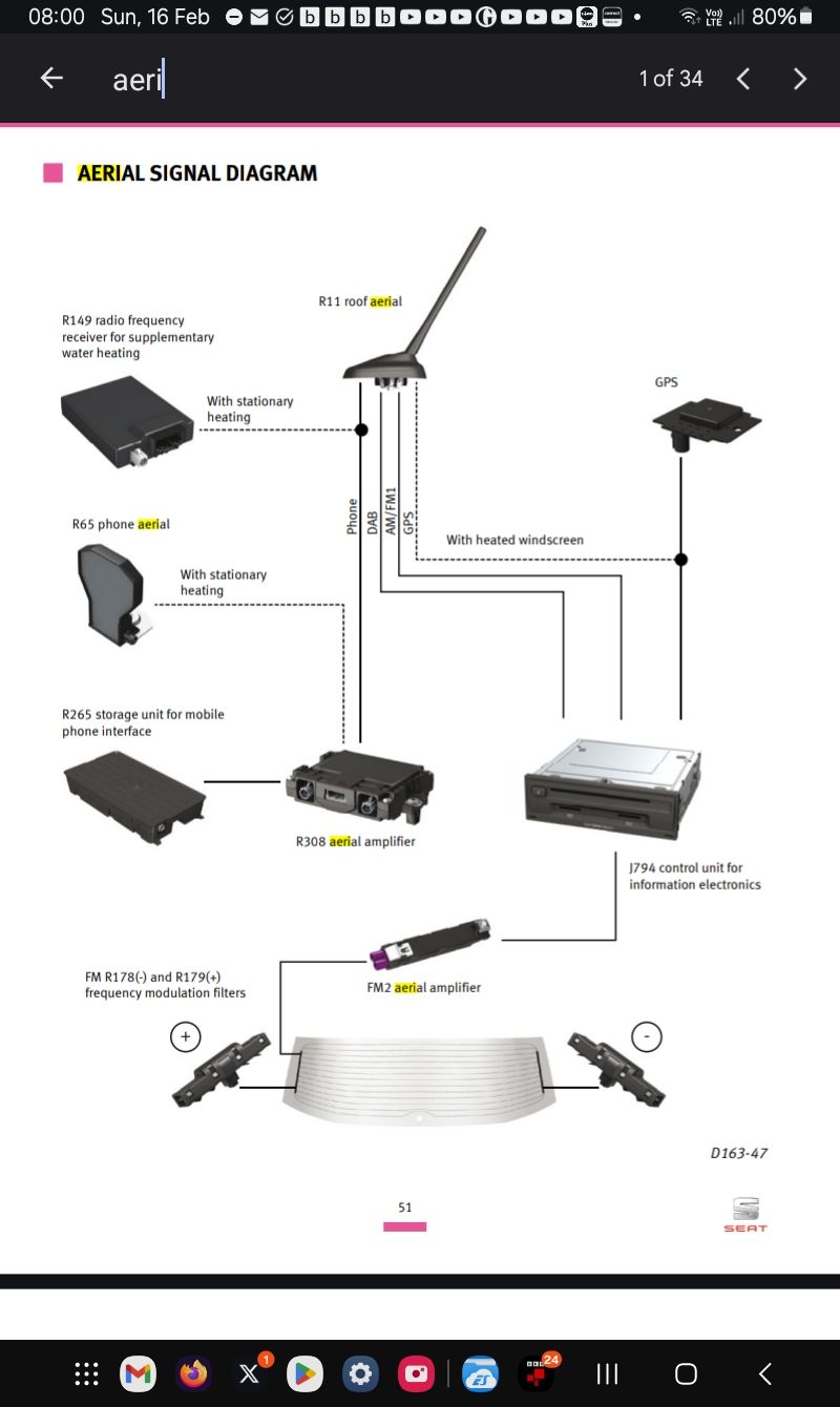

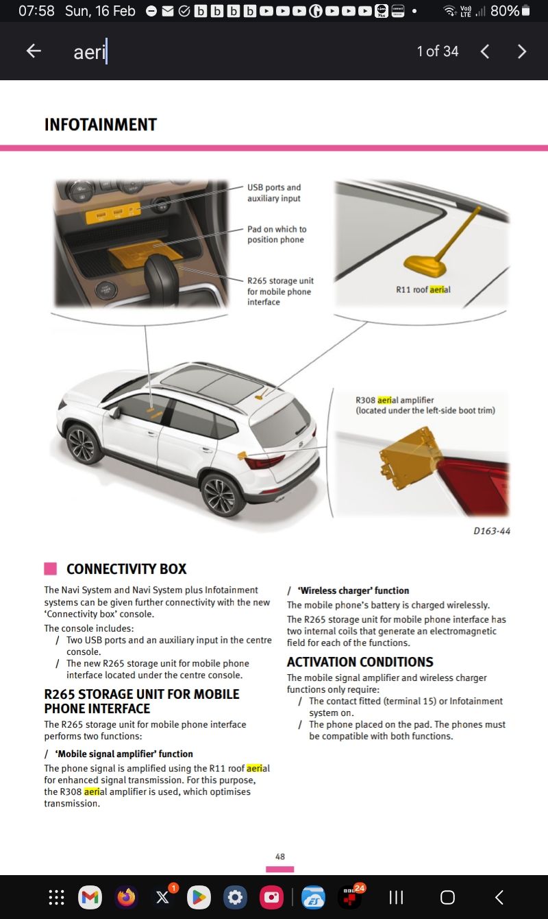

You'll find the satnav aeriel is under the dashboard unless you have a heated (wired) windscreen where it's connected to the base of the roof aeriel (the black bit). As per the Ateca SSP.
The DAB and FM aeriel is in the windscreen. Assorted aeriels in different bits of the car. Likely only the mobile aeriel is on the roof if you haven't got a heated windscreen. The aeriel on the roof can have the other connections but not used. Will post the SSP image.
