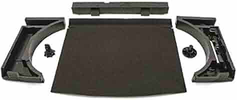

Seat do not make a suitable kit but Skoda do. The part number is: 57A093860C We bought this kit new from a local Skoda dealer for about £150. I've seen it for as much as £230 but don't pay that.
This kit is designed to allow the 4WD Karoq to take a space-saver but the wheel well in the 2WD Ateca gives you the extra depth for a full-sized wheel.
The kit is very comprehensive and includes:
New, larger boot floor.
Three foam inserts to go around the wheel.
Jack.
Wheel brace.
Wheel clamp and nut (which will fit an alloy)
Also included are fixings which you don't need as the fixing studs are not present on the 2WD Ateca.

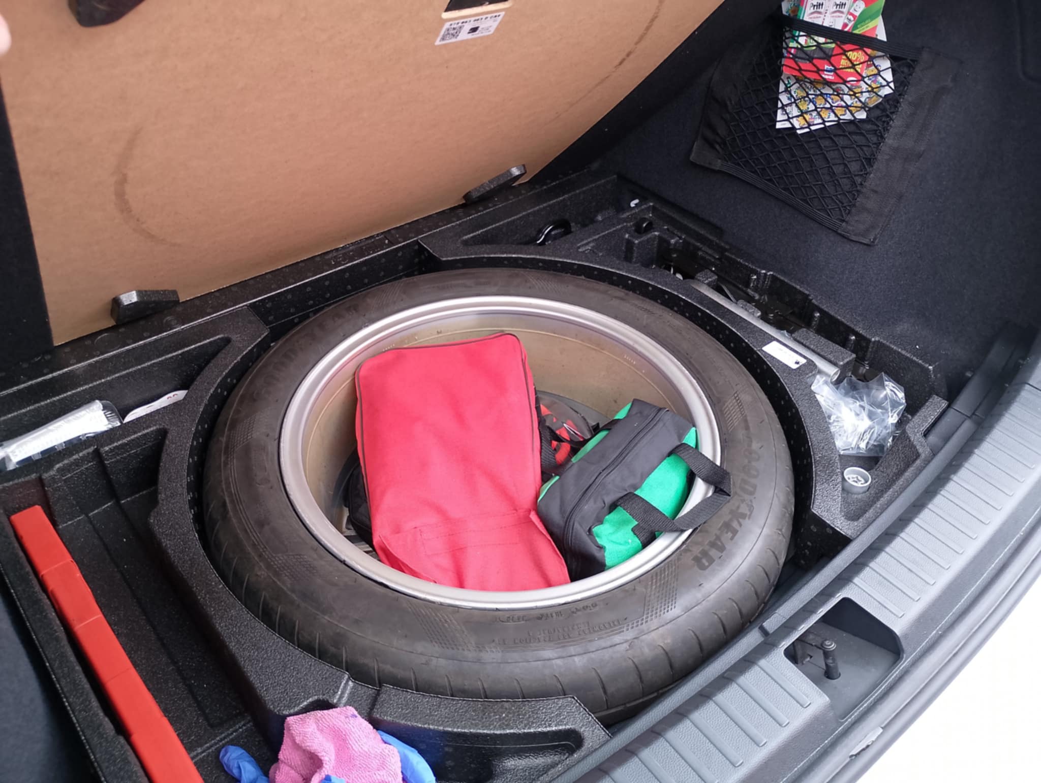

I've just taken a few pictures of my daughter's spare kit. I'll upload them later.
So this is Skoda kit 57A093860C in my daughter's car. It comes with the jack, wheel clamp etc and fits well. It's a snug fit but no modification is required.

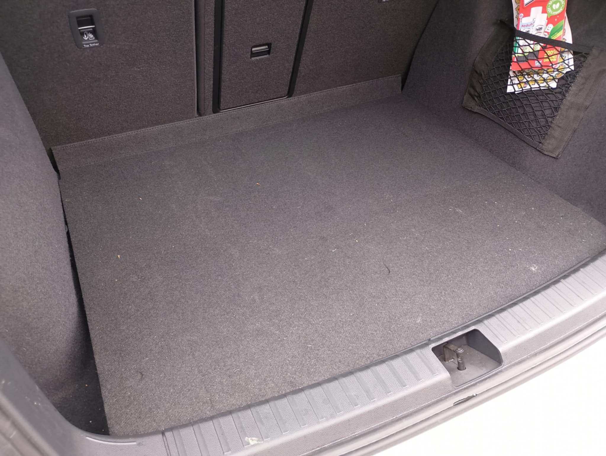

The new floor sits a few inches higher than the stock floor but as you can see, there is good storage space around the spare. As well as the tools my daughter has jump leads, first aid kit, triangle, snow shovel etc and there is still room for more.

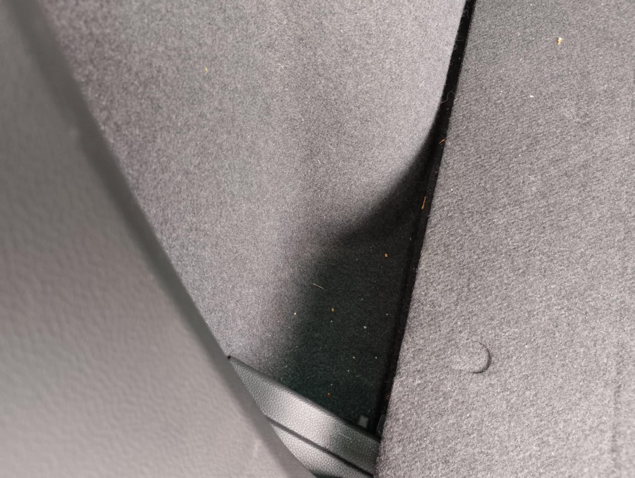

There are gaps at the sides of the raised floor but it's not a problem as the sides of the polystyrene stop items falling under the floor. You've effectively got two little storage bins at the sides. It's a very good mod and good value in my opinion.
I found that on my Cupra (4 drive, so it has the higher floorplan), I had to remove 3 of the 4 triangular "corners" fixed to the underside of the new floor to make it align with the new foam boxes either side of the skinny spare. This drops the floor 1/2 inch and makes it sit evenly on the wheel and foam boxes. Otherwise, the Karoq 4x4 kit is a perfect fit.
