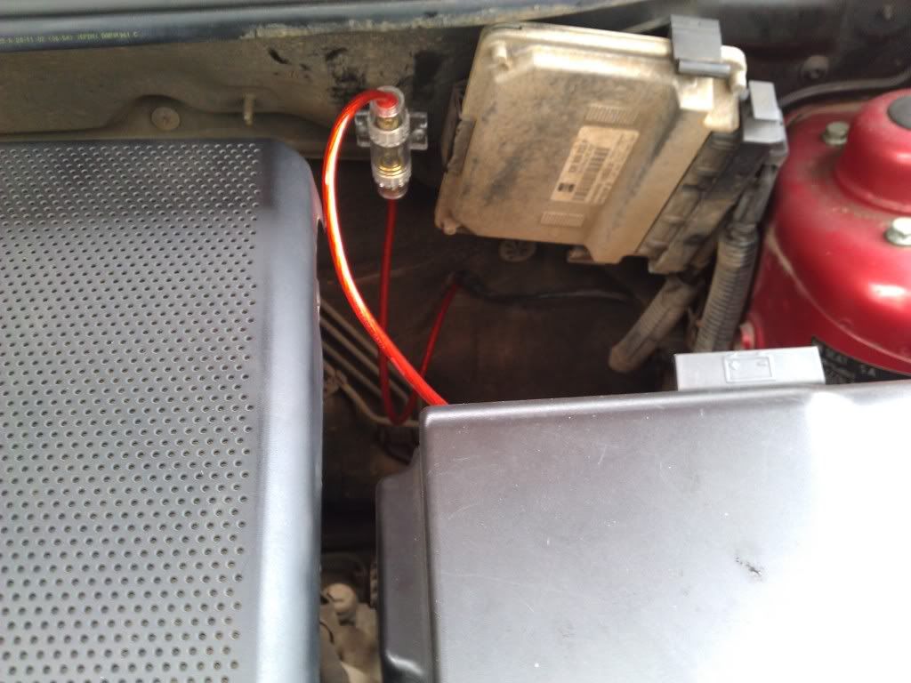

Here's a pic (sorry about the dirty engine bay haha)

i managed to sly mine thru this hole here, even tho on the picture it dusnt actually go thru
then as u can just see here theres anutha hole under the catch tray,
and then if u take this side panel off and shove ur hand in u shud feel the wire,
anddddd the wires will be out of the way in the engine bay because the wire comes straight out the battery and thru the hole
Yeah put it through the two grommets on the pas side of the engine bay. Looks nice and neat too! Just remove the top of the glove box and push the fire proofing to one side and u should feel it pop right through.
