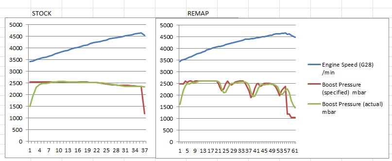

Update, had the map removed :( contacted APR support – no reply, the garage – no idea why its happening, no suggestions from APR. With no support on why this is happening I’ve lost confidence in the product and can only assume it’s the map, so best have it removed and go elsewhere. Thanks for the suggestions guys. Posted the stock / remap boost runs in case its of interest.

Oh wow. Looks like it was the map. Revo also do a 30 day money back trial I think. Might be worth giving them a try. Unless you fancy a trek to r-tech.

Looks as though the boost is getting cut off and trying to recover, probably need to log other things such as fueling/ignition/air flow.

Sent those logs and much more to the garage and they sent them to APR but nothing back, had the map removed inside the 30 days but they haven't made the refund yet! Hope they honour the guarantee. Re-run of boost logs with stock is smooth again with no drops.
